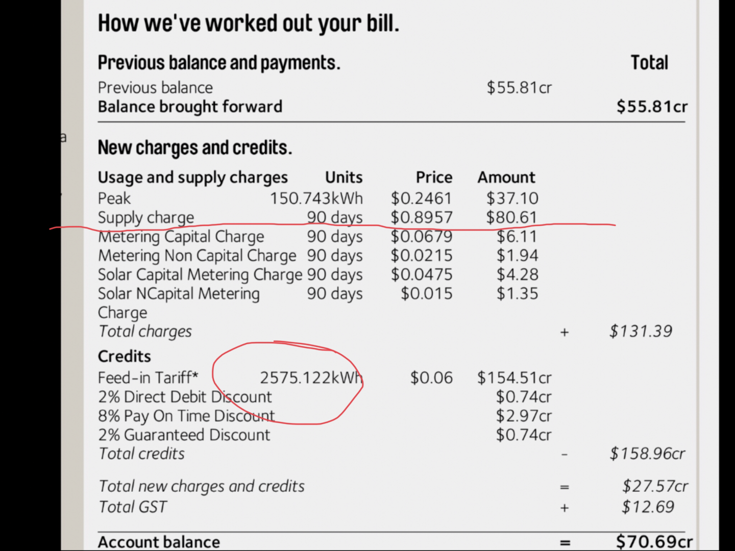

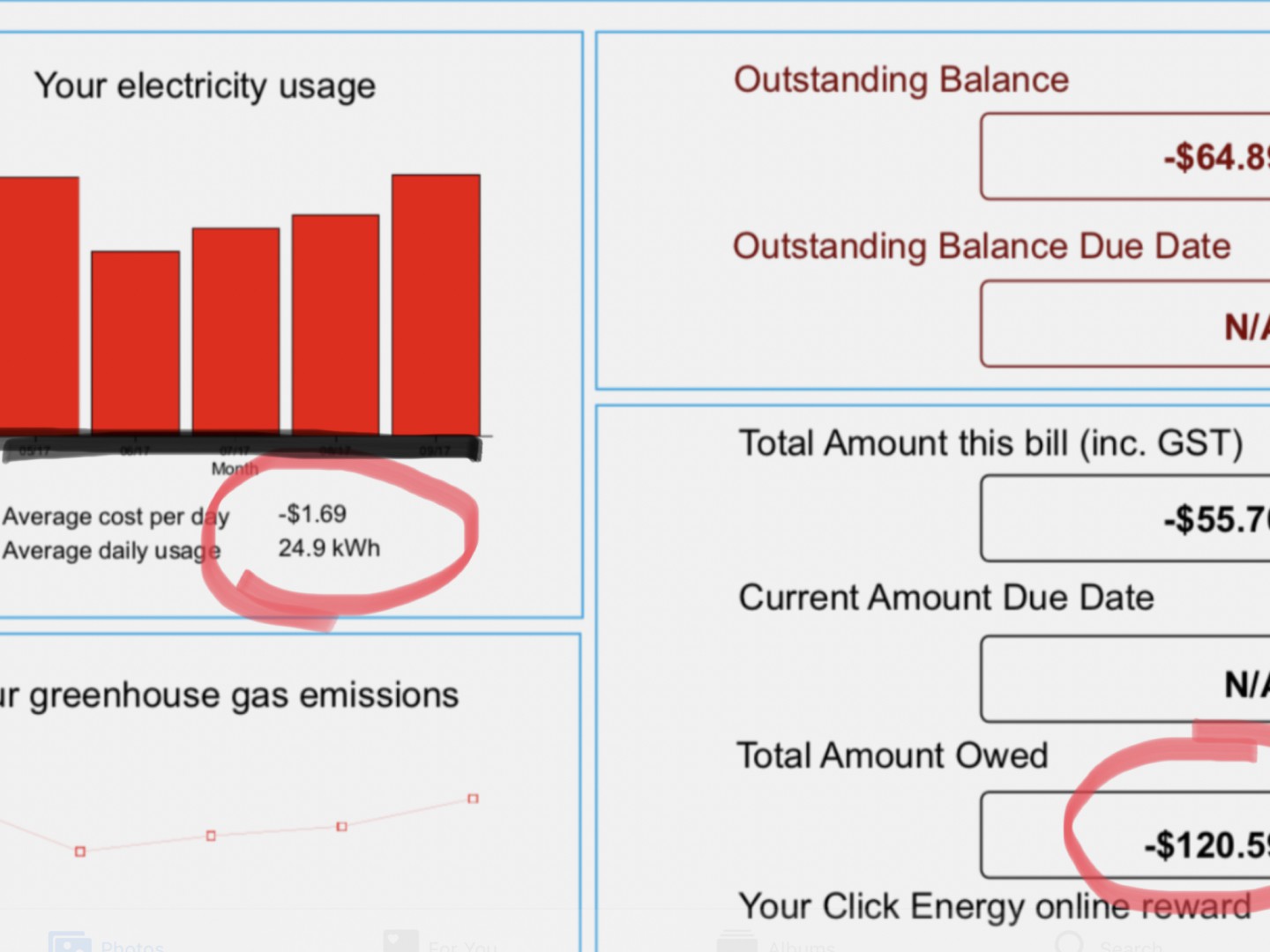

yobarr said
11:39 AM May 17, 2021
bgt wrote:
When folks say they have installed solar and haven't paid a power bill for x amount of time. Are they talking about just the power component of their bill. Or have they disconnected from the net work? 1/3 of our bill is just to be connected.
Hi Bruce.When people are happy to listen to others who know what they're talking about,purchase a quality Solar system,and use installers who know what they're doing,the entire bill can be eliminated.Couple of my bills below. Since installation I have NEVER get an electricity bill,and I have 3 ACs that my Mrs loved to use.Cheers
-- Edited by yobarr on Monday 17th of May 2021 11:56:26 AM
Yobarr no connection fees? Or do credits wipe out the connection fee? Not arguing just trying understand how it all works.
yobarr said
01:20 PM May 17, 2021
Hi Bruce. On the bill below,I have underlined "supply charge",which is the connection fee.The credits wipe out connection fees and night time usage. No bill EVER.I now get 20 cents/kw FIT (Feed in Tariff) so credits would be an EXTRA $360. Done properly, Solar is an absolute no-brainer.Cheers
-- Edited by yobarr on Tuesday 18th of May 2021 03:29:14 AM
bgt said
01:25 PM May 17, 2021
Hi Yobarr. I wasn't aware that the credits would go towards connections fees as well. Thanks
yobarr said
01:30 PM May 17, 2021
Hi Bruce.All credits go towards eliminating the bill,with surplus funds deposited into your bank.After my usage,I get back about $1000/year.Cheers

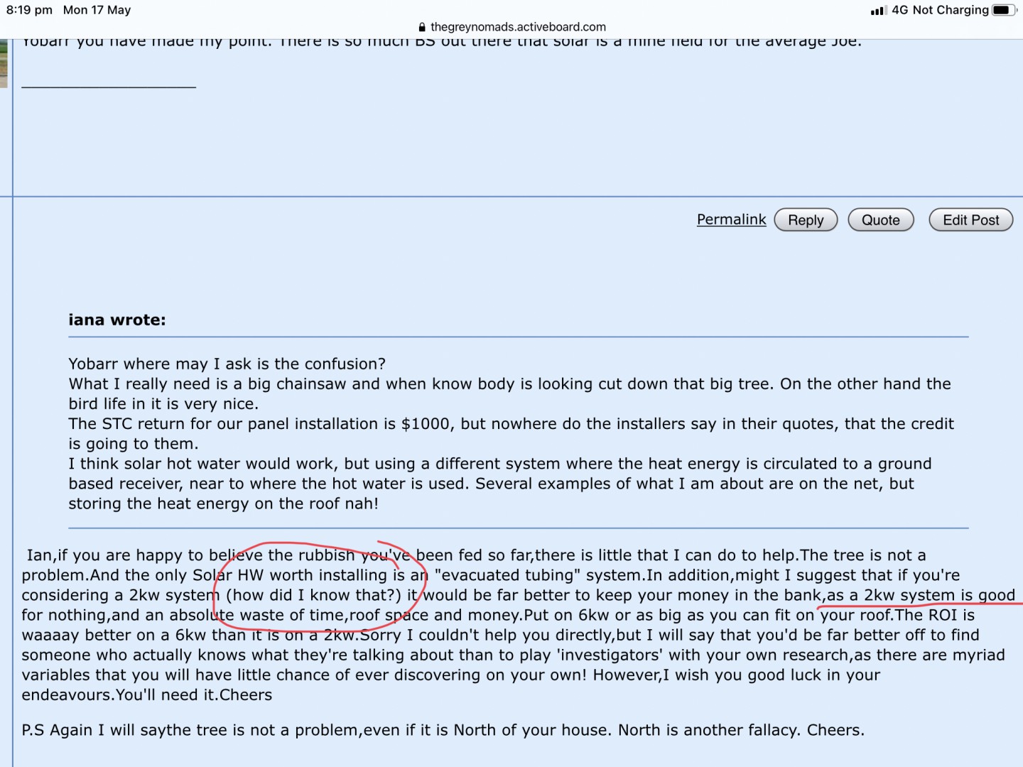

Rob Driver said
08:00 PM May 17, 2021
iana wrote:
Yobarr, if you cannot back up your statements with facts, then its time to make a formal complaint to Cindy. Either put up or shut up!
I have re-read the posts on discussion, firstly it was about whether the solar installers are just having us all on, nothing about whether I wanted help on an installation. However that being said, I was quite happy to receive any advice given. However looking at Yobars statements:- Hi Ian you seem to be well-confused by the information provided to you up to this point. If you are happy to PM me your home address, I will be more than happy to give you all the help you might need. Well I did send him my details, heard nothing back.
Me:- Yobarr where may I ask is the confusion? Yobar:- nothing
Me:- I notice Yobarr that you have not commented on the PDF file I posted, "Energy Policy WA", maybe you didn't see it. Since sending you my address and email, have heard nothing,perhaps you didn't receive it? Yobar:- Ian, sorry, but I am not interested in having to justify my comments. With residential Solar, I do know what I'm talking about, but if you prefer to believe the rubbish you've been fed by people who apparently know little, so be it.
Me:- Maybe it would be helpful, if someone would tell me why it is a waste of time just installing a 2kw system ?
Yobar:- but Ian has been fed so much rubbish that it is proving difficult to help him
Me:- Yobarr would you please quote and explain the misinformation (rubbish) that I have been fed!
Pretty easy to see why I got angry, I was fed no misinformation, I searched and read nothing more. The only mistake I made was saying 37' was the ideal panel angle for Perth, that's not correct its 32'.
In fact I would have appreciated meaningful information, especially why installing a 2kw installation is a waste of money, but as you can read no answers were forth coming.
Hi Ian.Above,I have highlighted what is blatantly untrue.Contrary to your assertions above,I did in fact respond to your PM,stating quite clearly "Ian,if you can have only 2kw,forget it".With Solar,as with weights,I do know what I'm talking about,but when my good advice is openly challenged, quite frankly,I can't be bothered arguing.I have included a couple of posts from earlier in the thread,one where I asked you how you thought that I knew what sized Solar system you were looking at,(How DID I know that? Experience?) and the other saying that I was not interested in having to justify my comments. Always I am happy to help those who are willing to learn,but I quickly lose interest when the facts I post are challenged. However,I wish you only the very best results from your research,but I would like to say that,so far,it seems that you have been speaking with people who know little? Good luck,and please let us know of your decisions.Cheers
-- Edited by yobarr on Tuesday 18th of May 2021 08:37:09 AM
