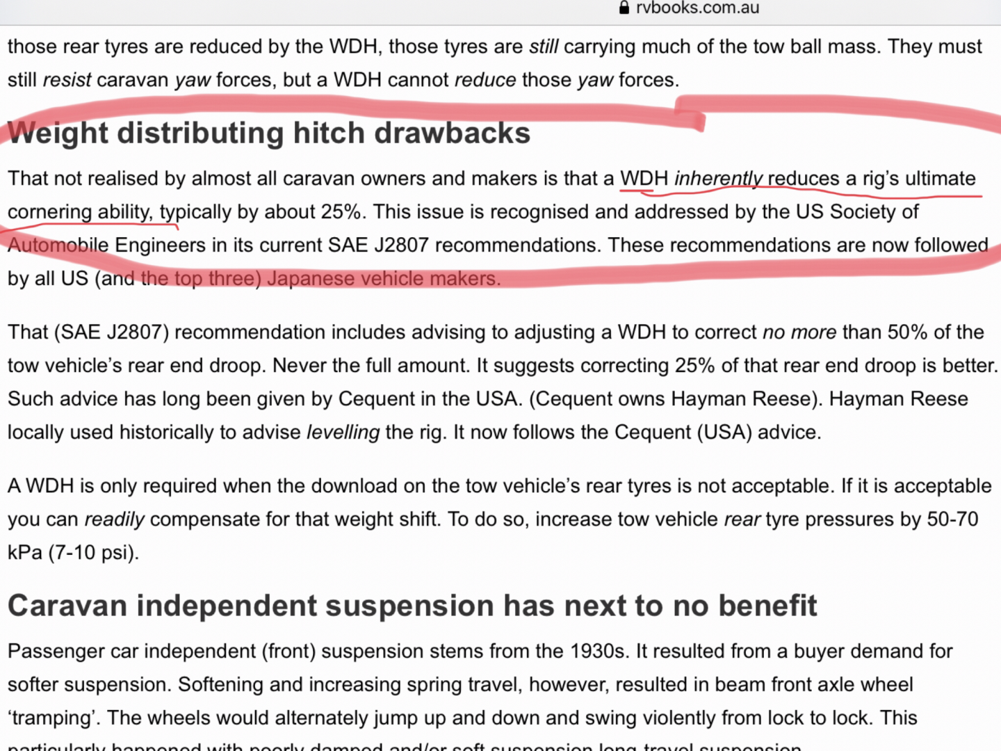

Surely you jest...for months I have patiently explained that when a WDH is tensioned,weight is removed from the car's REAR AXLE and transferred to both the car's front axle,AND the caravan's axle group.The percentages of weight DISTRIBUTION are often 70-75% to the car's front axle,and 25-30% to the van's axle group,dependent on car's wheelbase,TBO,and distance from hitchpoint to the van's rear axis.With my car,because of the long wheelbase and short TBO,the percentages are 66% weight transferred to the front axle,and 34% weight transferred to the van's axle group.Again I will advise that,when a WDH is tensioned,TOWBALL WEIGHT DOES NOT CHANGE. No matter how some may duck and weave,or misinterpret and misquote data,this fact will NEVER change.If you really believe that the towball weight on the Toronado has disappeared,you are unfortunately living in LaLa land.Surely you understand that all transferred weight has been removed from the car's REAR AXLE...NOT the towball? Although I have, several times,posted the details of my own tests,it seems that you have not bothered to either read,or analyse,same.For your benefit,here they are again.I sincerely hope that this helps you to understand,but I am increasingly suspicious of your motives,along with those of another couple of members. Good luck with your learning,although I suspect that you do indeed already know that what I say is 100% correct.Not negotiable.Cheers
P.S Thankyou for using my correct user name...some members seem to have great difficulty in even correctly copying my name onto their post.And these same people try to tell us all about weights? Yeah,right.Cheers

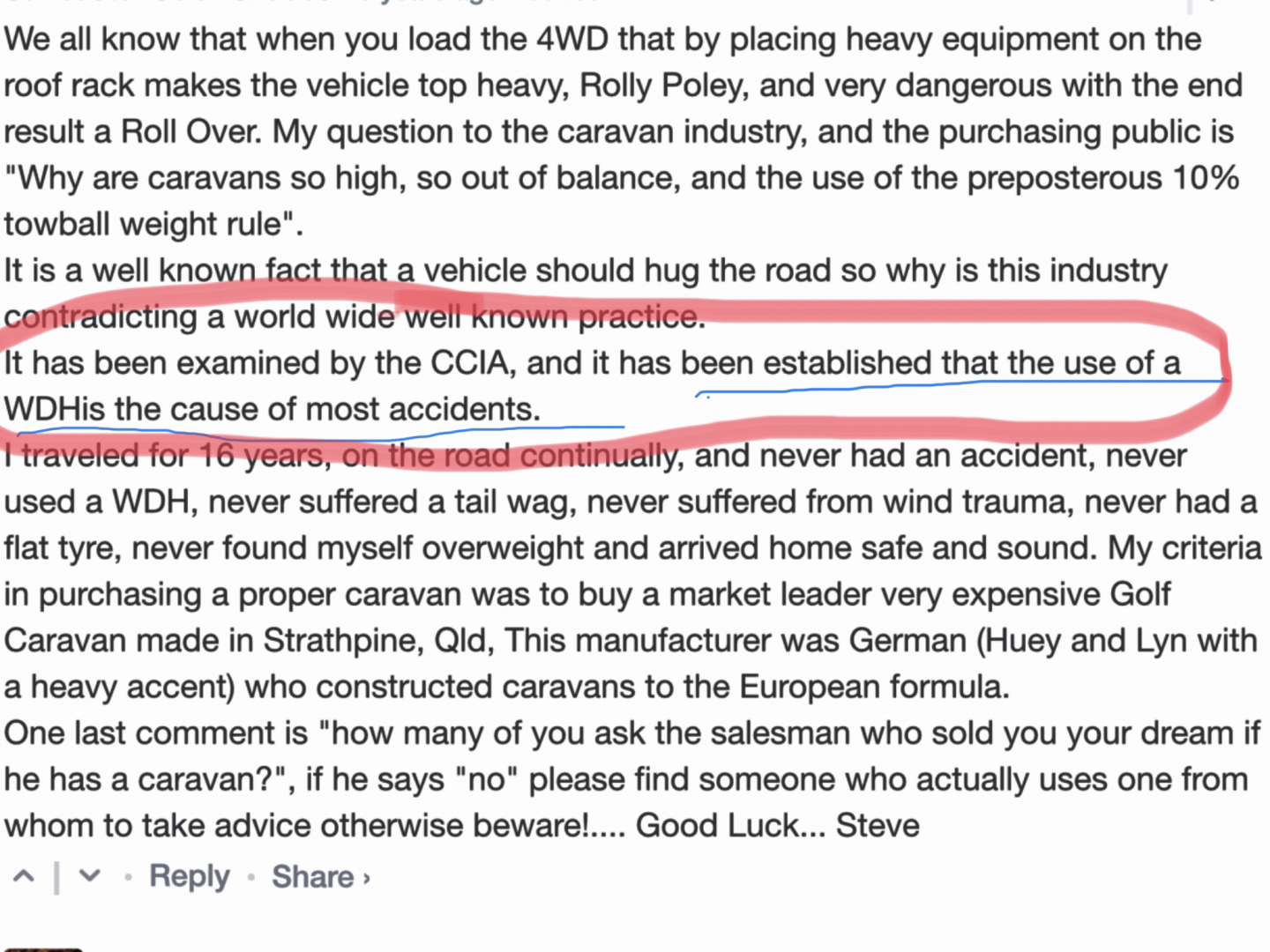

I don't know who writes some of the crap you dig up yobarr but that last article contains some of the most blatant drivel I have ever read. Yes a poorly adjusted WDH can have disastrous consequences and if you are going to tension the thing so far up that the wheels are practically off the ground, I would expect an exit into the scenery. Poorly selected suspension upgrades have have an equally disastrous result. But a properly adjusted WDH most certainly improves stability, steering response and moreover braking distance. You can make a race car be the most evil thing on four wheels too if you don't set it up correctly.
Hi Greg...please note that both my screen shots were from discussions on weights.The CCIA is the Caravan and Camping Industry Association,in Australia,while the other article is written by the US Society of Auto Engineers,with particular reference to SAE J2807,to which Gundog regularly refers when discussing weights etc.Pointless shooting the messenger,surely? If you have strong feelings about these things,perhaps you could contact these people,telling them the error of their ways? From our PMs I soon realised that you know what you're talking about,so I am somewhat puzzled by your stance here.Cheers

Possum3 said
05:05 PM Apr 22, 2021
yobarr wrote:
..please note that both my screen shots were from recognised authorities on weights.The CCIA is the Caravan and Camping Industry Association,in Australia,while the other article is written by the US Society of Auto Engineers,with particular reference to SAE J2807,to which Gundog regularly refers when discussing weights etc.
Yobarr to my knowledge the CCIA is not a recognised authority on weights, it is a Marketing Oganisation representing their members. (who pay to use the RVMAP Badge)
yobarr said
05:16 PM Apr 22, 2021
Possum3 wrote:
Thanks Possum...as stated,these simply were screen shots from stuff that arrived on my computer.Cheers
-- Edited by yobarr on Thursday 22nd of April 2021 05:40:33 PM
Neil,you can relax,as I am not even remotely "mad as hell". Rather,I am sympathetic towards a couple of members who seem to have little understanding of weights,and no apparent interest in learning.It matters little whether you like the teacher provided that the lesson is relevant and correct. But I would like to thank you for your concern. Cheers
