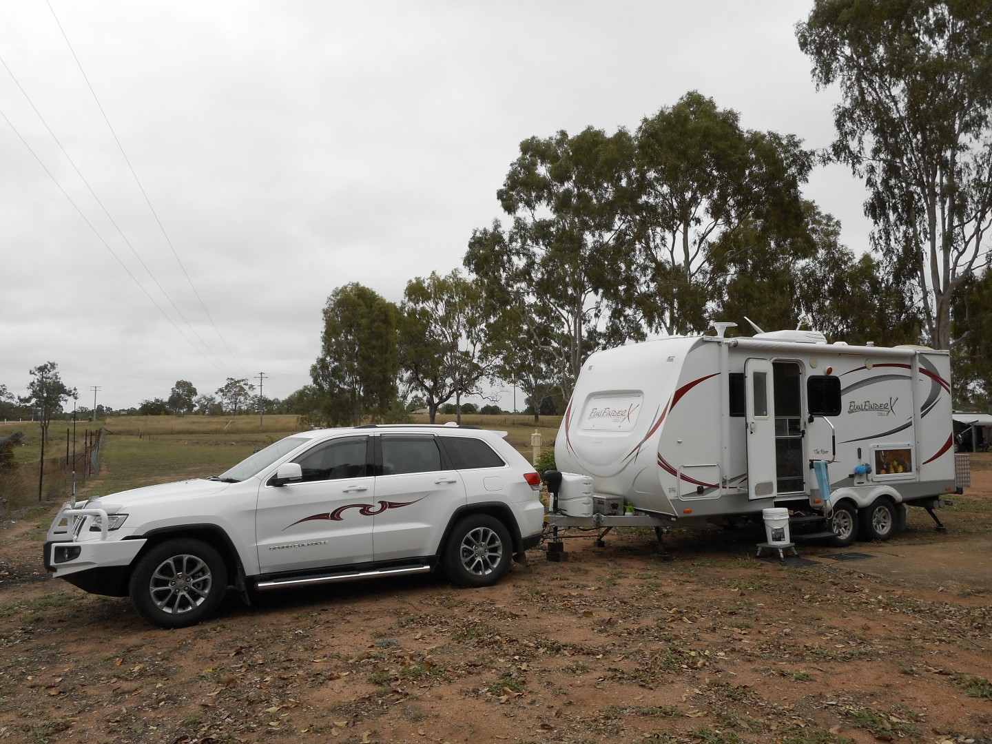

It is a 2014 Jeep Grand Cherokee petrol 6cyl.
vickiparker said
02:27 PM Aug 20, 2018
The car tows perfectly with no sway and is dead level, don't know it is on the back.

vickiparker said
02:51 PM Aug 20, 2018
The ball weight is supposed to be 185 but no way can we even get anywhere near as we weigh actually 345 so spot on with your weight.

yobarr said
02:55 PM Aug 20, 2018
Hi Vicki....All is good.Your tare weight is 2169kg and your GVM (maximum weight on cars wheels) is 2949kg,which means that your car can carry 780kg.....this includes passengers,fuel,towball weight and whatever other stuff you wish to put in/on the car. I refer to towbar,bullbar,lights etc etc.Your cars towing capacity is 2812kg,and your van has ATM (weight on van wheels AND towball or jockey wheel) of only 2300kg. Tare is about 1800kg,so there is room for a load of 500kg in your van as it stands.If you choose to use the generall recognised towball weight of 10%,your towball weight will be 230kg.Somewhere on your cars towbar there will be a load rating stamped,but I would be more than surprised if it was less than 300kg,so 230kg ballweight is no problem. Your car will now have lost 230kg of its 780kg carrying capacity,but you still have 550kg left for fuel,passengers and all the other stuff. You do not have a problem,but if you wanted to carry more in the van you may want to get an ATM upgrade.Your vans axle rating is 2500kg,so you could theoretically increase your ATM to 2750kg.(2500kg weight on axles plus 10% towball weight). As far as I can see....and I am rushing to get to work,so may have missed something?.....there is absolutely NO problem with you hooking your van to your car with 230kg towball,or even more,if you wish. Good luck,but feel free to PM if you wish and I can discuss in detail what your options are.If you still are confused,I am happy to drive to Kingaroy to help you set it up correctly.Cheers.

Vicki, Assuming your 6 cyl petrol GC is a 4x4 and not a 4x2, then yobarr is pretty well on the money. The 4x2 has a drastically lower tow rating, so hopefully you're in a 4x4 model.....

vickiparker said
03:35 PM Aug 20, 2018
yes it is a 4 x 4
vickiparker said
03:37 PM Aug 20, 2018
The ball is a 75 and not a 50 so I don't if that makes any difference
yobarr said
05:19 PM Aug 20, 2018
No problem Vicki,but absolute overkill.Those balls are rated to 10 ton,and are used often with a 5th wheeler,or a goose-neck semi-trailer type van. Perhaps your car has a dark past? Anyway,good luck with your project,but I think that many would agree that you have been worrying needlessly! Enjoy Tasmania.... Cheers.

Good point Tony....The petrol model is beyond useless,at 1600kg towing capacity,but with a 2300kg van,I just assumed that they had bought a Diesel! If not,they would have been a long way up s..t creek without a paddle. Cheers

vickiparker said
07:52 AM Aug 21, 2018
We seem to be right now as you can see we are pretty level when hooked up and have now problem towing not even up hills.
