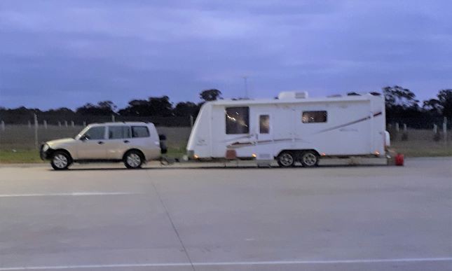

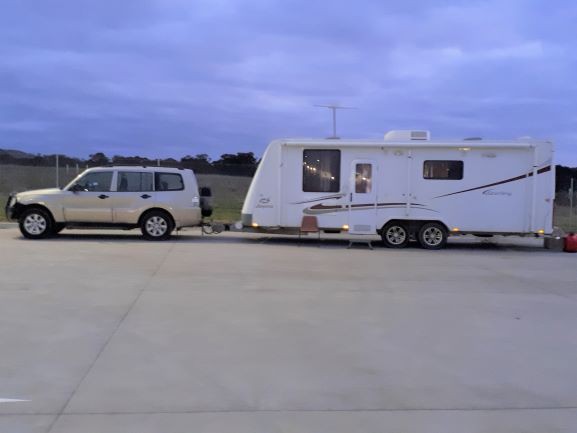

Hi interested parties, continuing with the weights situation for our few days away near Bendigo this last week. With full water tanks and re arranging loading we achieved the Pajero max ball weight of 180kg. The van ATM was still over BUT will have that upgraded to the group axle rating next month.
I decided not use to use the WDH and this put the tow ball a couple of inches closer to the Pajero rear axle. I was quite happy with the way the outfit travelled at our usual speed of 90/95 km/hour. We used most of the front tank water and she did not travel as well heading to the dump point at Newstead. I measured the tow ball weight and it was 160kg. I emptied the rear tank while emptying the cassette and this left the front tank at ¼ full. The tow ball weigh was now around 195kg and she travelled better than at the 160kg. I am wondering if that amount of ball weight change would be noticeable or is it me?
Ball weight of 160kg = approx. 5.517 %
Ball weight of 180kg = approx. 6.207 %
Ball weight of 195kg = approx. 6.724 %
Compliance plate of 142kg ball and van empty 2252kg is 6.305 %
The attached pics showing side view without WDH.
Genset not on rear bumper.

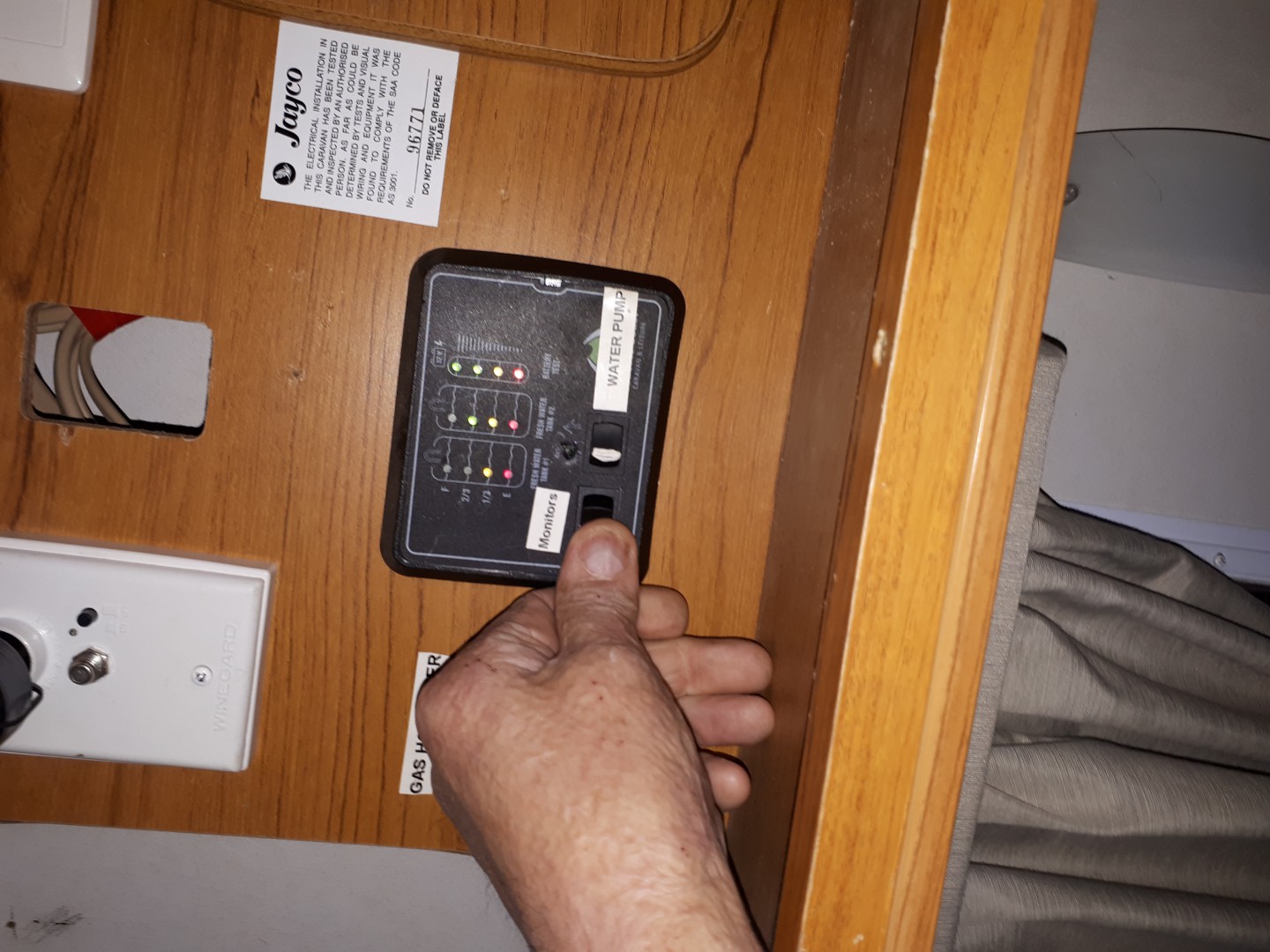

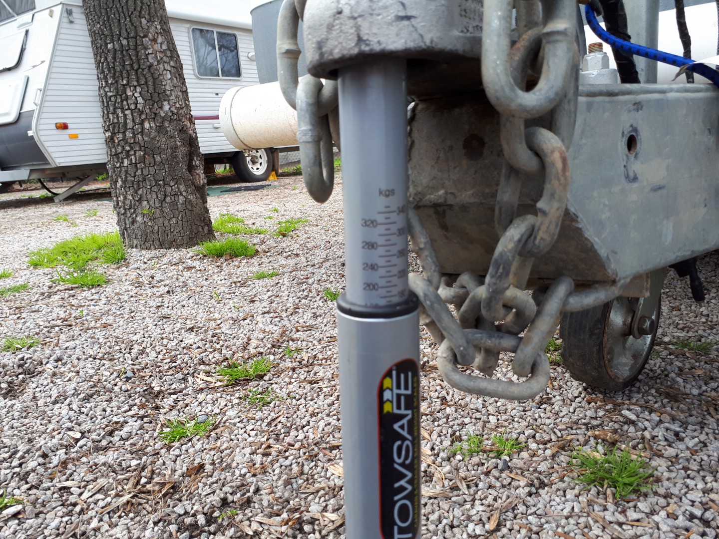

Left home loaded for 3 weeks travelling without 30kg of HR hanging off tow bar, I had it in Pajero "in case". Ball weight 185kg and water levels to achieve that. Tyre pressures all double checked. Being a bit nervous, after several trips where I did not feel comfortable with rig, I was taking things steady and began enjoying driving the rig again.
Purpose of trip is to visit Eril's sister and hubby in Adelaide, sort van ATM and have a look at the Yorke Peninsular. Came to Adelaide from Murray bridge via the more northern route. Quite a few hills, twists etc so good test for rig and me. I quite enjoyed the twists and turns as well as the more scenic drive and got to see the "big rocking horse" and take pics for the Grandies. Arrived at the mechanics, recommended by someone on this forum, and went through the inspection and paperwork process for me to produce to Vicroads when we get home. He had some wonderful and not so wonderful stories of people and their overweight and illegal rig set ups.
Settled in to Adelaide CP for a few days for the family stuff.

AP I am using the same towball scales as you and I was also concerned about the ball weight being a bit too light - when I checked the fully loaded van which was 2750kg it had a ball weight of 220kg (empty tanks). I travelled from Newcastle to Urunga then Hastings Point in the Tweed 2 weeks ago without filling the tanks and to me the rig seemed to be pretty stable except for a bit of movement when following large semis. This week for the return leg Hastings Point/Scotts Head/Newcastle I decided to fill the 2 x 95ltr water tanks which added an extra 40kg to the ball weight (260kg) the difference surprised me it was a pleasure to tow with the extra weight on the ball, my wife as passenger even commented that she could also notice the difference. On the M1 I set the adaptive cruise control on 100kph and the Jeep sat on that speed all day up and down hills averaging 16.1 ltrs/100kms, the only time that I needed to cancel it was when I came up behind slower vehicles, down steep descents or speed limit changes like roadworks. A few times I was overtaken by dual cab utes towing similar sized vans but as soon as we hit the longer climbs their speed would drop off and I would go around them easily just staying in cruise, a few kms down the road sure enough they would fly past me again. I wouldn't try using cruise on secondary roads, in winds or in wet conditions but out on the motorway in good weather and light traffic it was great and it didn't seem to have that much impact on the fuel consumption.
BB
