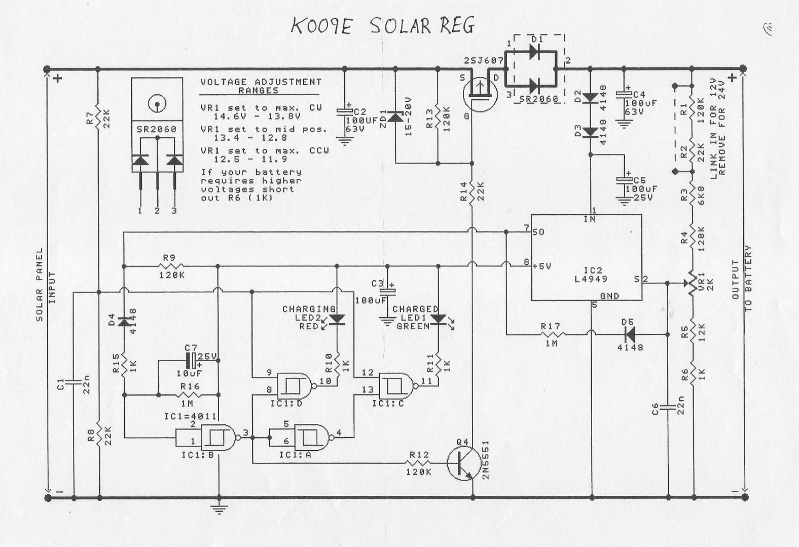

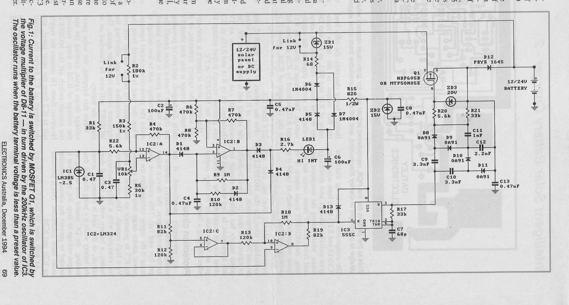

DeBe said
01:39 PM Dec 5, 2017
This is the circuits of 2 PWM solar regulators I built as kits from Oatley electronics back in the 90s. They are still working & doing the job after all this time. I don't think Oatley Electronics are in business any more.
there is no width modification???
edit - hung around too long with question, please ignore
nothing to see here folks, move alonn
-- Edited by Bagmaker on Tuesday 5th of December 2017 02:51:41 PM
