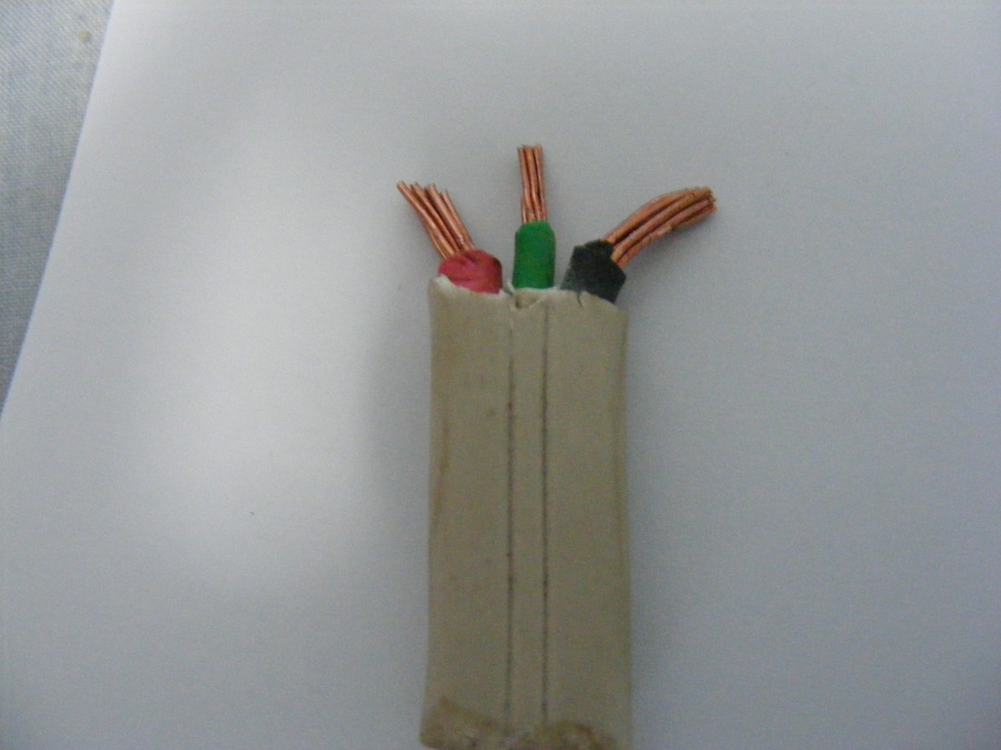

oldtrack123 said
11:29 PM Sep 17, 2016
Dick0 wrote:
In my post I stated I use "stranded" cable. Had a family room extension wired up by sparky to cater for 8 power points, the cable used was the one in the photo...does not look like an extension cable to me but permanent and is flexible to withstand some movement as in a caravan. I use similar type cable for my odd jobs.
YES , THat is NOT extension lead or classed as flexible cable
Standards approved multi core [twin & earth , plastic sheathed [TPS] for permanent wiring ,under cover or protected from the elements.
Shall NOT BE USED AS A FLEXIBLE CABLE!!
This is FLEXIBLE CABLE "'Flex Cable 2C+E 2.5mm2 50/0.25mm PVC Flex 250/440v O/Duty Grey "
good old "O/Duty " {ordinary duty },not even heavy duty ,GREY flexible cable, for such as EXTENSION leads & leads on appliances /devices etc
-- Edited by oldtrack123 on Saturday 17th of September 2016 11:42:16 PM
