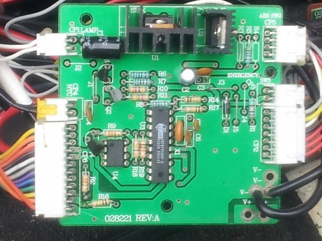

The Main PCB has a switch connector (CP5) identified as Active Battery Security (ABS SW2). After examining the circuit, it appears that there are two possible functions for this switch, and these functions are selected by jumpers J1 - J5.
In fact, contrary to the manual, SW2 on the subject board behaves as an RPM selector, not as an ABS selector. That is, the slider switch selects LOW, MEDIUM, or HIGH compressor RPM when normal mode is active (not Turbo).
The ABS setting is fixed -- the compressor's P terminal (Battery Voltage Limits) is linked to its C terminal (Common).

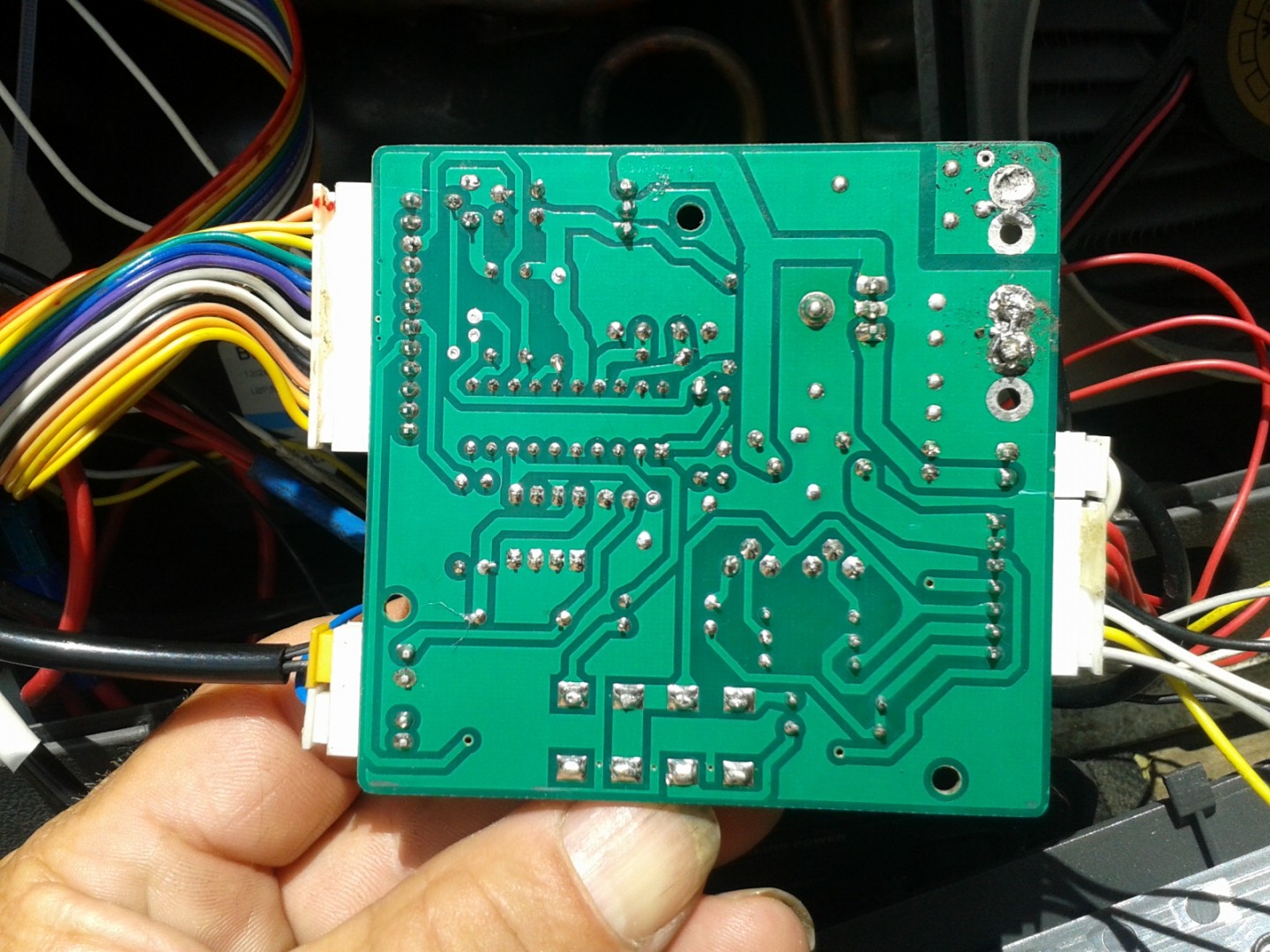

The new PCB is not directly compatible with the original one. The new board has jumpers J2 and J4 while the old board has jumpers J1, J3, and J5. This means that the battery voltage slider switch behaves as an RPM selector on your original PCB, but functions as an ABS switch on your new PCB (as per the manual).
I'm a bit confused, there is no 'J' jumpers that I can see on the new board..(?) The 'ABS' SW2/CP5 is now incorporated on the new board. Allvolts said to slide it to the left, but was not sure if he meant my left or the other left (whether switch is at top of board or bottom, as the photo we were referring to at the time was rotated 90- switch at side)...
I've attached both boards for easy reference, but further update... I've gone full circle and back to the original issue...

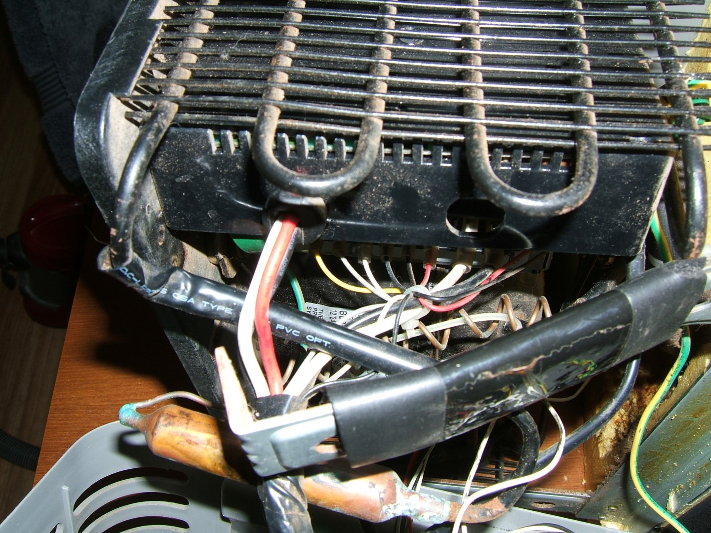

I have two identical wire pairs with yellow connector blocks which I expect are to/from the thermostat CP4/NTC (resistance between these is I think ~16.6 on I think the 20K setting ). This morning I had full functioning switch buttons and LED's, but no compressor action, but when I swapped these thermostat wires it fired up immediately.... on mains/24v and runs fine, (got down to 0/10 on 4 led setting, and cuts out/in- responds to further Temp setting) but on 12V still the compressor tries to kick in but fails even with hardwired to battery/80W panel with upwards of 12.6V(a bit cloudy), which drops to just under 11V under start load- fan runs but retries startup after ~75 seconds (timed), and I have error #1
Edited 11.08 7/12/14 Just to save any confusion;
NEW PCB (LEFT) OLD PCB (RIGHT)
-- Edited by duTch on Sunday 7th of December 2014 12:09:56 PM

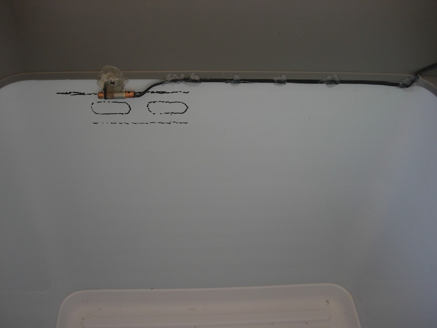

One Thermostat wire initially read 11.3? (on 20K) then nothing, but is the pair that consistently allows compressor to start, the other gave 12.02 (on 20K) then nothing and consistently will NOT allow compressor to start...

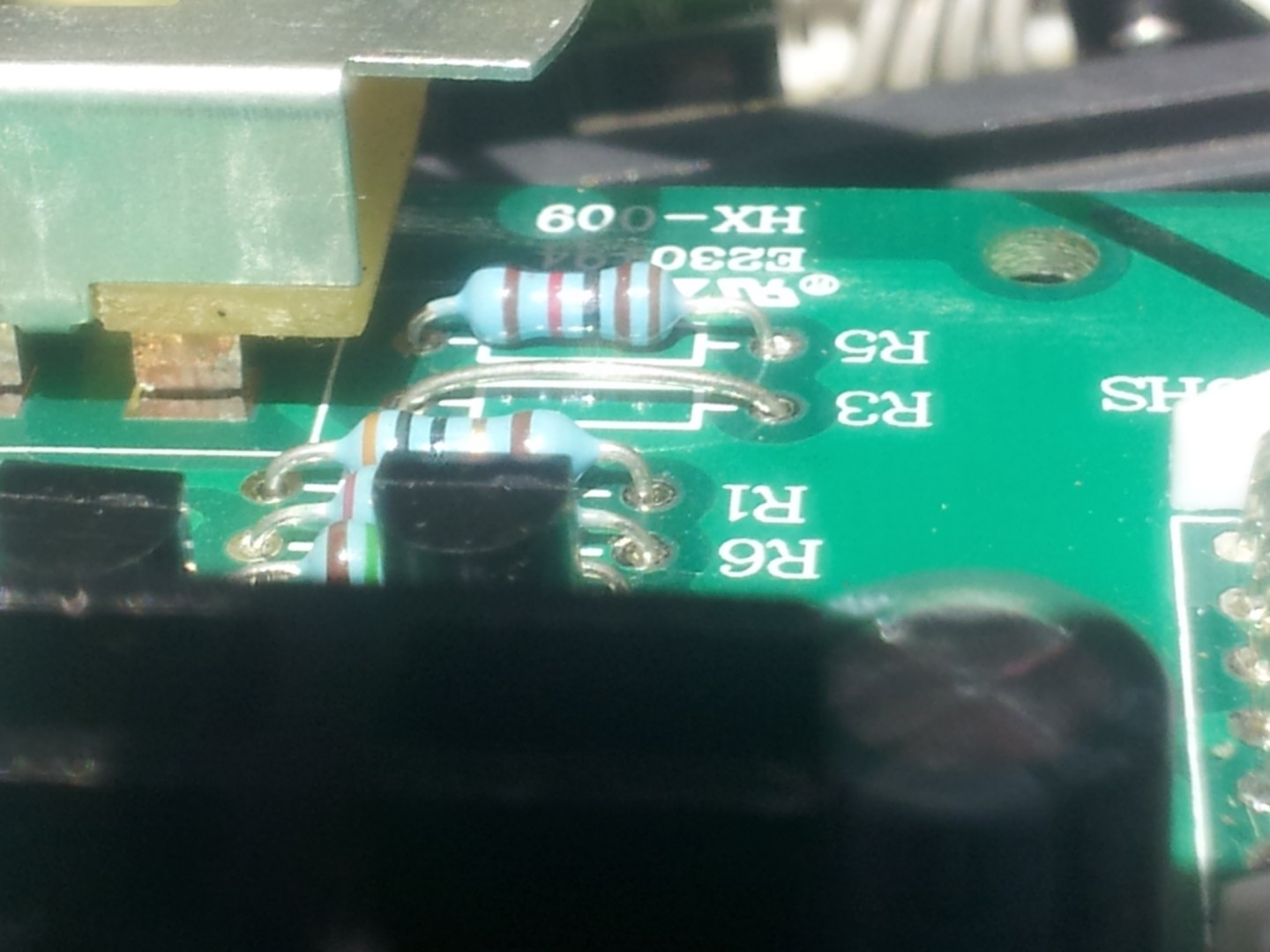

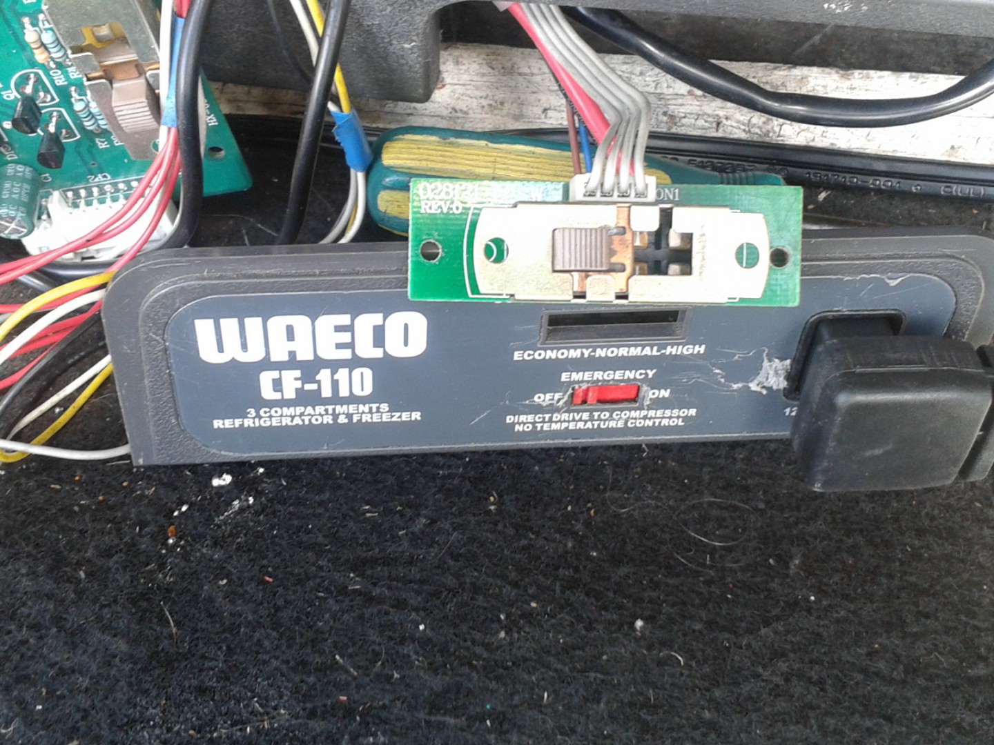

Definitely SW1 onboard switch, the original remote switch is by appearances identical, and nowhere to connect to..
When running, it doesn't seem to matter which position

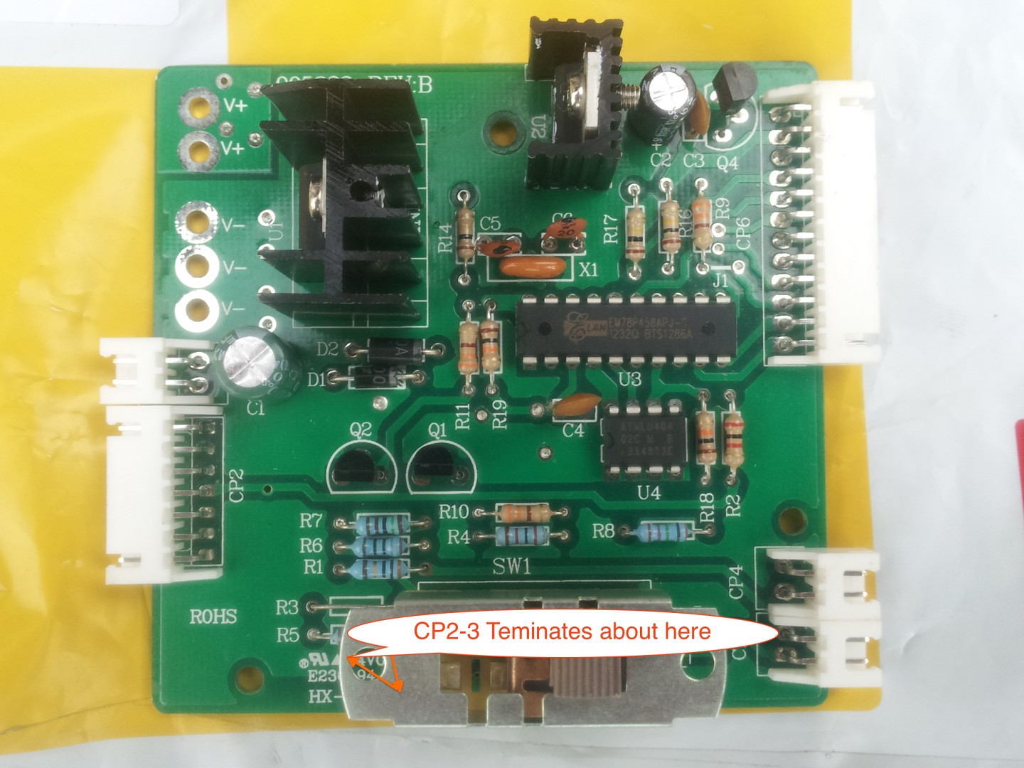

SW1 on your new board is configured as a battery voltage limit selector. The LOW, MED, and HIGH settings connect resistors R3, R5, and R4 between the compressor's P and C terminals. LOW is selected when the slider is closest to CP2, and HIGH is selected when the slider is nearest to CP3. In the LOW position the resistance is zero (R3 is a wire link).
The pinout of connector CP2 appears to be ...
CP2-1,2 <-- red -----> V+
CP2-3 <---- red -----> ???
CP2-4 <---- black ---> Compressor-D (error lamp output)
CP2-5 <---- white ---> Compressor-C (common)
CP2-6 <---- yellow --> Compressor-T (RPM select)
CP2-7 <---- grey ----> Compressor-P (battery voltage limits)
CP2-3 is a puzzle. I can't see where it goes, and I can't even guess at what it might be. Do you have any idea?
Some of the interconnections on the PCBs are obscured, so there could be errors in my drawings or interpretations (I've had to guess at a few).
Do the wire colours at the PCB end match the colours at the compressor end?

It should run on 12vdc or 24vdc. When on 12v check the voltage on the top 2 conectors ont -
If all else fails then this is how it was done with a fixed battery dropout voltage & a 2 speed compressor selection. Used the 10V reg to feed power to the electronic thermostat (this is used if its likely to be run on 24V.)

"CP2-3 is a puzzle." Yes I agree, it goes nowhere neither on the new board, nor on the old board...
"SW1 on your new board is configured as a battery voltage limit selector. The LOW, MED, and HIGH settings connect resistors R3, R5, and R4 between the compressor's P and C terminals. LOW is selected when the slider is closest to CP2, and HIGH is selected when the slider is nearest to CP3. In the LOW position the resistance is zero (R3 is a wire link).'

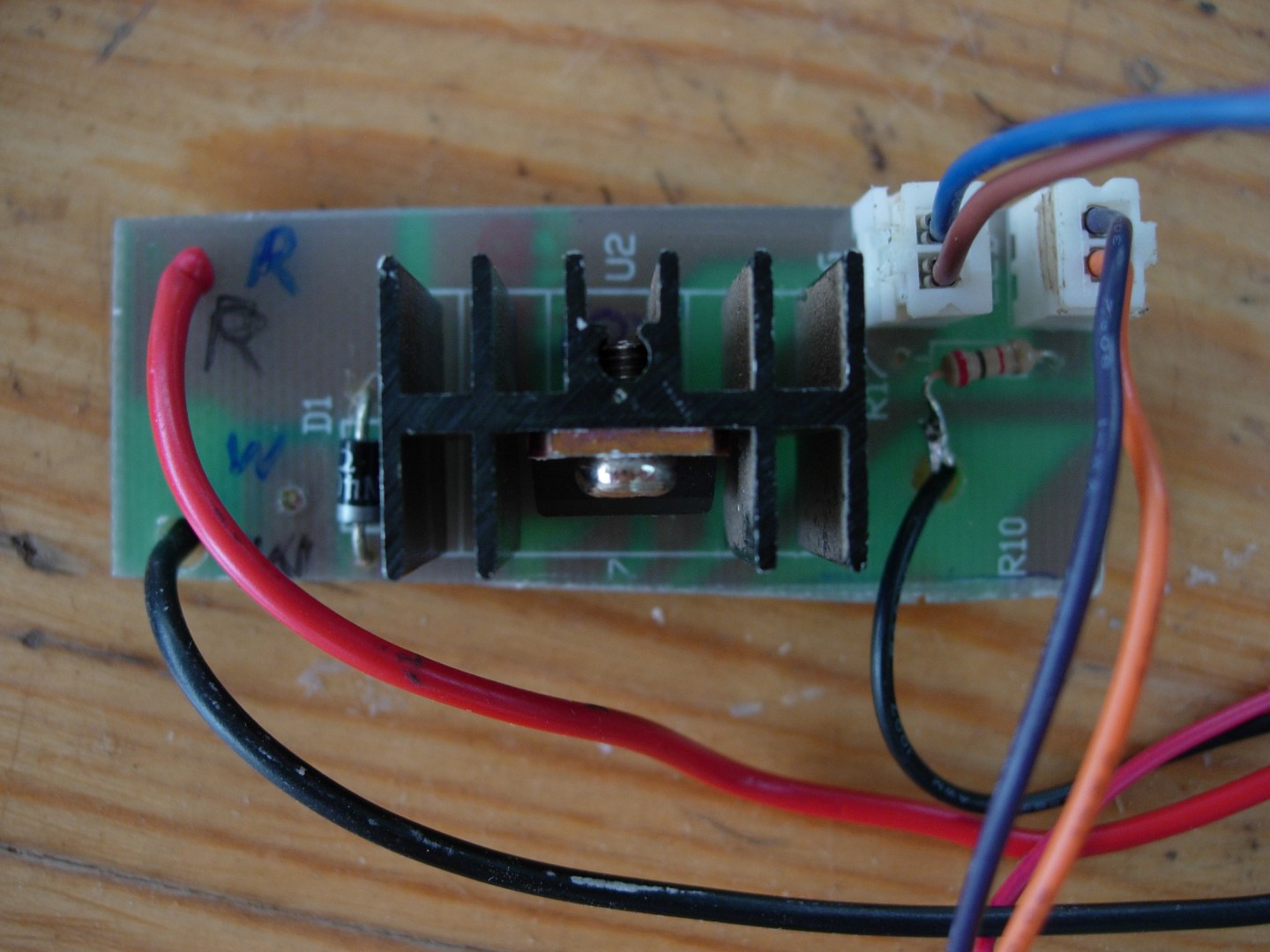

ISTM that the design of the 5V and 10V regulators on the main PCB is problematic. AFAICT, the input to the 7805 and 7810 can go as high as 29V, which means that even at low load currents the regulators would be dissipating significant wattage. Perhaps this could explain the failure of the 7805 on the original PCB and the consequential failure of all the ICs on both boards, assuming that is what happened.

Dorian- I noted the other day that when I left it overnight, the heat sinks were warm before I switched the unit on, which made sense when I traced the power in (it doesn't really make sense though to have the on/off downstream from the control module/control board without an on/off switch at point of entry as a standard item, rather than an 'add on' ).
Having said that I guess it's not normal to be plugged in unless in use...!

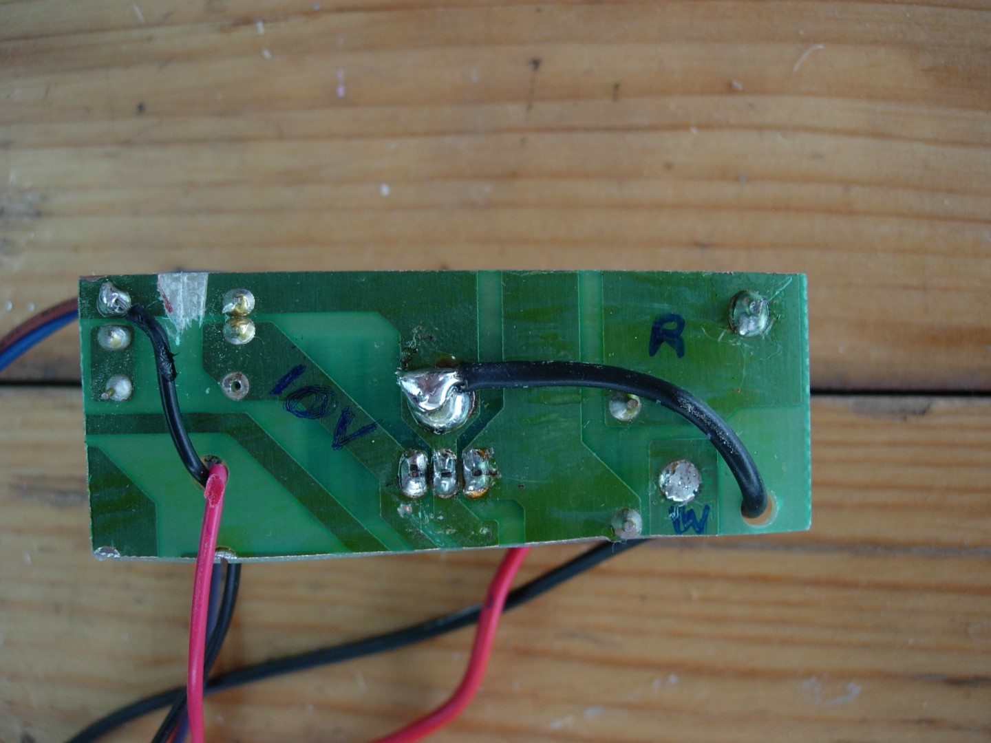

The 12V one is the one I use. The step down do dad, is the 10V reg & part of the circuit board cut off a Waeco.

I'll get hold of 12v thermostat anyway, but as I have the goods to do so, I'll reconfigure my panel(s) and set up a 24V system and see if it runs OK off that, as it did before. .If that doesn't work, then I'll try the 12v thermostat- ¿but in that case I can't see any need for a step down doodad anyway. ..?

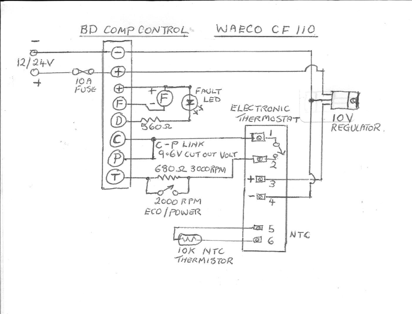

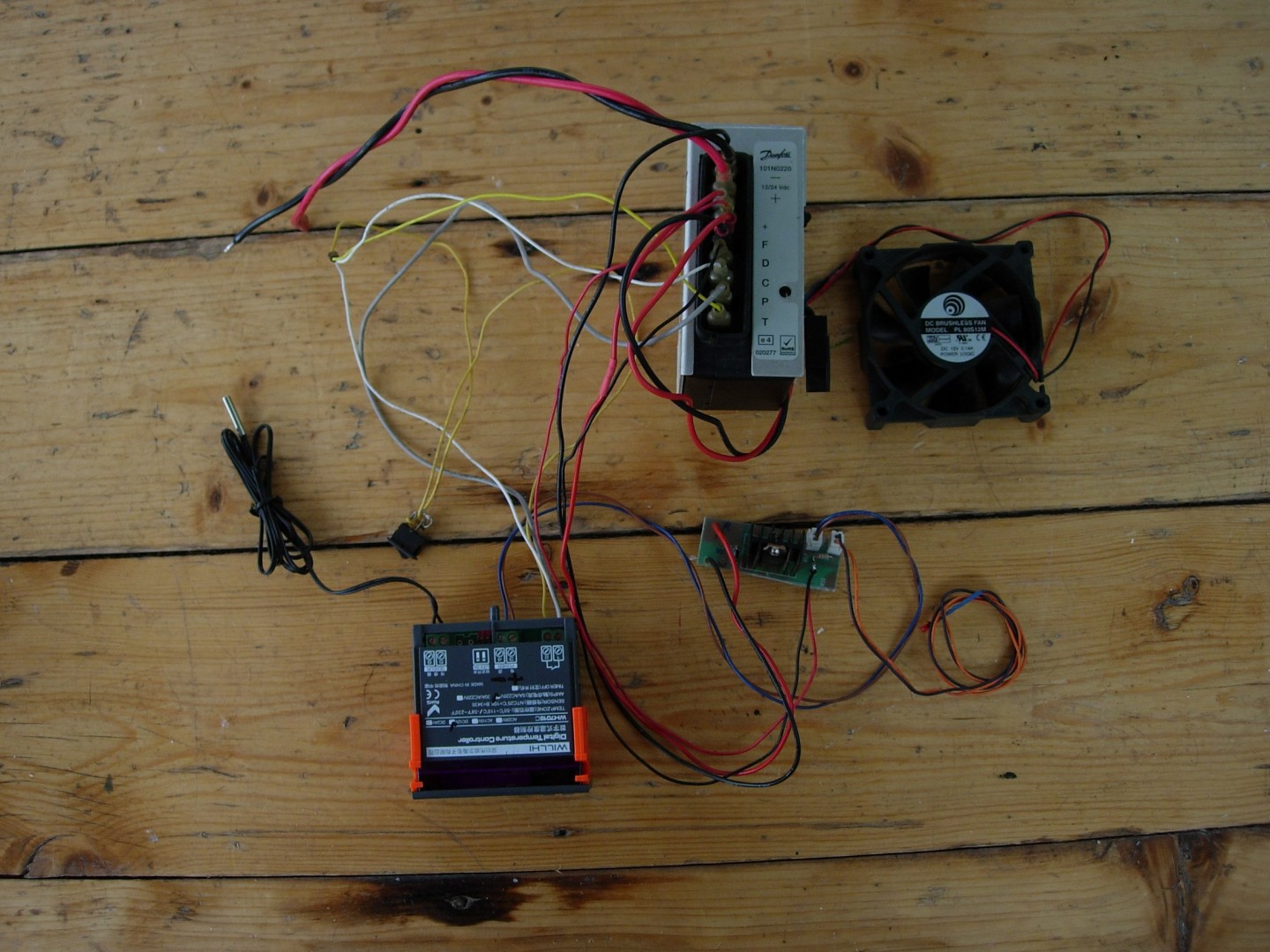

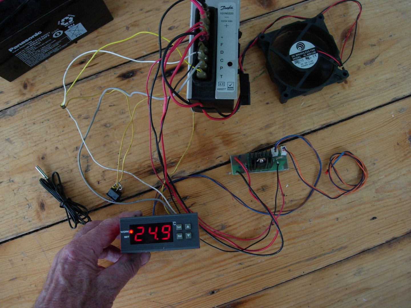

Hi guys, sorry to not have updated for a while, been caught up with other stuff..in fact I thought I posted this the other day.
The digital controller didn't arrive until after the NY break, so I made do with what I had. That was to rig a 24V application, which ultimately worked significantly no better than 12V, whilst away over the break. It worked fine with plenty direct sunshine, but even though the apparent battery voltage was generally around 12V, it still did the random cutout and error light on...I have a feeling the unit is super-sensitive to battery capacity. ...however...
But the main reason today is, I need to connect the digital controller, and looking at Debe's diagram and photos, looks simple enough, but am confused by the 560 resistor, as doesn't match to the resistor codes I'm looking at...?
Is any chance of clearer details of that and the one (680 ?)on the switch ..?? I just want to make sure I get it right thanks again for your help, and don't forget I'm not a tech-head
cheers, duTch
DeBe said
04:11 PM Mar 29, 2015
The 560 ohm resistor is for the Fault LED. The 680 ohm resistor on the switch is to give 3000RPM on the compressor if you want it to cool down quicker, it does draw more current when running. With the switch closed bridging the resistor it gives a mutch slower 2000 RPM (economy) draws less current when running.

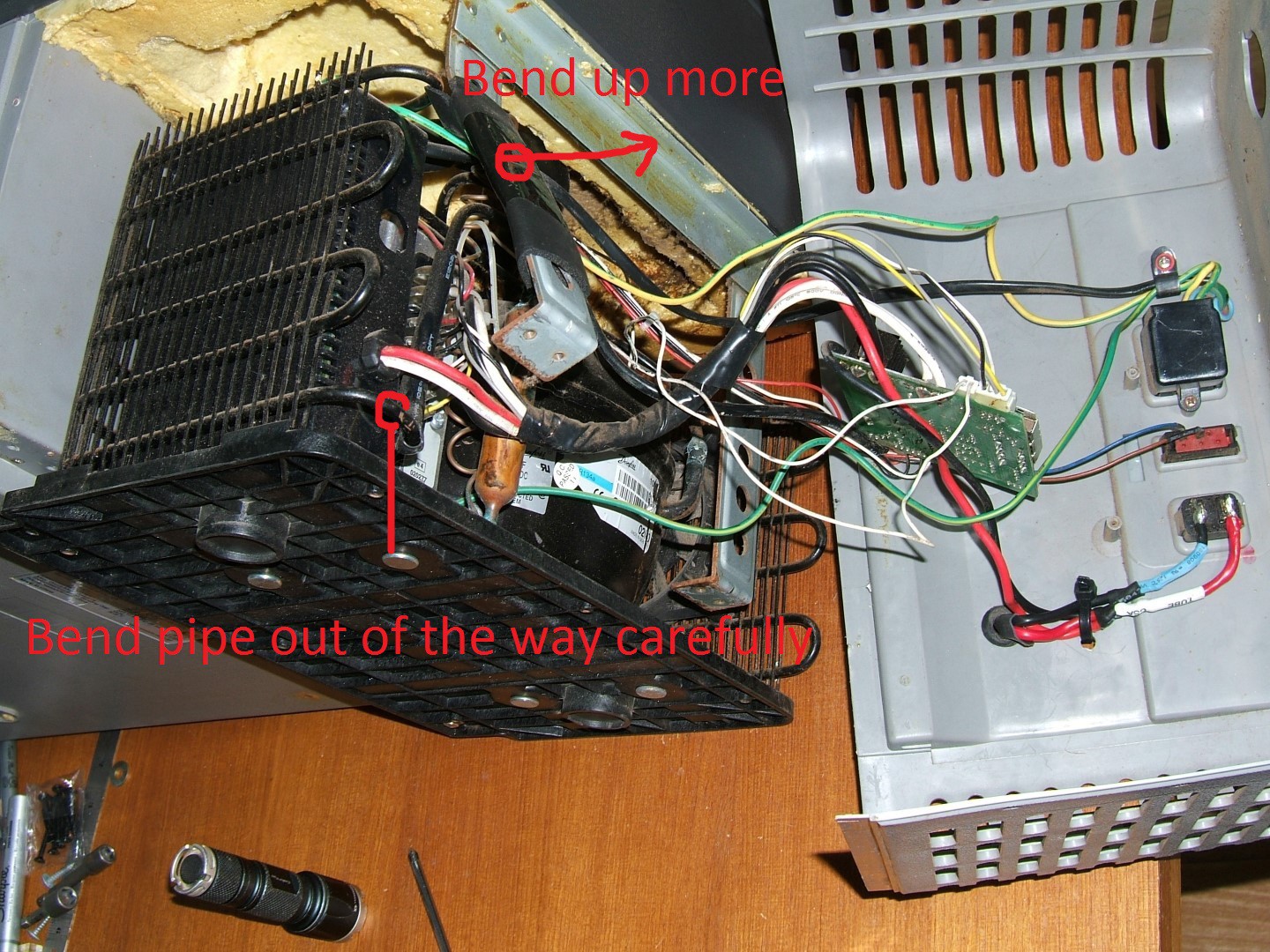

Debe and habana have successfully removed the PSU but for the life of me it has me beat. Sorry new to this forum and found it trying to solve a Waeco CF60 error light condition mucking around with temperature of the fridge. Even though the thread is old I hoped these guys still look in. I bought the 9 amp polyfuse but struggling to pull the PSU unit free. The condenser pipes are in the way. Even lowering the compressor tray and bending the bottom tube, there is no way of pulling the unit out. What also stops it coming are the leads and suppression doughnut on top of the plastic housing getting in the way. If those who have been successful doing this task, I'd love to hear some clues I might be missing.
-- Edited by phild01 on Wednesday 26th of April 2017 03:13:45 PM
-- Edited by phild01 on Wednesday 26th of April 2017 06:52:58 PM
The only reason I answer is I get an email notification when theres a post here. Have marked your pic on where I have bent parts to get it out, it is not an easy exersize.
Thank-you muchly DeBe, was the critical encouragement I needed. Just went back to it, un-taped the wiring, clipped the wire tie at the top and withdrew the thing. I really should have just done the suggested bypass with an external temp control. It's my BIL's fridge and he needs it soon.

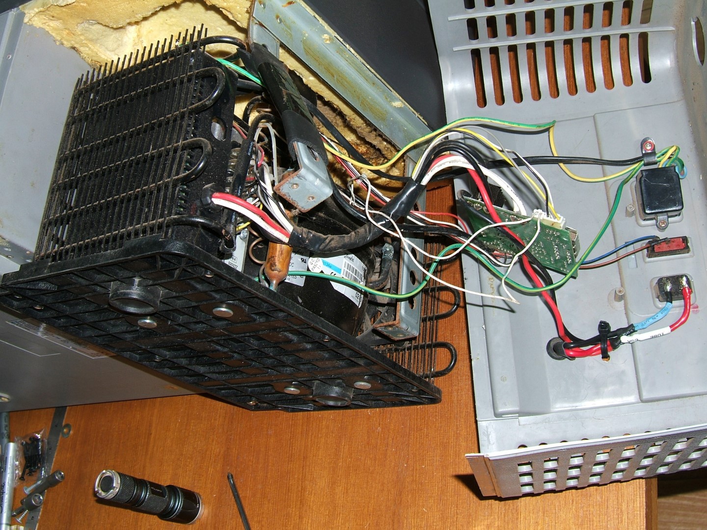

Hmm, I need to drill the pins that hold the board in, not to mention the glue. Must be devised as an anti-tamper warranty thing!

Got it all back together and working like new. I got a response from Domeetic-Waeco claiming that pre 2006 CF60 would not have a problem and if so it is because of low voltage/power supply cabling. They are in complete denial that the 2006-on models were simply upgraded because of this fault, and claim the pre 2006 models had no fault. Yep and pigs can fly.
Anyway BIL happy and thanks to you guys, I managed to identify and fix what Waeco won't admit to, to me anyway.
Waeco CoolFreeze CF-110 Main PCB (028221 Rev:A) - RPM control section Jumpers J1, J3, J5 installed & J2, J4 not installed Compressor-T (RPM select) CP2-6 o | |-----+----------+----------| | | | | | | | o | | | ) J3 Emergency | | | o SW3 | | | | SW2 slider switch _/ CP3-1| | | CP5-3 o ABS |--o/ o---o--+ | | / |----------o--+ | | / CP3-2| | | o/ o o CP5-1,2,4 | | | | | | | | | R3 | |R5 | R4 .-. .-. .-. .-. .-. .-. | | | | | | | | | | | | R3 = LOW (zero ohm link) | | | | | | | | | | | | R5 = MEDIUM '-' '-' '-' '-' '-' '-' R4 = HIGH (unpopulated) R1 | | R7 R6 | |___|___| | | | | | | | o | | | ) J1 | | | o | | |__________| | | | | | | | \| \| ___ | Q2 |---| Q1 |------|___|---> U3-2 Normal RPM | <| | <| R10 | | | | | | | | ___ | | -----)--------|___|---> U3-1 Turbo RPM | | | R11 |-----+----------| | | === Compressor-C (Common) CP2-5 Compressor-C o------| CP2-5 | (Common) o ) J5 o | Compressor-P o------| CP2-7 (Battery Voltage Limits)The new PCB is not directly compatible with the original one. The new board has jumpers J2 and J4 while the old board has jumpers J1, J3, and J5. This means that the battery voltage slider switch behaves as an RPM selector on your original PCB, but functions as an ABS switch on your new PCB (as per the manual).
attachments.allvolts.com.au/products/images_large/11998.png
Waeco CoolFreeze CF-110 Main PCB (028221 Rev:A) - ABS control section Jumpers J2, J4 installed & J1, J3, J5 not installed Compressor-C (Common) CP2-5 o | | o ) J2 o | SW2 slider switch CP5-3 o ABS / / o/ o o CP5-1,2,4 | | | R3 | |R5 | R4 .-. .-. .-. | | | | | | R3 = LOW (zero ohm link) | | | | | | R5 = MEDIUM '-' '-' '-' R4 = HIGH |___|___| | o ) J4 o | | o Compressor-P (Battery Limit Selection) CP2-7-- Edited by dorian on Saturday 6th of December 2014 09:04:21 PM
Waeco CoolFreeze CF-110 Main PCB (028221 Rev:A) U3 = EM78P458AP U4 = AT24C02 VCC ___ | |_____________ | | | | | | .------. | .-. | 16 | | | | R14 Q2 <----|1 | | | | | 20|--| '-' Q1 <----|2 | | VCC | 19|--------+---o CP6-4 Turbo SW --- | | | | | C5 .-. | | || Thermistor R8 | | | 18|-----+-----||--> GND NTC | | | | X1 | || | '-' | | _-_ _V_ CP4-2 | | | |___|3.58 MHz |--|___|---------o---+-------------|3 | - |----------------o---+ | | | || CP4-1 | | 17|-----+-----||--> GND === | | || C6 Temperature GND | | Display | | CP6-3 o---| Enable VCC o-------|4 15|------------o CP6-8 Power LED (bicolour) | | | \| ___ | | VCC Q4 |---------------|___|-------|6 | --- <| R9 | | | | VCC | | +-+--+ | --- | | | | === | | U3 | .-. .-. GND +--------+---+ | | | | | | | | | | | | | | | R16 | .-. .-. | | '-' '-' U4 | R18| | | | R19 | | |R17 | __ | | | | | | 14|---+----)---o CP6-9 Temp SW .-o|1 |o-' '-' '-' | | | |-o| |o---> GND | | | 13|--------+---o CP6-10 On/Off SW |-o| |o----------+---)-------|7 | |-o|__|o--------------+-------|8 | | | | | 24C02 CP6-1 o--------|9 12|------------> GND | Display Clock | | === | 11|------------o CP6-7 Power LED (bicolour) GND CP6-2 o--------|10 | Temperature | 5 | Display Data '------' | | === GND (created by AACircuit v1.28.7 beta 02/28/13 www.tech-chat.de)Thanks again for the input...
Quote from Allvolts;
"As for the slide control, slide it to the left and leave it like this(this is the instruction from Waeco, we dont find that the position makes a difference).
>The fridge should work as before except that the the slide control will always be in the low or economy position depending upon the size in litres.'
Photos are
1) Old remote SW1
2) Reverse of New PCB, SW1 at bottom above thumb
3) Closeup of R3, R5 which are beside SW1
I'll process that tomorrow.....I assumed when I found 'R3' that it be a Jumper you referred to earlier..?

Debe, it seems those thermo units come in a variety of dedicated voltage, I guess a 12v one will be more versatile in conjunction with your step-down doodad for 24 V.....now I just need to find the best place to get one
...however...
cheers, duTch

I can't see anything visually wrong.
When I plug the fridge in, it rapidly flickers on and off, and the relay can be heard flicking. When I then unplug it, the relay clicking gets slower, to a stop.
I have checked the output voltage of the board, it goes up and down from 8-12v.
What could the most likely cause of this be? Not wanting to fork out nearly $200 for a new power board.
Thanks.
I have replaced the C4 capacitor, fridge is doing the same thing.
When it's plugged into mains, but switched off, it makes a high pitch pulsing sound and the relay stays engaged.
When I then turn it on, it jumps up and down, relay goes on/off.
My electrical knowledge is pretty basic, but it would seam like a capacitor problem. Are there any other you recommend I try?
It does work fine on 12/24volts.
