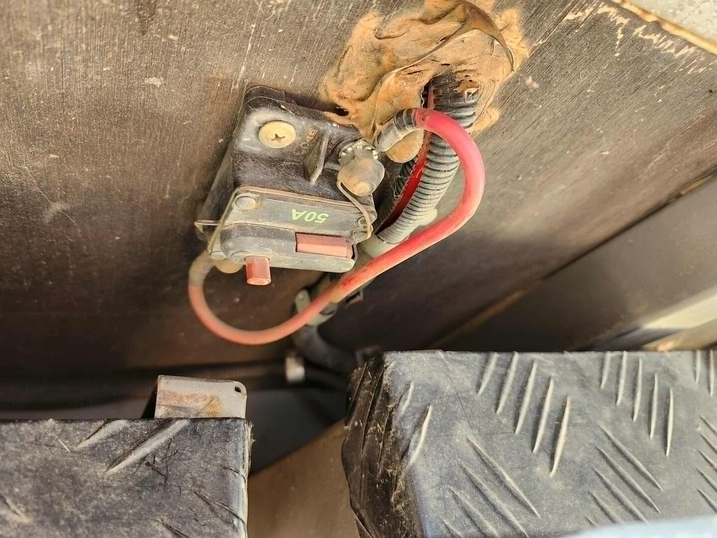

landy said
10:04 PM May 4, 2025
only thing I found under the Caravan Tim was this overload cut out down near the batteries.I don't know if it made any difference but I broke and then reset it then took some more readings. the batteries were showing 13.9 ( would have been some light on the solar panels) and Anderson plug on A frame which is 7 meters away was at 12.5 I could not follow the complete wiring harness as it wanders in and out behind the cupboards and through the floor on its journey from the draw bar to the battery boxes under the rear of the van. also wondering if you have any feedback on some of the Batteries being sold by Kings 4x4 superstore. Cheers Dave
I thought you said that you weren't getting a voltage reading at the draw bar and that's why I thought there may be some equipment installed between the Anderson connector and the batteries but seeing as you have a voltage reading obviously there isn't.

landy said
05:43 PM May 7, 2025
I wasn't getting A high enough reading at the A frame to start with Tim only just over 9 volt, but after resetting the 50 amp cut out it seems to have fixed it, it is now showing the same as across the battery terminals. I will search around now for the new battery or two and every thing should be good. A big Thank you to Tim and all the other people that have contributed to my lithium education your all much appreciated . Cheers Dave

Dave take a look near your batteries for any kind of equipment that may be connected which may be preventing the voltage reading at the drawbar. I would be surprised if anything is hidden behind a wall etc. If you post the make and model of your van then perhaps someone else may know how it is wired.
Good luck

Hi Dave,
As for King's batteries the reviews have been mixed and it appears plenty of people have had warranty issues. I did buy a solar blanket from them to test one time and promptly took it back and had an argument with a staff member in who had no idea what he was on about. Took two weeks for a refund. Have friends with their solar blankets which do not put out anywhere near the stated output. I recently had a chat with the guy at the local rubbish tip and asked if they have had any lithium batteries dropped off and he said no but they get a lot of their fridges. If you did go for that brand and had a warranty issue then at least you can go in to a physical store and try and address it.
Good luck
Tim
