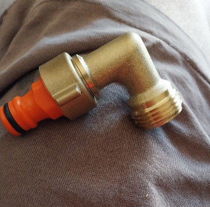

I got this one from Amazon for my van.
A, I was worried that someone or animal could knock it off being the std at 90deg.
B, or the hose hanging down puts load on the fitting.
