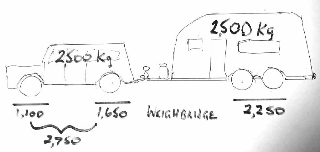

Brenda and Alan said
08:09 PM Oct 13, 2023
Yobarr and KJB. The axle weights on the tug are determined by the only other weight imput onto the tug (towball weight) and reflect exactly that. No magic, no altering gravity, no mass trandference.
Change the tow ball weight imput and you change the axle weights in strict accordance with the ratio of towball overhang to wheel base.
It is that simple.
Yobarr. In order to accommodate your belief it is inherrent that either gravity is altered or mass is transfered from tug to van.
As usual when pinned down you don't respond, so I ask again which do you think changes, gravity or mass. If you cant come back with a definte answer to this question I suggest you throw in the towel.
Alan

yobarr said
09:49 PM Oct 13, 2023
It is that simple.
Yobarr. In order to accommodate your belief it is inherrent that either gravity is altered or mass is transferred from CAR to van. (Tugs drift around the harbour)
Alan
Alan, again I will suggest that you're simply being mischievous? Can I suggest that you drive your car and van, with the untensioned WDH in place, to a local weighbridge.
Drive right across the weighbridge until only the van's wheels are on the weighbridge. Note the weight.
Now get out of car and tension WDH as much as you can, simply for this exercise. Note the weight.
Deduct first weight from second weight to show how much weight your WDH has added to your van's axle group. Simple.
Towball weight does not change, but total weight of van (ATM if you like) will have increased because the GTM has increased.
Note:- This is a much-simplified explanation of the procedure, but I hope that it is simple enough for you to understand?
Please refer to one of the many detailed posts I've previously made explaining the full procedure, as I feel that I'm talking to a wall.
When the designers and manufacturers, along with myriad experts in weights and dynamics, state emphatically that a WDH DOES NOT CHANGE TOWBALL WEIGHT it is difficult to understand your stance.
I am at a loss to understand how you persist with your own convoluted 'theories'.
Have a great weekend. Cheers
P.S How to waste BIG money.
-- Edited by yobarr on Friday 13th of October 2023 09:55:53 PM

In this hypothetical example, what is my towball weight? According to Yobarr if you said 250kg you would be wrong.
Usually I can decipher even the most convoluted 'reasoning', but you've got me stumped here!
How on earth you've decided that my advice would give a result different from the obvious 250kg towball weight, in the above illustration, is beyond me. Please explain. Cheers.
Are We Lost said
03:47 PM Oct 14, 2023
yobarr wrote:How on earth you've decided that my advice would give a result different from the obvious 250kg towball weight, in the above illustration, is beyond me. Please explain. Cheers.
The fishing is good today.
I must have forgotten to mention that the image is with a WDH fitted.
In this hypothetical example I also had more readings at the weighbridge. The weights before WDH tension were:
Front axle: 1030
Rear axle: 1750
Total: 2780
Van wheels: 2220
Ball weight: 280 (measured jockey wheel while disconnected).
The van can't change its weight. There are only two points that matter ..... the wheels and the towball. So if there is 30kg more weight on its wheels, there must be 30kg less on the towball.
-- Edited by Are We Lost on Saturday 14th of October 2023 04:00:47 PM
Front axle: 1030
Rear axle: 1750
Total: 2780
Van wheels: 2220
The van can't change its weight. So if there is 30kg more weight on its wheels, there must be 30kg less on the towball.
Unfortunately you appear to be so lost in the wilderness that you're likely to meet Alan.
Busy travelling today, but I'll have look later.Cheers
Front axle: 1030
Rear axle: 1750
Total: 2780
Van wheels: 2220
Hi Stephen, There is no need to play games ( I refer to "must have forgotten to mention that the image is with a WDH fitted"), but thankyou for confirming that fact, because it was the first variable that I thought of when viewing your pretty picture.
Perhaps you can help me, but I don't understand what your pretty picture is supposed to illustrate?
You should by now understand that a WDH removes weight from the car's REAR AXLE and distributes around 70% of that weight to the car's front axle, while the remaing 30% is distributed to the van's axle group.
This is clearly illustrated in your pretty pictures, where weight on wheels (GCM?) is constant at 5000kg.
Before you tension your WDH you have front axle at 1030kg, rear axle at 1750kg and van's axle group at 2220kg.
Thus you have a vehicle unit with 5000kg on its wheels. (Car 2780kg and van 2220kg)
After you tension your WDH you have front axle at 1100kg (70kg gain) rear axle at 1650kg (100kg loss) and van's axle group at 2250kg (30kg gain).
Thus you still have a vehicle unit with 5000kg on its wheels. (Car 2750kg and van 2250kg)
Your car weighs 30kg less ( 2750kg) than it did before WDH was tensioned,(2780kg) while caravan weighs 30kg more (2250kg) than it did before WDH was tensioned. (2220kg). Simple stuff.
Towball weight could have been 15kg (or 5 ton figuratively speaking ) at the outset, but it still would be 15kg (or 5 ton)at finish.
A WDH does NOT change towball weight.
Never has. Never will. .
You no doubt will have observed that, coincidentally, of the 100kg removed from the car's rear axle, 70kg (70%) has been distributed to the car's front axle, while 30kg (30%) has been distributed to the van's axle group.
Towball weight has not changed.
Unwittingly perhaps, you've shown exactly what I've been saying for eons.
As always, my primary objective is to help people understand their weights, so I hope that this helps you? Cheers
-- Edited by yobarr on Sunday 15th of October 2023 12:27:31 AM
Are We Lost said
09:30 AM Oct 15, 2023
Yobarr, most of your post appears to be explaining the weight distribution again. Don't forget it was me the developed those figures.
I was staying out of the discussion on whether towball weight changes or not because it is irrelevant. But I got sucked in again when you continued to propose using a weighbridge to prove it.
-- Edited by Are We Lost on Sunday 15th of October 2023 09:31:33 AM

Are We Lost said
11:07 AM Oct 15, 2023
What I meant was that it is irrelevant whether towball weight changes or not. That is internal to the system.
What is relevant is the outcome, being changed weight on the wheels. Those weights definitely can be measured at a weigbridge. They are what Yobarr refers to and we agree on that, although we differ on the benefits.
This subject has come up before and becomes more technical with discussion on the difference between weight and mass, rotational forces, using newton metres as a measurement and more. Without getting into it, I suggest you look up the different types of levers. In the case of that original photo it is similar to many WDH designs, (with the Andersen Hitch being a notable exception). It is using a second class lever with the fulcrum at the front wheels (like a wheelbarrow). This is opposed by ....
No I am not going there. Done.
Front axle: 1030
Rear axle: 1750
Total: 2780
Van wheels: 2220
I think change in towball weight is relevant now that it is the main topic. Just read the last 6 posts and it leads to nowhere.
Are you suggesting the 30kg extra weight on the van wheels is caused by the spring effect of the WDH? If thats the case hypothetically if you had a drawbar only no van and a towbars only no car hitched together then tried to tension a WDH the hitch would want to go towards the ground thereby adding weight?
I'm good at math but this is not easy physics for some.
Tony
