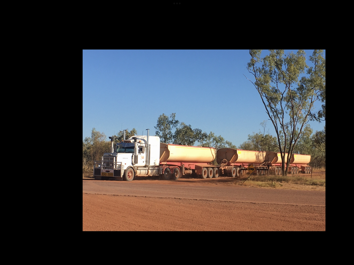

No need to panic Ralph, as law says two safety chains, but I simply made sure that IF van ever departed the car then drawbar cannot hit road. Although I try to check DO35 is locked whenever I set sail, if I have other things on my mind I may neglect to do so, and in the bush I have been told that young locals have been known to release locking mechanisms, with disastrous results. Simply more insurance. Cheers
P.S Good Roadtrain drivers can NEVER be referred to as "attendants". Specialised job with a loaded 4 trailer vehicle weighing over 160 ton on 82 wheels. Coping with caravanners who appear to be in dreamland is a constant worry, as you probably observed in your days on the road..

Never attendants but there are three classes of Road Train/MC operators "Steerers","Drivers" and "Cowboys. there middle one is dominated by the other two.

Could be right Graham, but presumably you know that there is a massive difference between imported Cowboys running around the Eastern states on bitumen in their little B-Doubles, and outback drivers in Roadtrains working on dirt roads, creeks etc. Cheers
