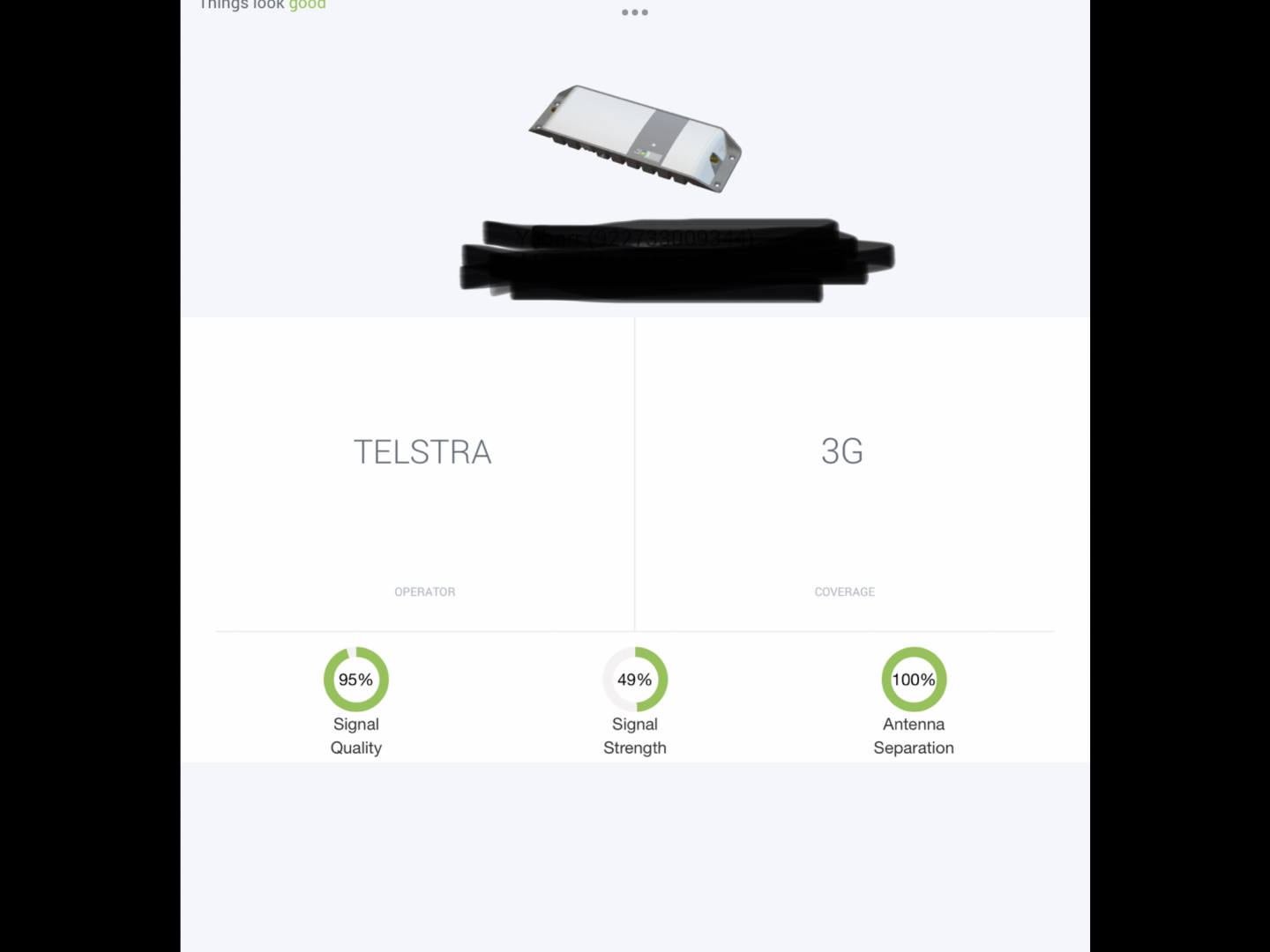

yobarr said
11:30 AM Apr 21, 2023
Are We Lost wrote:
yobarr wrote:At present I am about to again cross the Nullarbor, and have just fitted another aerial to my CelFi Go. Last trip I had signal all the way over.
The Nullabor is not a great test. Telstra shows a few gaps but I would expect a decent antenna with a bit of height would come close to covering all the way across. According to the Telstra coverage map, the middle of the biggest gap is about 75km east of WA border. You could check there.
lEdit: I see Cuppa posted much the same comment which I did not see when I posted.
Day dreaming as I passed the 75km point a couple of days ago, but got this reading about 45km from border while travelling at around 95km/hr. Cheers
