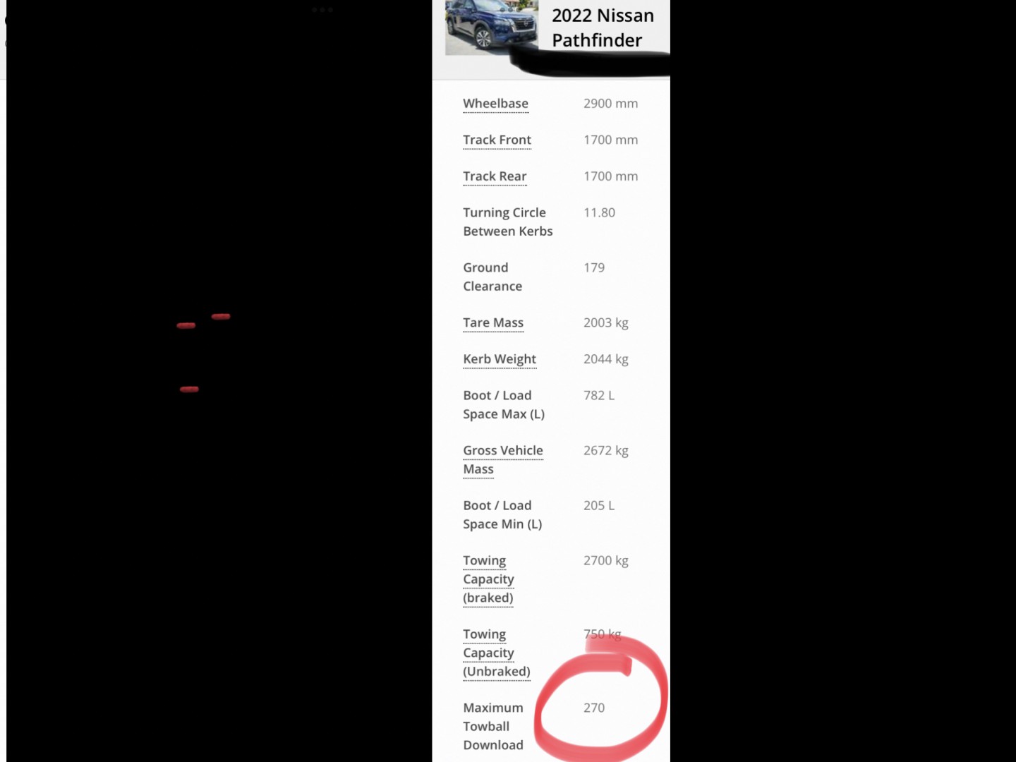

I have just bought a new Pathfinder, and I must say its fantastic, tows great, ticks all my boxes. will be used for towing and non towing duties. I looked under the tow bar the other day and to my surprise the plate thats welded onto the tow bar, just behind the spare wheel has the max tow ball weight at 200kg. Maximum towing is 2700kg. All other imfo from door pillow stickers to hand book and other advertising stuff is listed at being TBW 270kg and 2700kg max towing. It doesn't worry me that much as my Adria van TB weight is 120kg and ATM is 2000kg. But if I wanted to buy another van one day it could affect what I buy. So what label is correct?

I reckon some one has made a mistake, maybe the tow bar manufacture. Because all the official stickers on the door pillow, drivers hand book, advertising literature, says 270 kg! And the plate tacked on the back of the tow bar is hard to read, you have to take the spare tyre out to read it. I wonder in a court of law who would be deemed correct if something nasty happened. And how many owners would get down and go to the trouble of taking the spare out just to see if there was a hard to read plate tacked on the tow bar. I would say not many! I am going to contact Nissan and see what they say.

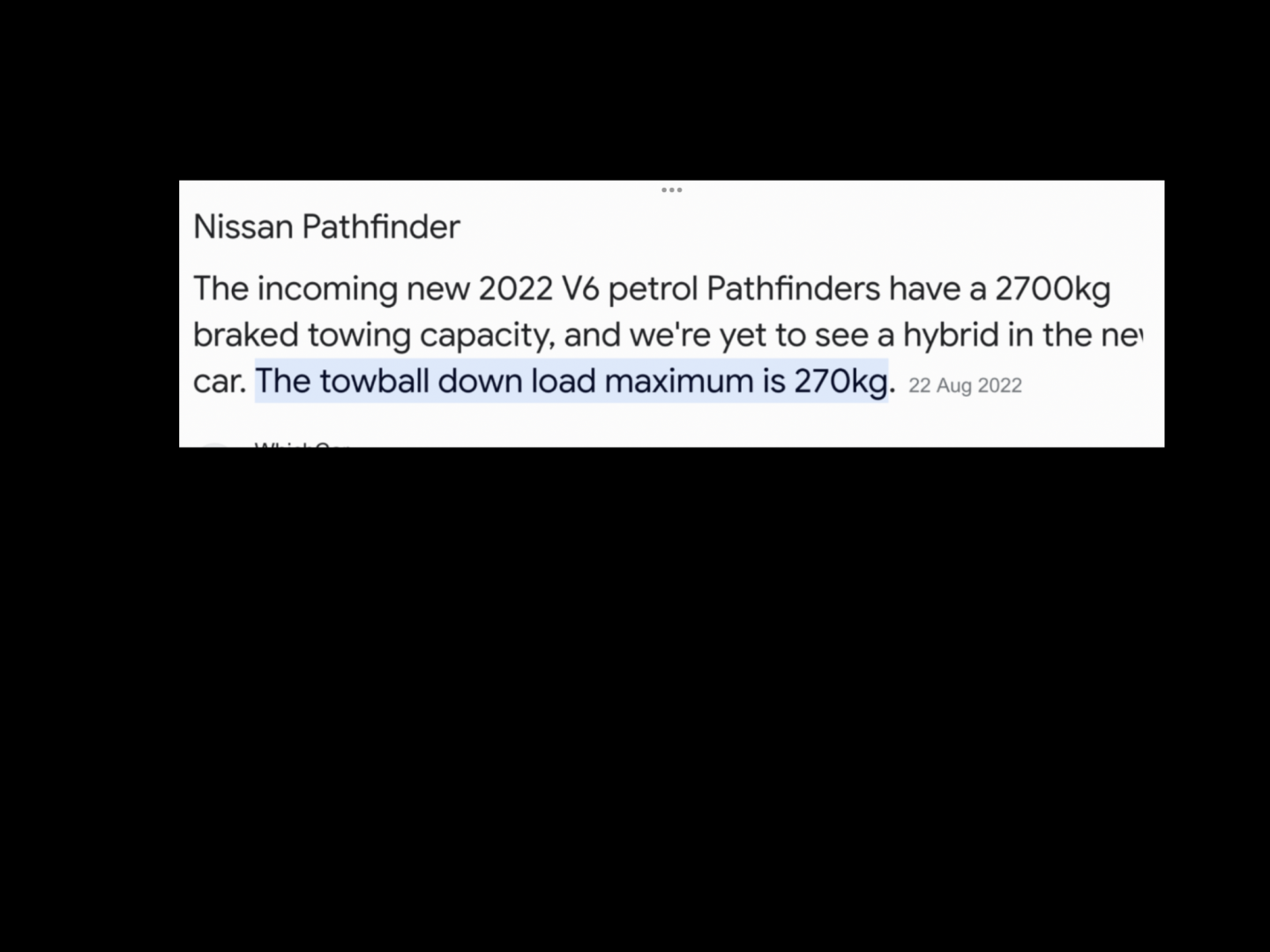

The plate on the tow bar says 2700kg for towing capacity but only 200kg ball, should be 270kg ball. I think Ill take the car back to the Nissan dealer and tell them please explain. Thats going to be interesting.

Wouldn't be worrying about it too much as Nissan literature says 270kg. Cheers
-- Edited by yobarr on Thursday 30th of March 2023 07:33:53 PM
Yes yobarr I agree, thanks. I will talk to Nissan and see what they say.

Bulldozer, earlier in the thread I pasted a snippet from the Nissan website.
Towing capacity is subject to towbar/towball capacity and is based on the fitment of a Genuine Nissan towbar. Towing capacity figure described is a maximum figure. Actual towing capacity depends on the laden mass of the vehicle, driving conditions, fitment of any accessories or towing equipment limitations including the maximum towball download. The maximum towball download for this vehicle is 270kg.
If you are going to be talking to Nissan I suggest you ask them to give you a link or printout for the detail of what the that statement means. If it is only staying within GVM, GCM, etc, then no drama. But do they still have something that changes limits according to what weight is on the ball? What driving conditions affect the limit?

Had another look at the tow bar plate that is hidden away and it is a Nissan Tow bar with the same numbers that match the bar and tongue. Nissan does say in the hand book that the label on the B pillar is gospel! that what you go by. end of story. 270 ball, 2700 bar. All labels ect have the same numbers. But yeah, not worried, as ive said max on my Adria is 130kg ball, 2000kg ATM....Thanks for the imfo yabarr much appreciated.
