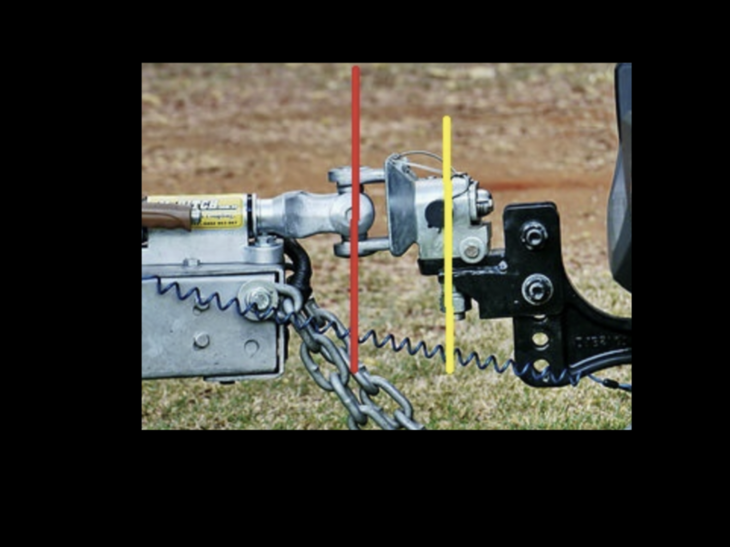

Hi Mike. Great to see that you're another adoring fan of the McHitch system, but please note that there is NO way that you can dispute that a McHitch increases TBO. This increase in TBO results in multiplication of the weight applied to a car's rear axle by the towball weight, as well as increasing the effects of yaw, one of the biggest causes of caravan accidents. Sad, inconvenient truth, but indesputable. Cheers
P.S Better internet today, so I have been able to supply a bigger picture to illustrate my point.
50mm ball vs DO35 vs McHitch. They all do the job they were designed to do. If one was superior to the others then an experienced driver should be able to know, just by driving, and not eyeballing which was being used. And I very much doubt if there is anybody capable of doing that.
The claim that a McHitch increases tow ball weight is laughable.
Tow ball weight is a n attribute of the trailer and has nothing to do whatever with the tow vehicle.
Also the claim that the McHitch multiplies the weight applied to the tow vehicle's back axle is misleading any best.
The tow vehicle has a certain overall weight which is distributed to the front and back axles.
The portion on each axle is determined by where the tow vehicle's centre of gravity is located.
As load is added to the vehicle( driver, passengers, luggage, fuel, etc), the centre of gravity moves resulting in changing axle weights. The same is true when a trailer is coupled to the tow ball.
All that happens is the total mass of the tow vehicle is increased by the tow ball weight, and the centre of gravity moves towards the back axle.
How far the centre of gravity moves is determined by the distance between the tow ball and the centre of gravity measured before the tow ball weight is applied.
The further from the centre of gravity that the tow ball is, the further that the new centre of gravity will move towards the back axle.
Using tow ball overhang is not the measurement to be used here as it is a constant and does not change when the tow vehicle load is changed.
As for the McHitch increasing the prospect of sway, maybe, but pretty much immeasurable.
The dynamics of sway are complicated.
When yaw happens the yaw pivots about the vehicle's centre of mass. This is true for the tow vehicle, the trailer and the combined tow vehicle and coupled trailer.
My gut feeling is that when the combined centre of mass is well forward of the coupling point that they are most stable. And that they become more unstable as the combined centre of mass approaches the tow ball.
The tow vehicle and the trailer pivot on their own centre of mass as does the combined vehicle and trailer. Each have their own oscillation frequency and amplitude.
Anyway these are just my thoughts on these matters.

Dennis, I don't know if you're being mischievous, or you simply don't understand, but much of what you've written is incorrect. Nowhere has anybody said that a McHitch increases towball weight. You seem lost. Today I am driving so will probably not be able to reply. Maybe tomorrow. Cheers

TBO = Tow Ball Overhang = Leverage, Not Mass.
Ivan 01 said
09:24 AM Jan 26, 2023
With the McHitch coupling the *leverage* caused by an increased *TBO* by its design was a little more difficult to fit a *WDH* than with many other tow bar couplings.
As jegog explained the *Centre of Gravity* of the tow vehicle is moved more toward the rear axle by having any tow coupling exhibiting more overhang or by having the distance from the centreline of the rear axle assembly to the tow ball or pivot, increased.
By the installation of a WDH this centre of gravity will be moved back more toward the front axle. This replaces some of the *MASS* back onto the front axle of the vehicle and removes some *MASS* from the rear axle, a fact which is easily proved on a weighbridge.
As Yobarr has said on many occasions a 79 series magically doesnt have the *TBO* of many other vehicles but in real fact when fitted with standard Toyota towing equipment, it does.
In some cases this *TBO* can be greater or longer than some other vehicles. (Rob was doing an exercise on *TBO* on the 79 series before his departure)
The 79 series suffers the same change in the *Centre Of Gravity* as does any other vehicle when connected to a pig trailer.
Toyota offer a WDH kit for the 79 to assist with this phenomenon.
As indicated by a picture posted by Yobarr above, the *TBO* can be changed on many vehicles with a tray body but the main disadvantage is to have to climb under the vehicle at the rear to connect a trailer.
In this case under the tray body with the shortened and modified draw bar and tow bar receiver, the McHitch might have been an advantage in the process of hooking up as the coupling did not have to be dropped on over a ball or pin but more just connected in one horizontal movement.
Unfortunately though, the procedure to connect the *WDH* on the McHitch while having to get under the tray body may have been more difficult.

yobarr said
10:30 PM Jan 26, 2023
jegog wrote:
50mm ball vs DO35 vs McHitch. They all do the job they were designed to do. If one was superior to the others then an experienced driver should be able to know, just by driving, and not eyeballing which was being used. And I very much doubt if there is anybody capable of doing that. The claim that a McHitch increases tow ball weight is laughable. Tow ball weight is a n attribute of the trailer and has nothing to do whatever with the tow vehicle. Also the claim that the McHitch multiplies the weight applied to the tow vehicle's back axle is misleading any best. The tow vehicle has a certain overall weight which is distributed to the front and back axles. The portion on each axle is determined by where the tow vehicle's centre of gravity is located. As load is added to the vehicle( driver, passengers, luggage, fuel, etc), the centre of gravity moves resulting in changing axle weights. The same is true when a trailer is coupled to the tow ball. All that happens is the total mass of the tow vehicle is increased by the tow ball weight, and the centre of gravity moves towards the back axle. How far the centre of gravity moves is determined by the distance between the tow ball and the centre of gravity measured before the tow ball weight is applied. The further from the centre of gravity that the tow ball is, the further that the new centre of gravity will move towards the back axle. Using tow ball overhang is not the measurement to be used here as it is a constant and does not change when the tow vehicle load is changed. As for the McHitch increasing the prospect of sway, maybe, but pretty much immeasurable. The dynamics of sway are complicated. When yaw happens the yaw pivots about the vehicle's centre of mass. This is true for the tow vehicle, the trailer and the combined tow vehicle and coupled trailer. My gut feeling is that when the combined centre of mass is well forward of the coupling point that they are most stable. And that they become more unstable as the combined centre of mass approaches the tow ball. The tow vehicle and the trailer pivot on their own centre of mass as does the combined vehicle and trailer. Each have their own oscillation frequency and amplitude. Anyway these are just my thoughts on these matters. I have used a mcHitch, but the dropdown hitch, which I think is better than any of the above.
Hi Dennis. Because I am working long hours, but still trying to contribute here, I made a slight mistake with my sentence "McHitch will substantially increase towball weight". If you paid as much attention to ALL my posts on the effects of using a McHitch as you did to this one you would realise what I intended to convey was that " McHitch will substantially increase the effects of towball weight". This I have written dozens of times over the years to help people understand the physics. Sorry to confuse you, but a McHitch multiplies the towball weight's effect on rear axle weight.
There are two primary things that affect how much weight a towball applies to the rear axle of a car. The main one, obviously, is towball overhang, but of equal importnace is the wheelbase of the car. This is where Ivan's good friend Rob was confused, with his attempts to denigrate a certain vehicle being meaningless, as the vehicle he was comparing it with has a wheelbase a HUGE 330mm shorter than the vehicle he was denigrating. No contest. Hope this clears things up for you, but if you have any queries please feel free to ask. When it comes to weights I do know what I'm talking about, and always I'm happy to help. Cheers
-- Edited by yobarr on Friday 27th of January 2023 05:33:29 AM

With the McHitch coupling the *leverage* caused by an increased *TBO* by its design was a little more difficult to fit a *WDH* than with many other tow bar couplings. As jegog explained the *Centre of Gravity* of the tow vehicle is moved more toward the rear axle by having any tow coupling exhibiting more overhang or by having the distance from the centreline of the rear axle assembly to the tow ball or pivot, increased.
It also moves weight to your van's axle group, a point that I first made 5 years(?) ago, causing many, including your good friend Rob, and a couple of other well-respected members to hurl all sorts of abuse at me. After my detailed explanation of the physics involved eventually they realised that a WDH DOES indeed increase total weight of van. (ATM if you like)
As Yobarr has said on many occasions a 79 series magically doesnt have the *TBO* of many other vehicles but in real fact when fitted with standard Toyota towing equipment, it does. In some cases this *TBO* can be greater or longer than some other vehicles. (Rob was doing an exercise on *TBO* on the 79 series before his departure)
What both you and Rob don't seem to realise is that two vehicles with the same TBO can have vastly different weights applied to their rear axles depending on their respective wheelbases. My car has a 3180mm wheelbase while Rob's has a ridiculously short 2850mm wheelbase, as well as a huge tare weight. No comparison.
Ivan, previously I have explained to you that my car has 880mm clearance under the tray. How much room do you want? There is absolutely no need to get under the tray to connect the van to the DO35 mount. Once it's been lowered, by jockey wheel, onto the pin there's a quick press of the button that releases the catch, and job's done! Some people are happy to use a couple of hooks for safety chains, but I discarded mine, and now use simple shackles. Easy as!
In this case under the tray body with the shortened and modified drawbar and towbar receiver the McHitch might have been an advantage in the process of hooking up as the coupling did not have to be dropped on over a ball or pin but more just connected in one horizontal movement.
The towbar receiver is as it left the factory. "Modified drawbar" I do not understand, or are you meaning the shank? My shank was specially built not to get the towing connection closer to the car, but simply to get it at the right height to prevent one van axle carrying more weight than the other. My van has independent suspension, but not load sharing, so it is critical that the chassis be level and that axle weights be as close as possible to equal. You no doubt know that, with this suspension arrangement it is important to run 3-4psi less in the lead axle of the van than is in the rear axle. Cheers
Unfortunately though, the procedure to connect the *WDH* on the McHitch while having to get under the tray body may have been more difficult. So this is really just another decision as to what will be the right horse for the course.
Some may ask so what is my point. Well the McHitch could be an advantage in some installations.
The only time a McHitch is "an advantage" is if the trailer being towed is a lighter model which will not adversely affect the car's rear axle weight, or the driver has physical limitations. However, he still has to raise and lower the jockey wheel.
After my opening post I have done a basic search to see if there is a reason for their closure and at this stage all I see as that it was *due to unseen circumstances*
Whatever the case I wish the company founders and staff all the best with the closure and any new ventures if in the plans.

Using the Landcruiser as an example, it's wheelbase of 2850mm is quite short. While a longer wheelbase is more desirable for towing, at least the towball overhang is not so bad. Without having one to measure, I am guessing that with a standard shank, perhaps cut to the minimum length it may be around 1200mm. Perhaps someone could advise what the actual measurement is.
With those figures it is easy to calculate what a given towball load adds to the rear axle. Using those measurements I quoted, and a hypothetical towball load of 300kg, that would apply 426kg to the rear axle.
Earlier Yobarr posted a photo of a McHitch and marked the additional overhang it adds. It looks like about 100mm to me. So let's do that calculation again. Wheelbase 2850mm, towball overhang now 1300mm. It adds a whole 10kg.
Is that all we are arguing about? Just 10kg difference?
But what about all the weight taken off the rear axle when the hitch is tensioned. If you tension it to lift 100kg, that is a net 90kg lifted. That would be mostly added to the front wheels and a little to the van wheels.
But even this substantial improvement is further improved when on the road. The dynamic nature of a WDH means that the more it is needed, the harder it works. Think of what happens on road undulations. As the rig starts to porpoise, the towball download increases substantially, then on the bounce back, can reduce to nothing. The WDH applies more force when needed, and none when not wanted. So when the van is applying more than that 300kg towball load during a bounce, that automatically tensions the WDH further. Reduce the towball load when it bounces back the other way and it applies less tension.
What a brilliant design.
