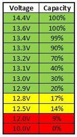

Your battery does not have Bluetooth so all you can do is monitor the voltage. The issue is that with LifePO4 the discharge curve drops sharply at first and is then so flat that even a 0.1v drop can be a significant %. The table below will give you an indication of what I mean.
Tim

Thanks for chart/table attachment youve supplied, it will give me a guide when I check on the battery when I go up to Melb..
Tim
