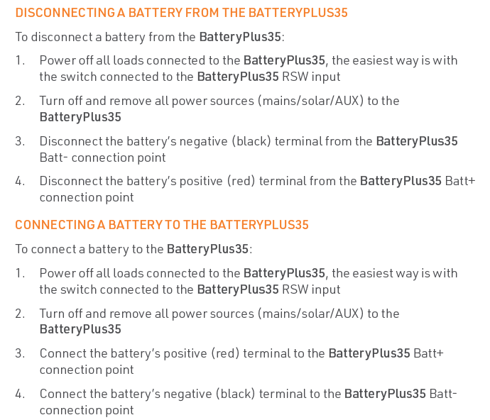

The attached is from the user manual of my BMPRO BatteryPlus35 (the nerve centre of my van).
And that is for the same reason both Dorian and I have highlighted. It is not because the little electrons get confused or the mothership neutron blasters will go off accidentally or any other magical event imagined by idiots who have no *&^$# understanding of electricity.
