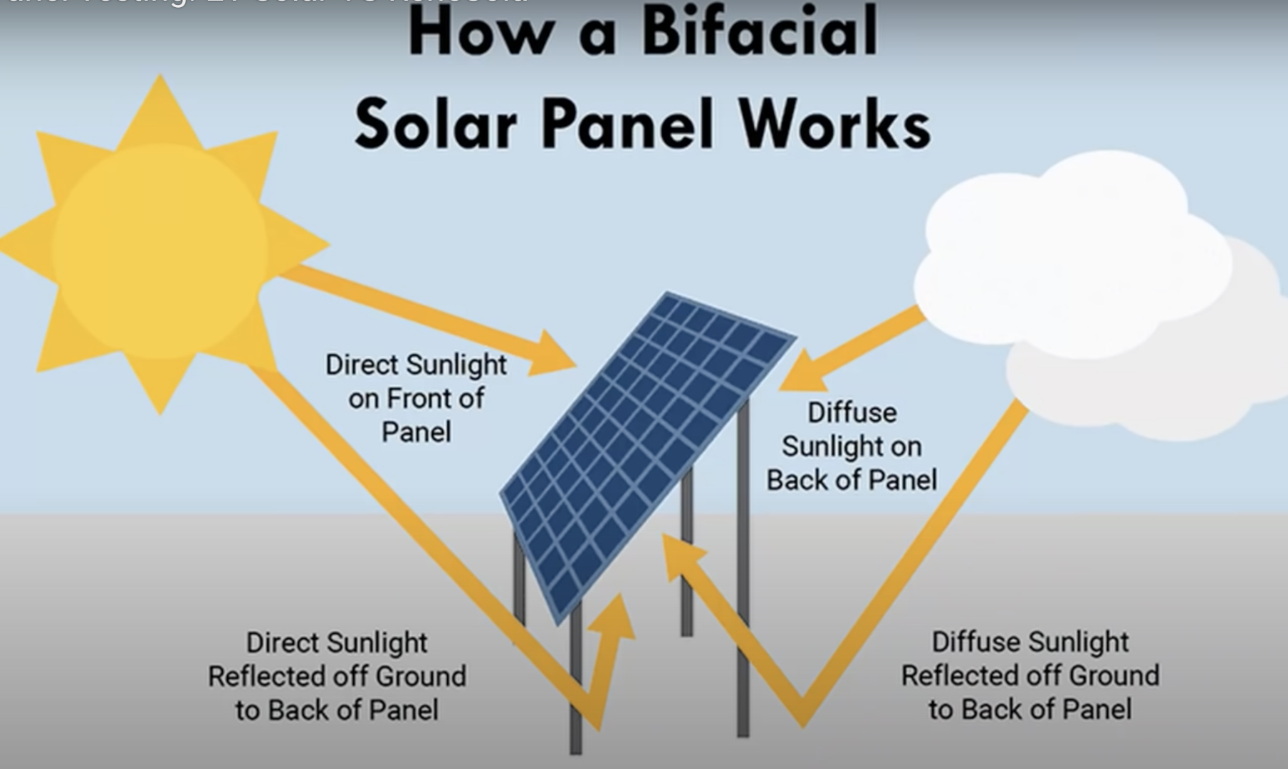

I will speculate the incidence of bifacial solar panels used by the camping and nomad community is of the order of 0.0000001%
https://www.semprius.com/bifacial-solar-panels/
And you would be correct.
Also, they are heavier so why would they be used, especially for caravans and portable applications.

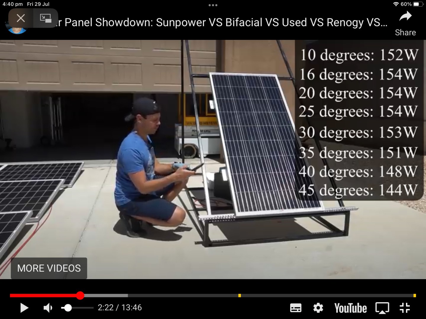

Mike Harding suggested that there was something wrong with another's testing methodology when it returned a result that he did not expect - all, I suspect, without watching the utube video.
Had he watched the video he might not have made that comment.
My post in reply was to point out that there are many different types of solar cells with vastly different characteristics.
As for his comment re the usage of that type of panel by the grey nomad community, well I was not suggesting that the shown panels should be mounted on caravans, and as I just said, I was pointing out that there are many different types of solar cells.
However there may be readers who have a home, and having it pointed out that not all solar cells are the same might just be beneficial.

Then I suggest there's something wrong with his experiment.
Not only does my experience show a difference but if you adjust angles in this calculator you'll also see one:
Solar calculator

There was nothing wrong with his simplistic test but depending on your location and panels you have you cant expect to have similar results.
https://www.youtube.com/watch?v=c-auRHKq2-A
