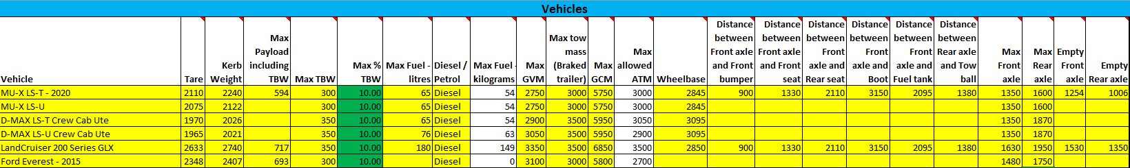

KevinJ - inspected your Load Calculation spreadsheet at length. Couldn't find where to insert my results. The distance from axles - is this done physically with a tape measure?
Bobdown - thanks for your reassuring words. My key issue was caravan sway well below the 100km/h speed limit and how best to minimise it.

You enter the measurements in the "Tugs and Vans" TAB. (See TAB names at the bottom of the spreadsheet). These are static values which never change for the vehicle, hence why they go on this TAB. Yes, the values are based on you measuring the vehicle with a tape measure. See attached file for where the numbers go.
I used a bricky's level vertically at the positions I wanted to measure and then put some insulation tape on the ground at that point. It was then easy to measure from point to point.

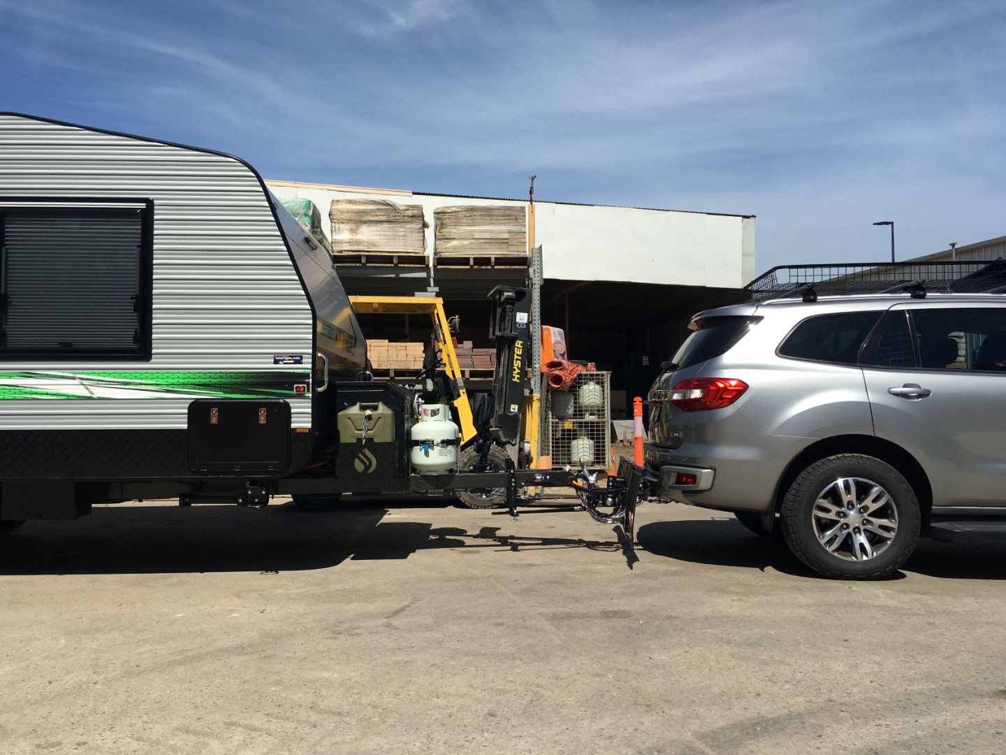

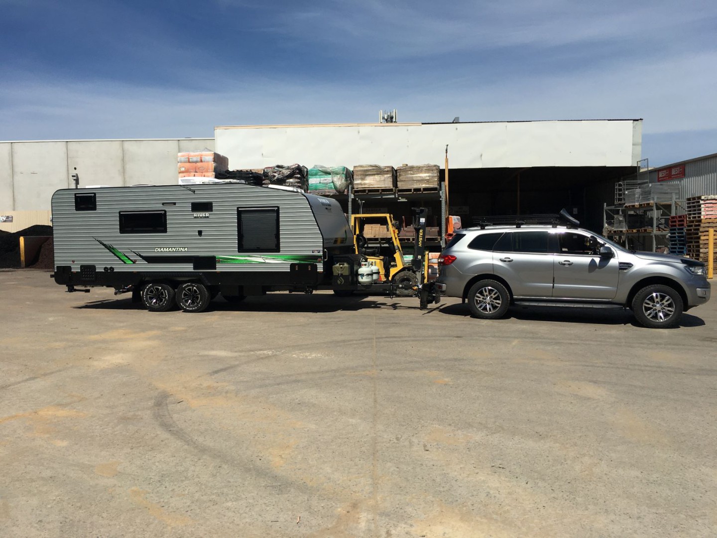

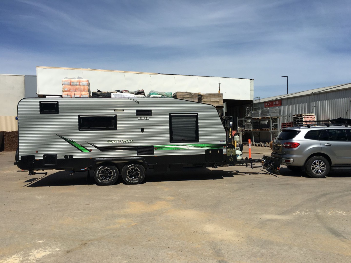

KevinJ - 'yes' I did but as mentioned last post the 4" & 6" hitch were not available and I resolved to trialing the standard 3" that was available knowing it may not have enough drop. I was constrained purchasing locally since I had to physically sight and fit the hitch to ensure it could accommodate my vehicle's stone stomper mount on the hitch.
When fitting the 3" on level ground and hitched the van was very slightly nosing up. I realised after this that with a lower figure with the WDH fitted for the front fender from road than unhitched altogether, the WDH was over-adjusted. I dropped it to the lowest on the Fastway E2 hitch and the bars closely followed the chassis of the car and van, i.e. parallel horizontal plane and there was not the effort to tension them as before when over-adjusted.
It was at the weighbridge today that I noted the van was still nosing up and the rear door spirit level gave the reading of a half bubble out of the ideal marked zone.
Further to that I have added 2 washers to the E2 (7 in all; the max.) to angle the head down to see if that helps with the nose of the A-frame. It did with the nose however increasing the angle also increases the angle of the tensioning bars and I aborted going further since it was obvious I would again be over-adjusting the E2.
See attached pics here showing the pitch of the van relative to the car at the weighbridge. Let me know what you think regarding the nose height, if you will.
Whilst the importer is awaiting supply, as said, I have found a dealer in NSW who has spares of the 4" and 6" hitch. They are not cheap commencing at $150 and up.
Unfortunately, they are not available here in SA.
The nose pitch of van is not great but possibly enough to be contributing to sway, what do others think?

The first photo seems to highlight that nose up attitude more than the others. Do you have load sharing suspension? If not then I think it is a bit excessive as the rear wheels will be taking more weight. That imbalance could easily be a sway contributor. You would probably be able to feel a higher temperature in the tyres after some highway travel. If you DO have load sharing suspension then it is less important. The NSW recommendation is level or slightly nose down. Can you measure from the chassis rail front and back? It would be nice if that hitch allowed a further notch down, but then you may get ground clearance issues with the bars.
However, looking at the hitch I see another issue. It extends a long way past the rear of the car. The shorter the distance between your car rear axle and the towball the better, for 2 reasons. First, that longer lever applies more weight to the rear axle, contibuting to you overloading the limit. That 220kg ball load probably adds over 350kg to your rear axle.
Secondly, it is more leverage for sway to begin. This is one of the negative compromises with WDH, that they are typically longer than a standard shank. You may be able to shorten it. An engineering shop did mine while I waited for $20.
A few posts ago PeterinSA mentioned checking the wheel alignment. It's not uncommon for new vans to need a little tweak. Hopefully not. But let's focus on the weights for now. I think you can see there are a few things that could easily be contributing to sway, and solutions may not be very difficult.

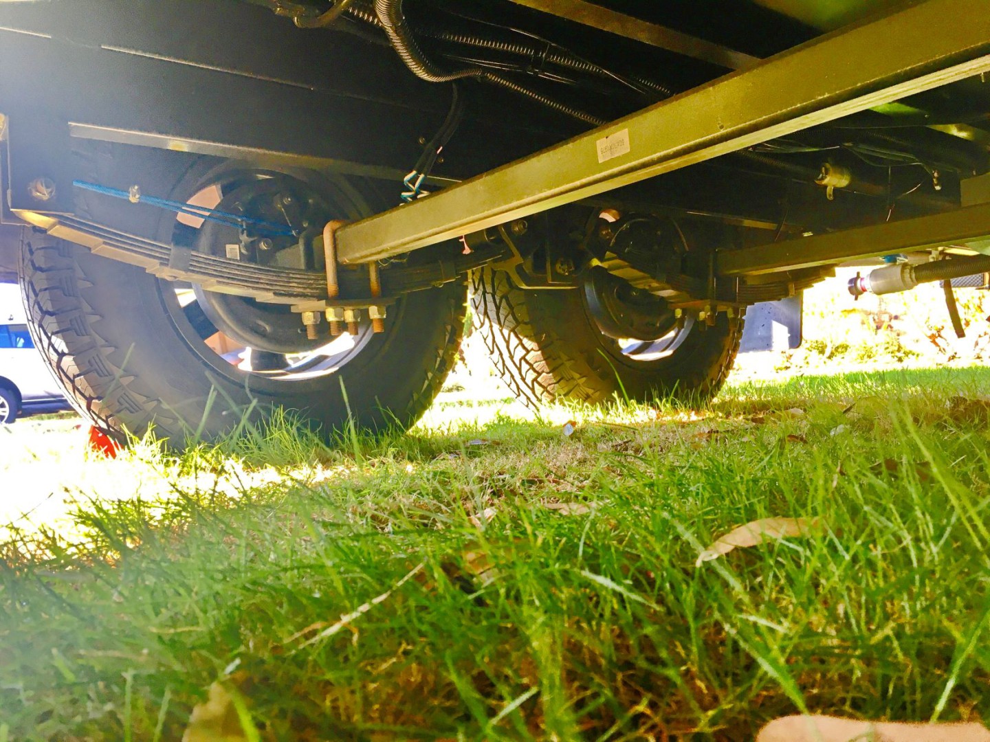

Are We Lost - Unfortunately 'no' I believe I do not have load sharing suspension. Just 2 leaf springs attached to both axles with a common union. I believe that is referred to as dependent leaf spring suspension.
I attach a photo here for your confirmation.
I believe the van may need tweaking. Many bolts I have come across on the van have been left loose by the manufacturer. Having said that, I did get under the van the other day and the union bolts that affix the axle to the leaf springs appeared tight with lock fixing blue glue to keep them that way. I was less certain however where the two leaf springs met the common union. There are no dampers.
Are We Lost - I will shorten the E2 hitch if possible. Your points raised are very valid. I just need to be careful in any shortening that I keep something like the 3" overhang of the E2 tensioners in the sway control fittings as specified by Fastway.

Looking at those photos again I am not so sure the level is so bad as to be concerned. Perspective may be making it look worse than it is. You said the spirit level is half a bubble from level. A tape measure chassis to ground at each end will tell you.
However what you said about water and other items is concerning. On the drawbar you have 2 x 9kg gas bottles (40kg when full), a toolbox (20kg including contents?), electric jack 17kg, water 20kg, bike rack (plus bike), 20kg? And in the tunnel boot there is the generator (30kg), Weber and a few sundries.
That is about 120kg of items on the drawbar, and maybe 50kg in the tunnel boot. AND 170kg of water in front of the axles. And it is STILL too light on the ball?
What would happen at the end of a trip with empty water and gas tanks? There is absolutely no way you should need to travel with full water tanks to get a reasonable balance.
While weight up front is nowhere near as bad as weight at the back, its a LOT of weight to carry away from the centre of the van. With the washing machine and spare wheel at the back and all this at the front, the wheels act as the pivot point. Your goal should be to reduce weight at EACH end. But that is looking more difficult.
I thought things were looking to be fairly easily solvable, but your next dilemma is that even with that lighter than desirable towball load, the Everest rear axle is already 70kg over limit before the WDH is fitted. So you certainly should not be adding more weight to the front of the van. And then the laden van weighs almost the same as the laden tow vehicle. Manageable if everything else is OK, but it's not.
With all these things adding up, its no wonder you found the sway a problem.

Radar said
08:06 AM Mar 21, 2022
There is the problem in your last photo.
To much hard wear from the rear end of the car.
Added lenght of tow hitch. That is the culpit.
Stone protector.
WDH. System
Place a normal tow hitch in the tow bar and take the lot for a drive.

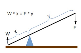

The formula is:
W * x = F * y
W = weight lifted from front wheels (= what gets added to rear wheels above towball load)
x = wheelbase
F = towball load
y = towball to axle distance
You know F, x and y. So W = F * y / x
Do the calculation with standard hitch and again with the WDH shank fitted.

Hi Tim,
-- Edited by KevinJ on Sunday 20th of March 2022 03:45:51 PM
Tim, did you follow the instructions in the E2 manual to setup the WDH?
Cheers, Tim

I see you posted an update with photos while I was composing my post above.
Cheers, Tim
Unfortunately I have a lack of options in terms where I can mount the brackets on the A-frame short of welding them in place. All grist for the mill ...
If you move weight forward in the van (you probably can work that out for yourself), there will be more tow ball weight. So, theoretically because of the extra weight, your car will be lower at the rear with the van hitched. This may give the amount of lowering of the front van that you are looking for. Of course, this is adding more weight to the car which has to be managed. I think you will be successful.
Stone protector.
WDH. System
I agree . That ball needs to be as close to the car as possible. All the other fittings are just adding weight ( and right where you do not need it..) KB
-- Edited by KJB on Monday 21st of March 2022 08:37:04 AM

Tim, How did you go with the measurements on the "Tugs and Vans" TAB?
You may also be interested in this post I made back when I was going through the same exercise you are doing now.
https://thegreynomads.activeboard.com/t67501652/weights-and-measures-by-a-layman/
Have a read of the notes I made after the tables in the PDF file.

One important aspect of stability that has not been mentioned is wheelbase. I believe the Everest is 2850mm which is relatively short for a rig that is reaching its towing limits. The longer the wheelbase, the more it will resist sway, and the less the leverage effect will increase rear axle load.
I would measure the Everest rear axle to towball distance with the WDH fitted and again with the standard hitch. Weigh them as well. You can then work out how much the WDH affects your rear axle load before it is tensioned, compared to the standard hitch.
The formula is:
W * x = F * y
x = wheelbase
F = towball load
