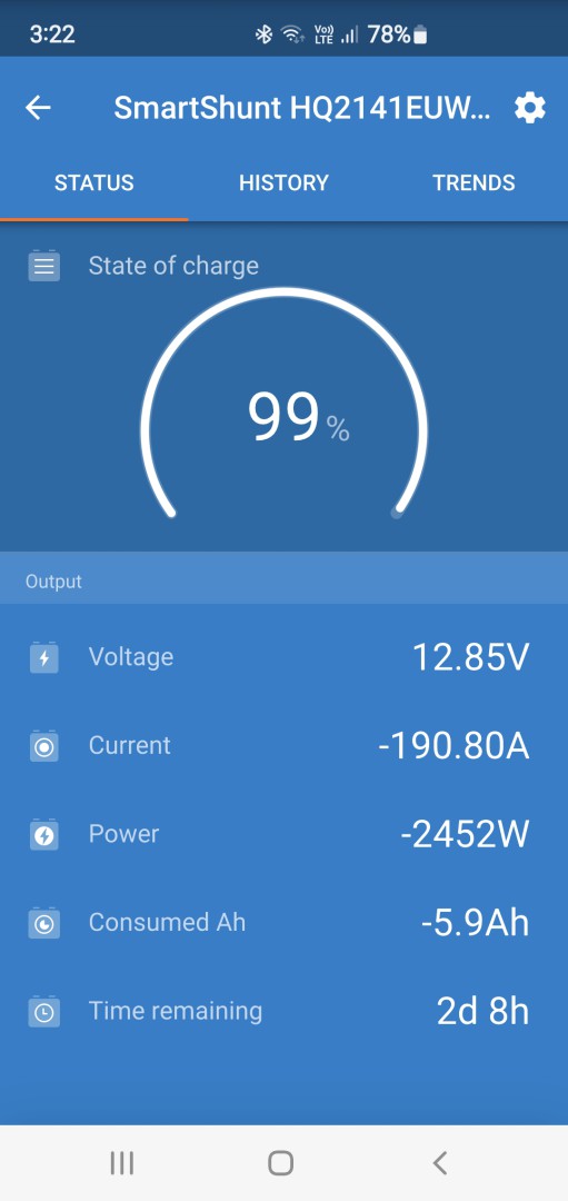

Just for the record the Giandel 3000W draws 0.8A at 12v on standby but as I previously said, it has a remote switch which makes it easy to turn off and on when not using it. With 560Ah of LiFePO4 it isnt really an issue for me.
One thing I did do though was upgrade the cables to double 3 B&S which are rated at 168A each.
Tim
11:44 PM Sep 30, 2022
What is the total length of both positive & negative wire between battery & inverter for the 2 x 26.45mm˛ (52.9mm˛) wire?
TimTim said
04:48 PM Oct 1, 2022
Total length of + and - is 700mm. Even though it is a 3000W inverter the maximum appliance will be 2400W.
