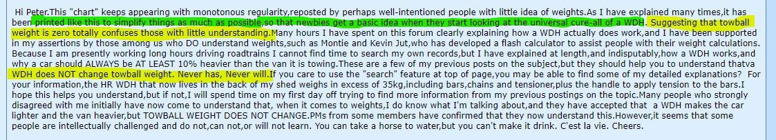

Just a response to a few comments by Yobarr previously.

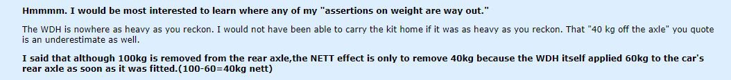

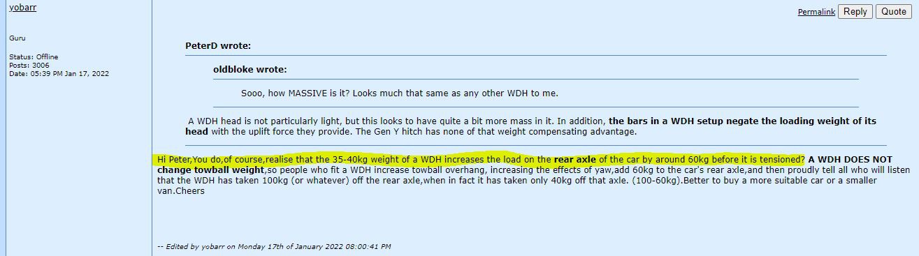

Today I weighed my 600lb HR WDH Hitch. With the ball attached 14.2 kg. I would suggest adding the bars would be 5kg at most. So a close estimate 19kg, nothing like the exaggerated 40kg mentioned above.
Once again 40kg is an exaggeration. Perhaps an error?

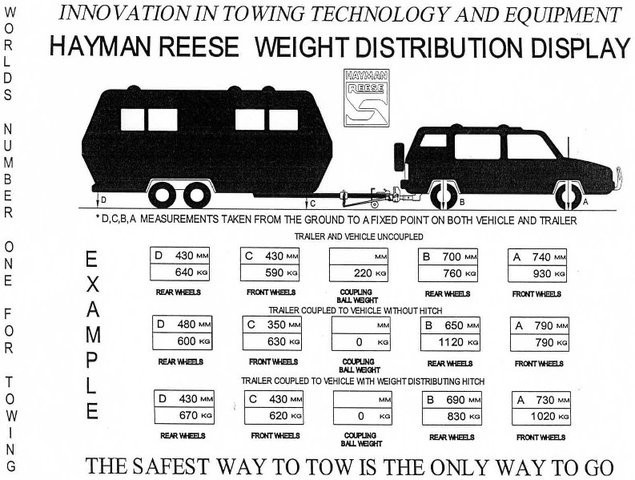

I find it interesting that you suddenly now talk as if it's (the chart as you call it) a guide for newbies, when in the past you have asserted or strongly suggested that it was a technical or precise document. I have in the past said many times that it needs to be treated as a "guide" only.
Some users and obviously yourself may think that HR are suggesting TBW is "disappearing", but it does not do that at all. They are simply attempting to give an example of how the WDH works and the weight is distributed. Again you make the many times repeated statement "WDH does NOT change towball weight. Never has. Never will." This is a suggestion that the "chart" is not correct.
I've got news for you, everyone understands (and I always have) that gravity does not change and the the TB coupling is still pushing down on the tow ball and the weight is then distributed from the tugs rear axle through the vehicle(s) to the front tug axles and the van axles. However you assert that the HR document "confuses" newbies. I believe in the past you have said it was "miss leading" I simply believe it s correct.
Yabarr, to support/prove your argument instead of repeating the above statement would you please edit the document to show the correct weights including where the TBW(s) should be shown and perhaps we will all learn something? I have attached it for your convenience.

Come on yobarr. Is the document correct or miss leading? If it's miss leading because "TBW never ever changes" please change it so that it is correct. (perhaps add the TBW) Nobody is discrediting you, just change the chart so the weights are correct and post it so we can all learn. As I said earlier, it's attached for your convenience.

Come on yobarr. Nobody is trying to Is the document correct or miss leading? If it's miss leading because "TBW never ever changes" please change it so that it is correct. ( perhaps add the TBW) Nobody is discrediting you, just change the chart so the weights are correct so we can all learn.
I'll leave that all up to you,as when it comes to weights etc you seem to know lots of nothing,or more likely you take great pleasure in simply being contrary. Over the last few years I have spent many long hours researching and successfully compiling pages of useful data for the benefit of those members who wish to learn.Everything concerning WDHs is explained in great detail,and has helped fellow members,such as Brenda and Alan,to understand. Could I respectfully suggest that you use the "search" feature on the top of this page to access my posts,instead of wasting more of my time? Rote learning seems not to have worked. As I have told you previously,everything you might want to learn about weights and how a WDH works can be found there.Good luck with becoming enlightened. Cheers

"P.S Perhaps the word you seek is "misleading"? Is that the best you can do? Yobarr look in the mirror. USE your SPACE BAR, mate.
And as expected, after all of the BS about the "chart" being "misleading" & "confusing" you refuse to correct it. WHY? Come on show us where the weights are WRONG.
OR, is it going to be "crickets". We can only come to the conclusion that if you do not make any changes that the HR "chart" it is 100% CORRECT. As I have said for a very long time but you have constantly denied.

These weigh about 18-20 kg. (I weighed mine)
Its well known that used for their intended purpose that they:
Distribute some weight from rear axle to the front steering axles and the van axle (s).
Some claim that in using a WDH they are attempting to make a tug do what it was never intended to do. Mmmmm problem with that is some tug makers recommend their use. But Im not a transport design engineer. But they have been successfully used for many years.

If I remember back a while another member contacted HR and produced that very chart and an explanation.
The post resulted in the same reaction as you have received above. I think it may have gone on to be hit with the Admins padlock.
That chart did not come direct from Hayman Reese. It is the results of one of the demonstrations given by Hayman Reese at a Victorian caravan show many years ago when the Vic shows were held at Calder (it think.) It was noted by Tom Olthoff and published in one of his articles in Caravan World. I contacted him sometime in the 2000s and he sent that chart to me.
Back in the days that Tom wrote the article, HR used to attend the Melbourne shows and demonstrate the way the WDH affected the loaded weights on the tug when it was installed. They ceased the demonstrations using the analogue scales that were used way back then sometime after that demo. Around 10 years or more ago they reintroduced those demonstrations at many of the caravan shows using digital equipment and a Jayco caravan. I have seen them a few times at the Sydney show. The weight readings from their equipment reflected the results in the old table.
You may note in the old table how the weights on the van's axles varied between the three lots of weighing. I got back to Tom and asked if that was because the trailer had non load sharing suspension. He confirmed that was the case.

Thank you for that info Peter.
The first time I had seen that chart was in this forum and it was posted by a member on here. I dont know where he got the info, I thought he said he spoke to someone at HR who gave him a link, but I am not sure. I dont remember Tom but I am sure many of us would have read his articles.
I would imagine promoting the use of a WDH would be controversial at any time or in any publication.
I am afraid that it is possible that the questions will never be answered to the satisfaction of either side.
This topic will return again and again, I am sure, but as I said only a couple of posts above, I am over arguing Weights and WDH benefits.

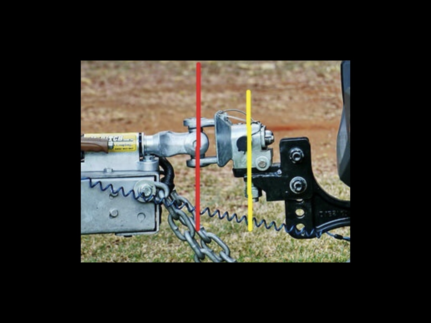

Hi Rob.Whilst I don't believe your overhang figures are accurate,even if they are,the short Rs wheelbase on an LC200 increases the extra weight applied to the rear axle by towball weight.In additiion the almost obligatory use of a WDH on that vehicle will increase TBO,further increasing extra weight applied to the car's rear axle,and then we get the fashionable McHitch,where TBO goes through the roof,figuratively speaking.The 79 with a 2300kg rear axle needs none of these gimmicks.The wheelbase is 330mm greater than that of an LC200. Cheers
The photo shows both the above mentioned devices being used.Stupidity in the extreme,with massive (that word again) increase in weight applied to car's rear axle,as well as introducing ridiculous amounts of yaw.Blind leading the blind comes to mind.

I think an image of a McHitch being used with a WDH hitch is simply a red herring. Neither are being used as intended.
Your repeated pathetic and unsuccessful efforts to discredit me always end up as abject failures,so could I suggest that instead of posting about something you clearly do not,or more likely do not want to understand that you instead research some of the many posts that I have made over the years on the subject,where the basics and the physics are clearly outlined and explained. Several members who initially ridiculed my assertions now have learned that I was correct,and have admitted such. Seems that others are taking an inordinate amount of time to understand the basic physics, and instead of trying to learn,go off on a tangent with their own half-baked theories.My posts are made in an effort to help both a newbie who is keen to learn,and an old bloke who may be set in his ways,to understand weights,but when other,perhaps well meaning people post contrary but incorrect information,it just confuses.Over the years I have helped people to understand their weights,both by PM and by personal visits to their homes.But,like anybody,you are entitled to an opinion,no matter how misguided you may be.But never give up.One day you may be right! Cheers
(Remember Tom? he used to be the technical expert in both Caravan World and Caravan and Motorhome magazines. He was given the flick from both because he published some truths that some advertisers did not like.)
