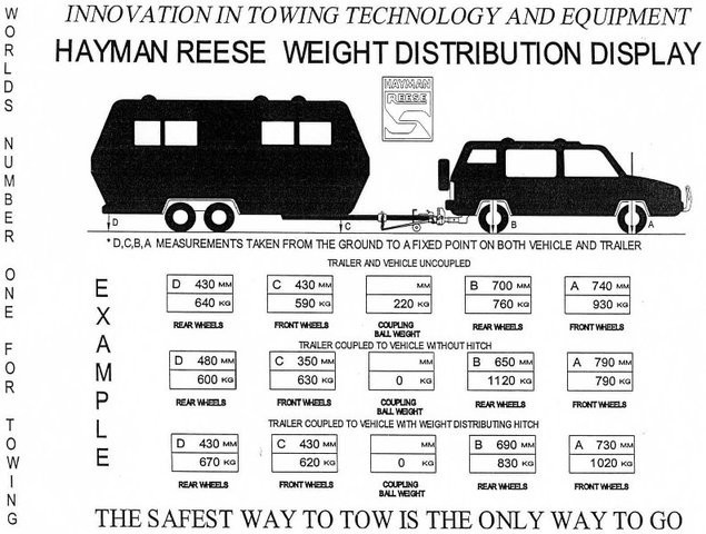

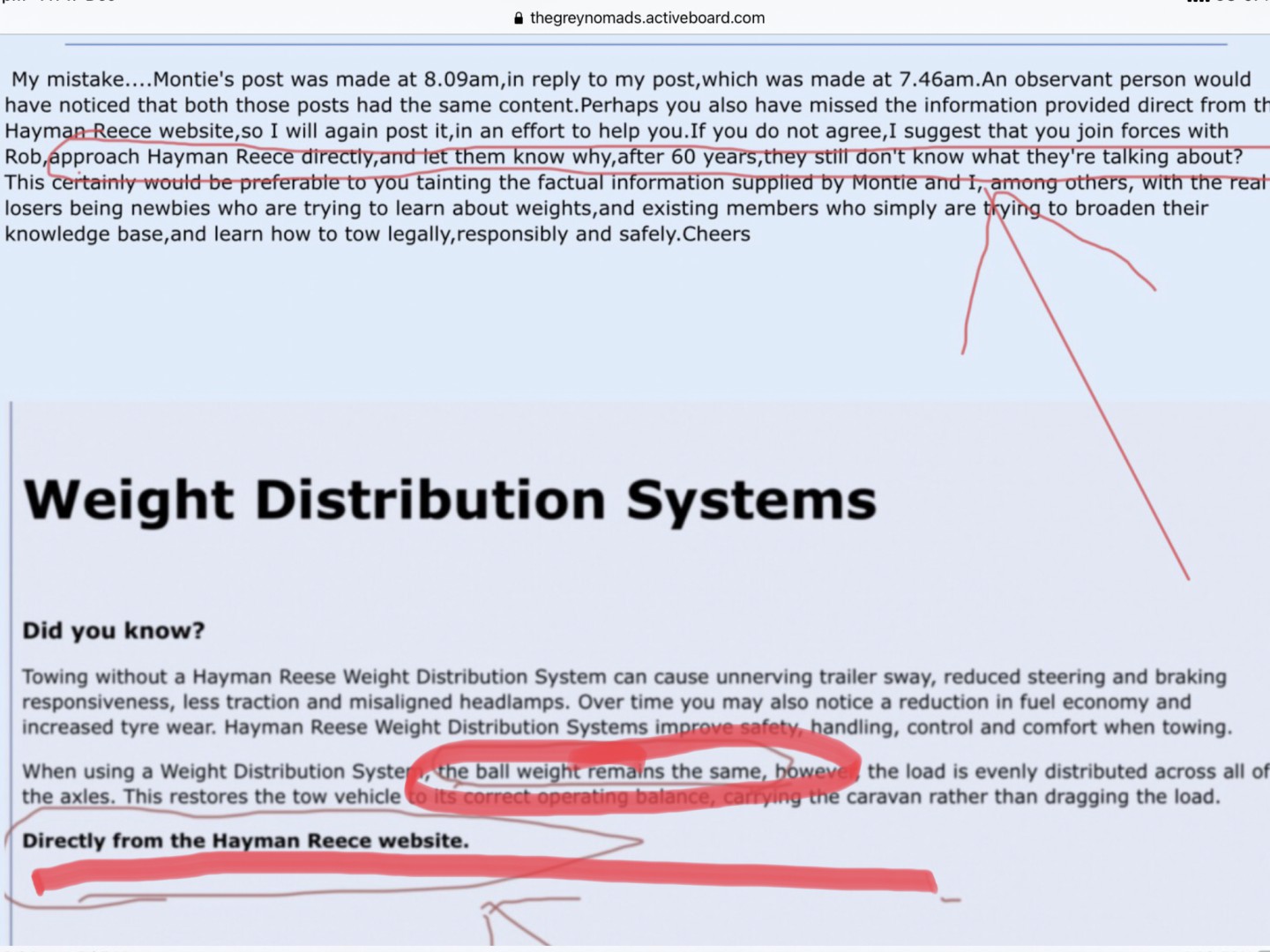

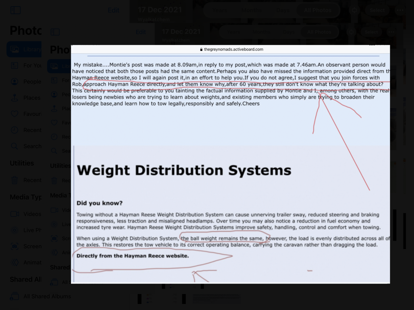

Well, I'm puzzled. According to yobarr, Haymen Reece have been decieving their customers. They are wrong and he is right.
I'll believe Haymen Reece I think.

You certainly arepuzzled,as NEVER have I said that HR are deceiving their customers.All I have ever done is suggest that their illustrations are designed to cater for those people who struggle to understand even basic physics,but it seems that such a simple explanation still is beyond the comprehension of some? C'est la vie. "Zero" ball weight on a PIG trailer? Yeah,right.Cheers

Since the example you refer to is fitted with a fully adjusted WDH the ball weight is distributed to the front axles of the tow vehicle and the van axles it is not unreasonable to expect 0 or near to 0 on the ball. (BOTTOM LINE) It is an example. Or are you unable to read a simple set of tables. YOU DIDN'T NOTICE THAT THE TBW IS TRANSFERED TO THE REAR AXLE, RIGHT? (MIDDLE LINE) It can't be on both axle and the TB. We both know it is transferred through the Axle to the ground. Too simple for you. Eh.

Since the example you refer to is fitted with a fully adjusted WDH the ball weight is distributed to the front axles of the tow vehicle and the van axles it is not unreasonable to expect 0 or near to 0 on the ball. It is an example. Or are you unable to read a simple set of tables. Too simple for you. Eh.
Surely it can't be the case that you still haven't learned that a WDH does NOT change towball weight? Never has,never will. If,after all the time and effort that I have put in to proving this, explaining exactly what happens when a WDH is tensioned,having others understand and accept that fact,you still don't understand,then there is little more I can do to help you.Sorry.Back to sleep.Cheers

Yes, yobarr you continue to blab. Yes it stays the same but is DISTRIBUTED so is shown elsewhere. As it says. But you refuse to admit your error. Blinded by your own arrogance.
Surely you cannot be serious here? "Stays the same but is DISTRIBUTED so is shown elsewhere" you write.What a load of rubbish.Below you will see a definition for "distribute" showing that when something is "distributed" it is "separated into parts". Surely even you can understand (?) that it is impossible for something to be "separated in to parts" AND "stay the same"? For the 700th (+/-) time,a WDH DOES NOT change towball weight. As I have previously said,the chart provided by you,which has been provided MANY times before by other members,Clarky being one,is designed to assist people with little knowledge of physics to understand the workings of a WDH.Seems that no matter how simplified it is,some still cannot or do not WANT to understand.Please refer to my post from 10.21pm yesterday,which is direct from the HR website.You may like to contact them to offer your assistance,and to let them know that after 60 years in business,they still don't know what they're talking about? In case you already have forgotten a WDH DOES NOT change towball weight.Never has,never will. Cheers

oldbloke said
09:16 AM Dec 18, 2021
"WDH DOES NOT change towball weight.Never has,never"
Correct, it is the same. But it is distributed to other axles. And that is what the graphic shows and web site says.

Oh dear you really are lost Yobarr.
I will try to assist you with a very, very simple example.
I have 2 buckets
I place both buckets in the boot of my car.
Bucket 1 has 20 kg of sand in it
Bucket 2 is empty
Sooo, the total weight of sand is 20kg in the boot
I pour from bucket 1 10kg of sand into bucket 2
Now both buckets have 10kg of sand. Note: 10 + 10 = 20kg
I move bucket 1 to the rear seat =10kg
I move bucket 2 to the front seat =10kg
The 20 kg has been distributed into 2 buckets over 2 locations and surprise, surprise the total weight is unchanged at 20kg of sand added to the car. No longer in the boot but on the front and rear seats.
And that my friend is exactly what Hayman Reece is displaying in the graphic and saying on their web site.

Sorry Oldbloke, its you who misunderstood the chart. The towball weight is still 220kg, not 0. The chart just does not show it. (I think your later posts seem to accept that).
What the chart is showing is the weight on the wheels. Only the first line shows towball weight because that is on the jockey wheel. After the van is connected, the towball weight is ignored, and is certainly not zero and should never be zero. But while Yobarr noted that zero weight on the ball was a ludicrous situation, he did not look further.
And Yobarr is correct that the ball weight does not change with a WDH, which is as stated by HR.
Im sure others will be confused with that chart as well. Did that come from Hayman Reese?
Also, I believe the example shows a WDH that has been over-tensioned. From a relatively modest towball weight of 220kg, they have taken 290kg off the rear axle, and put 230 on the front. A bit excessive in my opinion.
By the way . Its spelt Hayman Reese.

Back in Post #2 I suggested we are focused too much on the easily measurable static loads. A WDH does nothing to handling while parked on the weighbridge. What matters is the open road.
Have a close look at the video posted by Peter_n_Margaret where the front wheels of the towing vehicle become airborne. An extreme example, but it is ueful to note that both ute and van appear to be travelling fairly level. So, while parked it would appear to be well set up. The undulation in the road is not noticeable in the video, and the OKA hardly bounces when going over the same spot.
At the moment the wheels become airborne, can anyone suggest what the actual weight on the towball would be? 1,000kg would not come close to lifting the front. Can you imagine what it would do to handling even before the front wheels became airborne? If cornering at the time, the handling dynamics would be changed in an instant, then back again next instant.
The same applies with braking. Just when you need those front brakes most, the weight transfer from the van to the towball must be huge, resulting in less traction on the essential steering wheels.
Now consider if a WDH is fitted. The normal guideline is to adjust a WDH to return 50% of the load back to the front wheels. BUT ....
When more weight is loaded onto the towball and the rear end sags, the WDH tensions more, thus transferring a greater percentage of weight to the front. So, when towball suddenly increases, the percentage of load returned to the front wheels increases. This is how a WDH does such a great job at reducing porpoising, and therefore making a marked difference to recovering lost handling and braking performance.
So, don't just think about static weights while the van is parked. Don't think about the static figure of 50-100kg back to the front wheels. It's what happens on the road that matters.

You certainly are puzzled,as NEVER have I said that HR are deceiving their customers.All I have ever done is suggest that their illustrations are designed to cater for those people who struggle to understand even basic physics,but it seems that such a simple explanation still is beyond the comprehension of some? C'est la vie. "Zero" ball weight on a PIG trailer? Yeah,right.Cheers

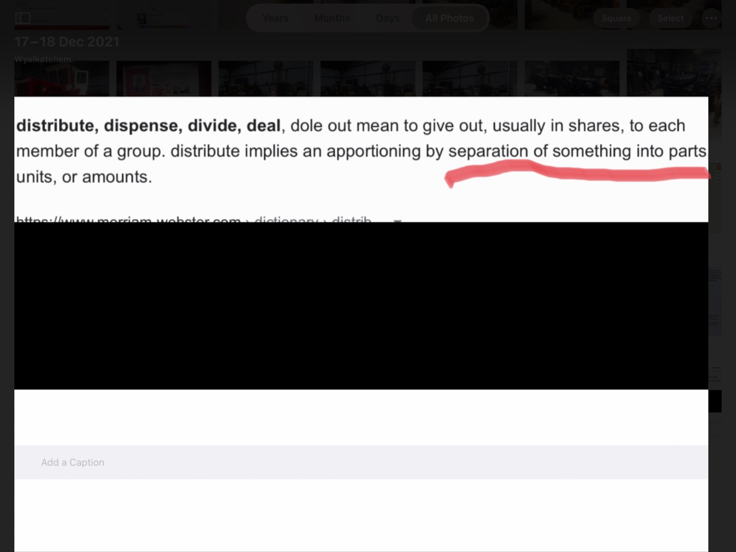

And BTW, I did not insult you. Just stated how it is.

Ian,could I respectfully suggest that you too approach Hayman Reece and let them know that they've been doing things wrong for 60 years.See screenshot below.This topic has been covered many times on this forum,and I have fully explained the facts to the non-believers,all of whom,with one notable exception,have come to understand that a WDH DOES NOT change towball weight.If you care to search on this site for "Effects of WDH" or something similar,you will find much helpful information.Cheers
DIRECT FROM THE HAYMAN REECE WEBSITE.
-- Edited by yobarr on Saturday 18th of December 2021 11:35:49 AM
