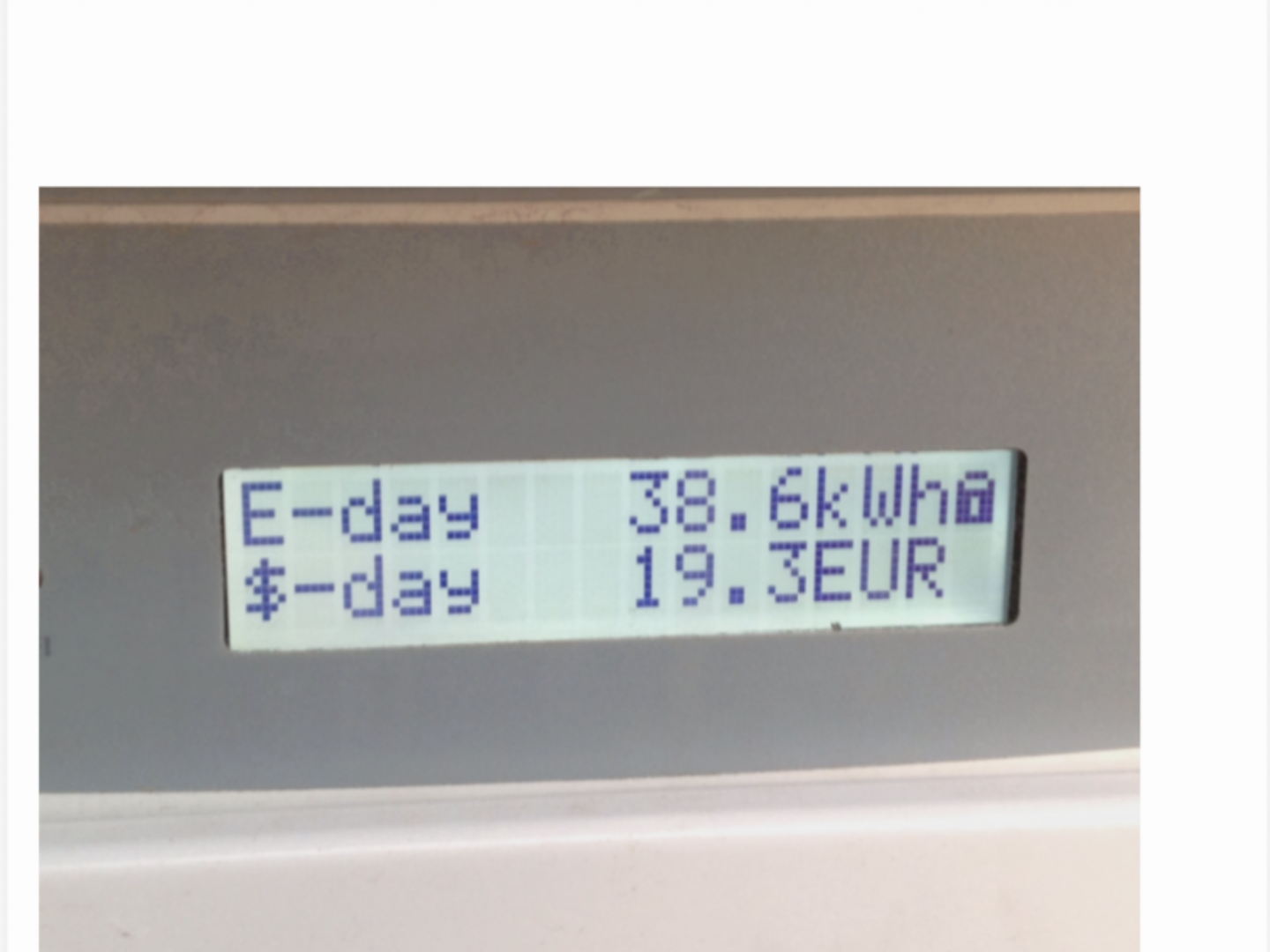

P.S Photo is of daily production of my 6kw system at 3pm.Panels face West,so there still is 3-4hrs of light left to give even more power.(Energy,if you must! Thanks Peter!) Do it once,do it well.You should ALWAYS install as big a system as you can. Not negotiable.Cheers
