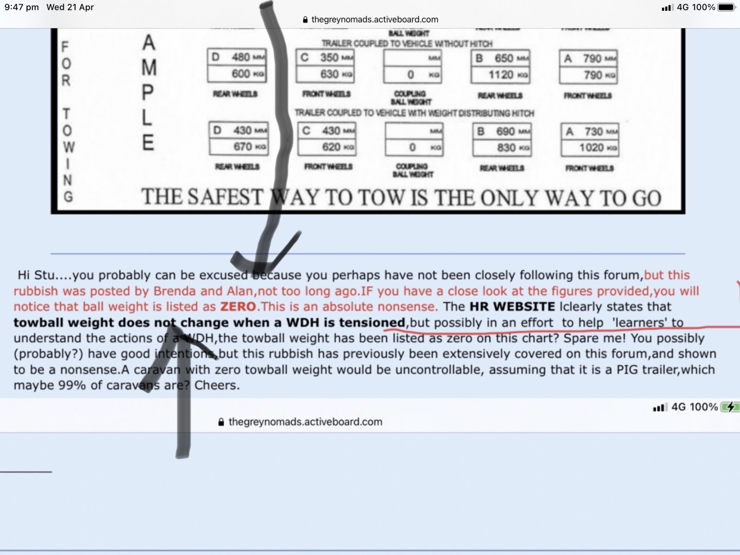

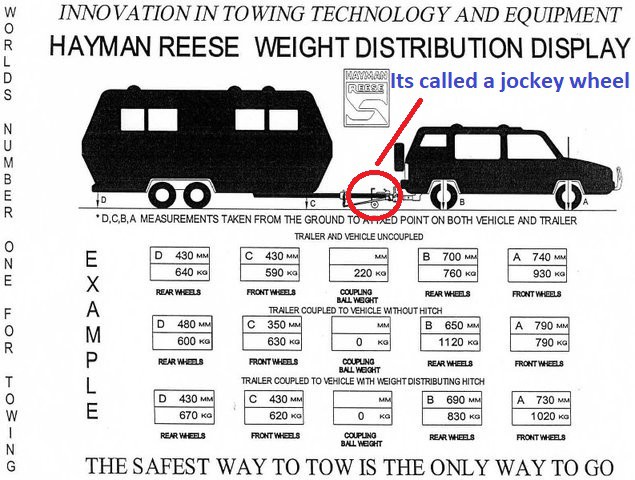

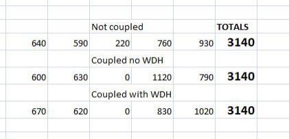

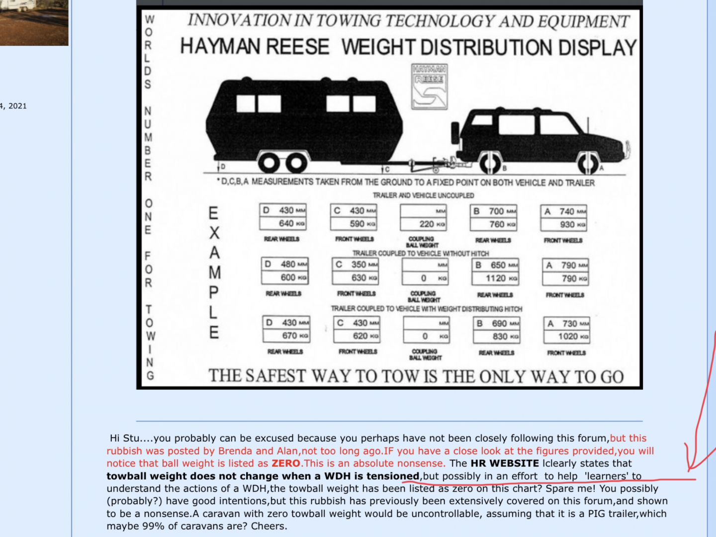

"Reece state "..."ball weight remains the same" That statement is correct. And when the van is connected imost of it is transferred to the rear axle of the tow vehicle.
But some people forget, once the WDH is connected that TBW is gain transferred mostly to the 2 front axles restoring braking and steering.
In that graphic the TBW is shown as 0kg because that weight is no longer transferred to the scale/ground through the jockey wheel. Simples really.
The graphic isn't indicating that there is 0kg TBW. Just no longer on the jockey wheel.
The graphic is 100% correct.

Monty, the graphic indicates the TBW has been moved. Not eliminated.

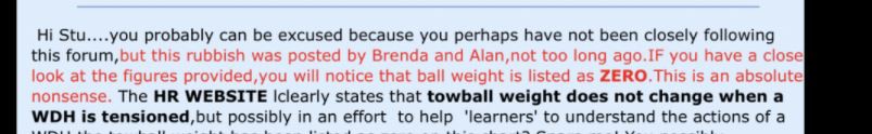

Oh and towball weight is a nonsence as soon as the two units are connected together, because its unmeasurable.
The towball weight NEVER moves...it is NEVER changed by a WDH.Cheers

Yobarr,
The graphic is correct. Think about it. All of them add up the same across the cells.
The TBW has been MOVED. Mate, now try to tell me the numbers don't add up. If you can't see that then you need glasses or learn to add up. Or just admit you made a mistake, But I sure ain't holding my breath for that one.
BTW I suggest you use a step ladder when you climb down off you horse. I wouldn't like to see you break your neck when you fall.
Instead of telling me
"May I suggest you give up? You are so far lost in the WDH wilderness it is not even funny anymore"
Show me where the math is wrong.
Yobarr, the red edit you made above is the "rubbish" The graphic does NOT indicate zero TBW. It indicates the TBW is no longer on the scale/ground through the jockey wheel. If you read it the weight has been MOVED. Therefore, yes, the TBW has stayed the same, but now moved elsewhere. If you continue to deny the above my only conclusion can be that YOU are "lost in space".
When you feel a little better in the morning I will accept you apology.
From this little gem I don't think any of us really need any explanation as to the rest of your theories on a WDH system.

yobarr said
08:25 PM Apr 21, 2021
oldbloke wrote:
Yobarr,
Surely you are not serious? You say the towball weight has been "MOVED".Where do you think this weight has been moved to? The towball weight NEVER moves,and NEVER changes with the use of a WDH.How on earth can it move? It is a downward force imposed on the towbar of the car,and is constant,WDH or no WDH.Back to simple physics class for you,might I suggest? Cheers

Details of weighbridge exercise below.Hayman Reece CLEARLY state on their website that WDH does NOT change towball weight.To help you overcome your apparent reluctance to accept that which is undisputable,could I respectfully suggest that you access videos by John Cadogan,where everything I have said is shown to be true? There is absolutely NO need for me prove examples from reputable companies to be incorrect,because they are not.The problem is that some people simply do not understand the figures,and draw totally illogical conclusions from their observations. For the hundredth time,I will advise that a WDH does NOT change towball weight,never has,and never will.Hope this helps.Cheers

I note he is yet to show where the math in the graphic from Hayman Reece is wrong? Yabarr?
In addition he has ignored my previous post entirely. That's because he is "lost in space".
In addition he would have to admit he has got it wrong after MANY times telling the whole world over the internet that the graphic indicates there is NO TBW, when it actually indicates that it has simply been moved.
You see, he also paid a heap of $ out to get his rig up-graded. Now it looks like he wasted his $ because his steering and front braking is still compromised. In addition he is likely adding even more weight to the Toyota ute taking even more weight off the front axles increasing the risk of an accident. Yet he keeps raving on about safety and how safe his rig is.
Should have just purchased a WDH. Safer IMO.
Simples really.
And heavy springs, air bags or different shockers will never change this basic law of physics indicated above. Known in the science world as a "simple machine".

The weighbridge figurees as previously quoted appear to render your above statement incorrect. These figures are from reputable companies.
Are they incorrect?

Are you serious? I have posted so much stuff from Hayman Reece tgat shows that WDH does NOT change towball weight,that it is becoming monotonous.Again,I will post these two screen shots,but may I suggest that you Google John Cadogan,and view his videos explaining the workings of a WDH.All will then become clear to you...maybe.Cheers
Maybe in the light of day tomorrow you might be able to offer a description as to where the weight in the weighbridge exercise came from when the front axle and the van axle group weights increased once the WDH was connected to the vehicle and trailer.

yobarr wrote:
oldbloke wrote:
For Yobarr,
May I suggest you give up? You are so far lost in the WDH wilderness it is not even funny anymore.You write "...TBW is gain transferred mostly to the 2 front axles..." How many cars have you seen that have 2 front axles? Towball weight NEVER changes with the use of a WDH. Again,I will post details DIRECT from the Hayman Reece website,for your benefit.If you still do not understand,may I respectfully suggest you contact Hayman Reece, and point out their apparent misunderstandings? Cheers
-- Edited by yobarr on Wednesday 21st of April 2021 08:38:22 PM

It is becoming increasingly obvious that this thread is not about towball weight but more about baiting a certain member.
A few posters have now resorted to name calling and personal attacks.
Time for admin to shut it down me thinks.
Rob Driver said
08:36 AM Apr 22, 2021
Clarky 1 wrote:
Yobarr,
Once again you seem to avoid answering anyones questions.
I asked that you might supply facts to support your previous statements from a weighbridge example but you post immediately above really takes the cake and says it all.
A weighbridge example from you would only be fair considering your claims of the two examples from reputable companies is not true.
Your quote..from immediately above..
I hope you got your hole dug today Chris.
Hi Stu
It is obvious that he got the hole dug for himself with that statement above.
Rob
yobarr said
08:40 AM Apr 22, 2021
Thanks Montie,for this post.Already I had decided to opt out,as it was becoming obvious to me that I was being baited.Physics and logic may well confuse some people,but a stubborn refusal to accept facts is pathetic.Cheers

For Yobarr,
Yobarr,
Yobarr,

Why don't you just do your own WEIGHBRIDGE EXERCISE. and prove the examples from reputable companies incorrect by providing us all with a display of your independent results.
Some of us are waiting so come on Chris show us how you may convince us all. We are really all serious.
-- Edited by yobarr on Wednesday 21st of April 2021 09:35:19 PM
Chis, Yobarr will never admit he is WRONG.
Simples really.

Yobarr,
You said this in a previous post within this topic.
The towball weight NEVER moves...it is NEVER changed by a WDH...
So bring on an explanation supporting you claim please.
Are they incorrect?
-- Edited by Clarky 1 on Wednesday 21st of April 2021 09:30:43 PM

Yobarr, you can apologise to us in the morning, mate. When you learn to add up.
