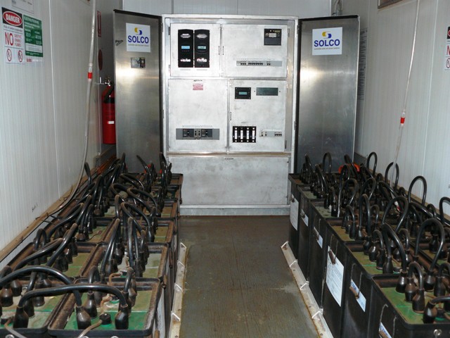

My daughter and SinL have an off grid house powered by about 3.5kW of solar and gas for heating.
Their batteries are these 2V wet cells.
When they were 9 years old, one cell failed. It was replaced for no cost under its 20 year warranty.
Expensive when purchased. Probably weigh a couple of tons. Not the battery of choice for the RV.
This is half the battery system on a station we spent time on in 2008. 2V wet cells.
Perfect for static locations.

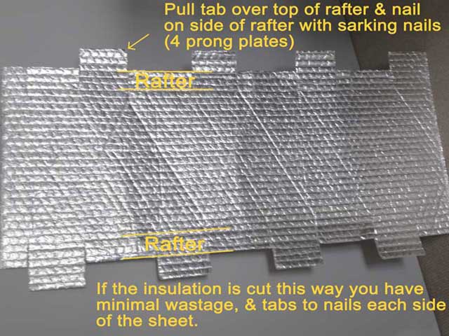

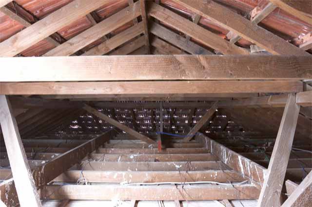

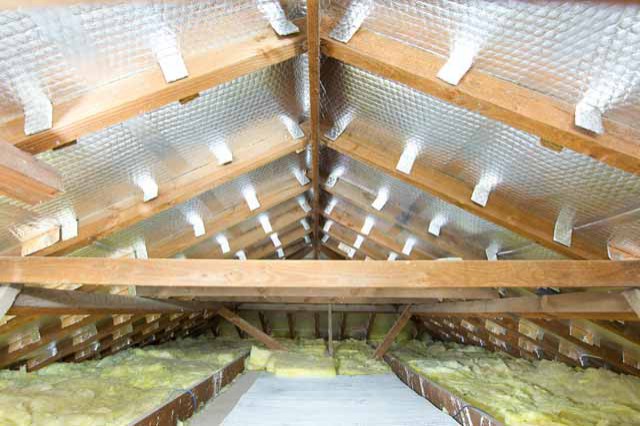

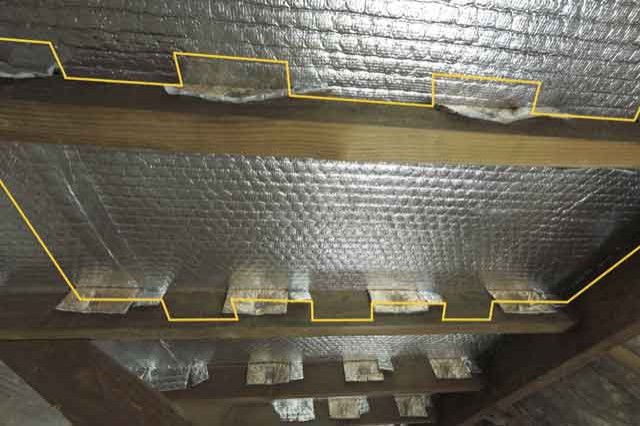

Part of our long term energy reduction planning was installing insulation. Our 1950s block of units had no roof or ceiling insulation.
I got up there & vacuumed out the roof space, cleaned on top of every rafter & vacuumed the under side of the roof tiles. Being at the waters edge everything was covered in salt & felt damp.
Retro fitted Aircell (now Kingspan) under the roof tiles & installed ceiling insulation. Have installed more since these photos.
Templates I created after a lot of trial & error.
But people have different priorities, a very expensive kitchen or home theatre & stuff the non visible quality of life improvements.
We have spent time & money but now our energy costs are pretty reasonable.

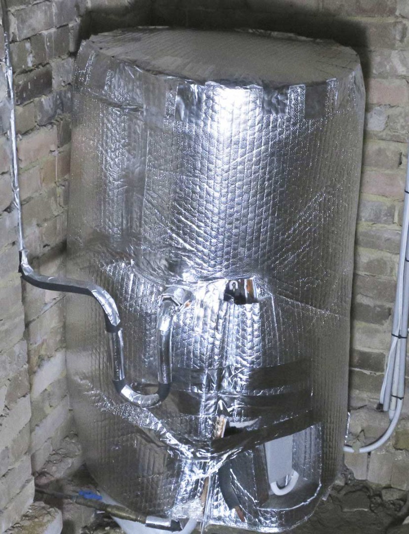

Also insulated the hot water system, reducing its daily Australian Standard heat loss from 1.67kWh to 0.95kWh. An inner & outer layer of Aircell & R4 polybatts in between.

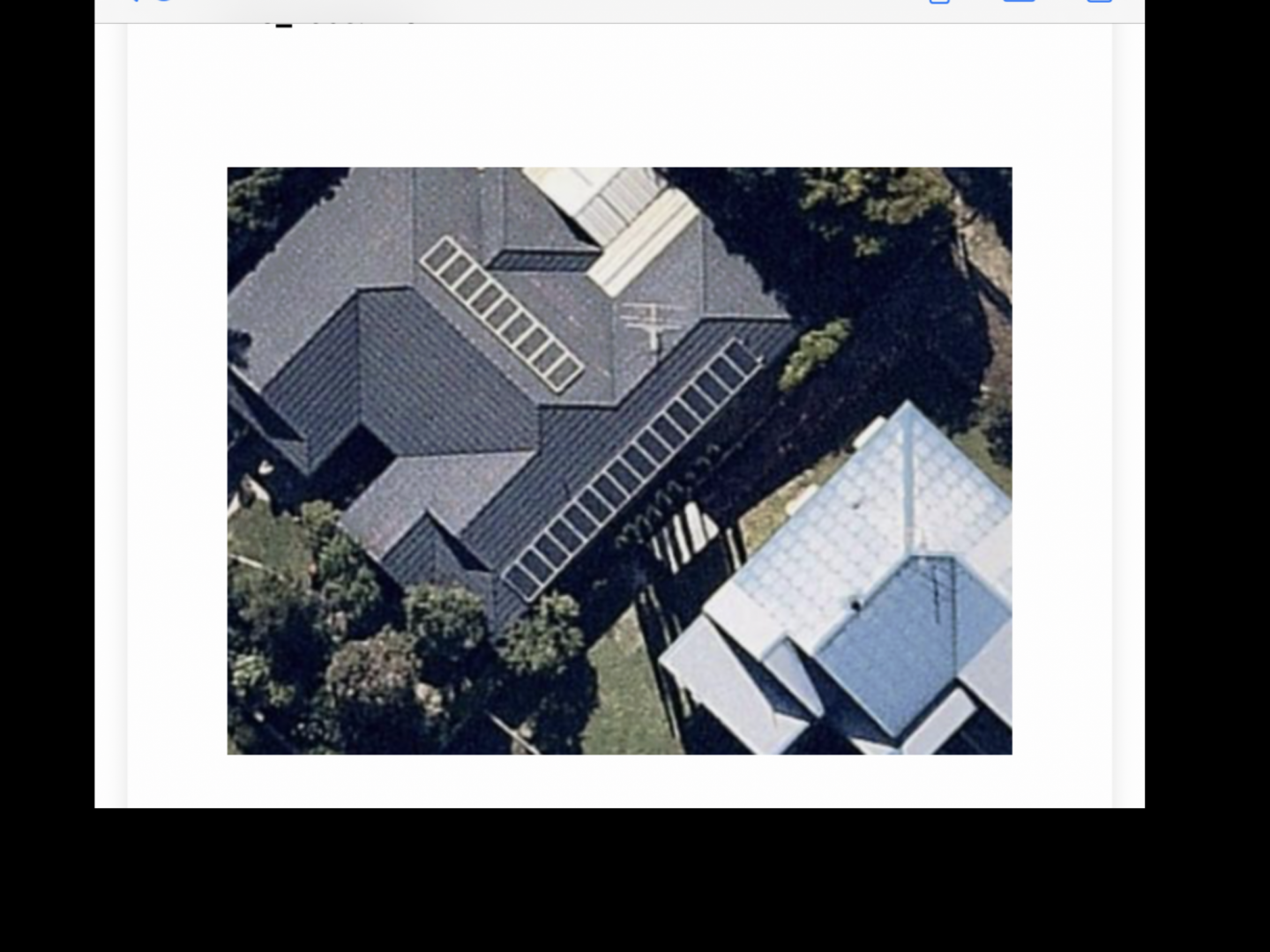

I have a near flat garage roof which could have accommodated the 6 kW array, but about a third of the panels would be in shadow from the main house roof. So I opted to cut back the installed capacity to about 4.6 kW. Now, the salesman for this company was utterly ignorant of the technicalities of the system. In fact, the whole company was shonky in my opinion, but I now have the second array mounted on my garage roof. It is almost horizontal (minimal fall on the roof). Salesman said that these days, the solar panels are not sensitive to sun angles etc. Utter crap! ...Agreed
At noon in mid summer, on a cloudless day, I can get about 3.8 kW from the panels. This is from an installed capacity of 4.6 kW. .
This is a common misunderstanding as the output from the system is determined by the inverter.It would appear that you have inly a 3.8kw inverter? Check the spec sheet.With a 6kw+ system,the biggest inverter you can use on single phase is 5kw,but it will easily handle 6kw+. (I am well aware of the exceptions,but I am talking in general terms.)
So,setting the panels at the appropriate angle is critical, despite what the salesmen say. I am not complaining because I expected this discrepancy. Our summer production now covers the daily connection fees and energy consumption for the winter period, so effectively we have no electricity bills,despite my wife running the heaters 20 hours per day during winter.

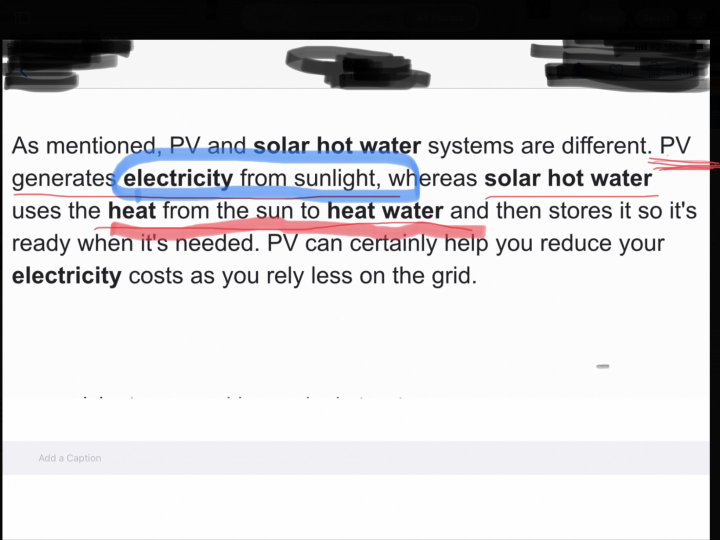

If you want Solar hot water, put a solar hot water system in. They occupy about 2 sq metres of your roof, which is about the size of one photo-voltaic panel these days. Solar insolation is about 1 kW per sq metre, so 2 sq Metres will be enough to heat your hot water over the period of the day. The solar panels are about 15% efficient, and to get the same amount of energy into your hot water is going to require something like 6 or 7 panels of photo-voltaics. So if a salesman comes to you with teh proposal to install photovoltaics panels to heat your hot water, run the other way as fast as you can...

Hi Robert...As well as manufacturing the vast majority of panels,China also makes some of the best.Taiwan,South Korea and Singapore also make good panels,but the difference in quality and performance is negligible. Without getting too deeply involved,it is clear to me that you have been ill-advised on several fronts,with roof-pitch being one of them,and inverters another.With North-facing panels,the difference in production between having 15 degrees pitch,and 35 degrees,is only 2%.Your Solar performance problem is easily solved,but since you seem to have things well under control,I will opt out. However,may I strongly suggest that you find someone who not only knows about Solar,but has your best interests at heart.This clearly has not been the case with the people who sold you the two systems you have.There is much trickery in the Solar industry.Unless you are willing to explore evacuated tubing,forget Solar Hot Water where you live.I wish you well in your endeavours. Cheers
P.S You cannot compare Solar electricity with Solar Hot Water.The first uses SUNLIGHT to generate electricity,while the other uses HEAT to do the job of providing hot water,so they are next to useless in colder areas.
-- Edited by yobarr on Saturday 27th of February 2021 06:03:32 AM
Yobarr: I was well aware of the differences in mechanism of converting the energy, and this is the reason I would not use PV panels to heat the hot water. Yes - I reckon I was conned - certainly with the second array. When the installers came, only one spoke any English, and he still didn't put the panels where I wanted them (I wanted access to be able to clean the panels). I can clean them, but it isn't easy. I reckon that if I called the Immigration Department, at least 3 of the 4 people involved in the sales/installation of the second array would be on their way back to wherever they came from. The overall money I paid was however very cheap and I am not that for of having the second array recoup my initial expenditure.

Our system is 5.2kW. It gets some shade in the mornings. They are mounted at just 5 degreed because that is the roof slope. In summer it typically produces a little more than 30kWh. Our daily consumption (from all sources) is about 8-9kWh, a little higher in winter with the electric HWS booster. Even in winter it is unusual not to collect that much.
-- Edited by Peter_n_Margaret on Thursday 25th of February 2021 10:34:12 AM
