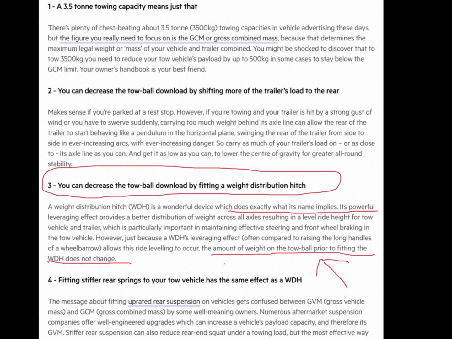

Yobarr I give up on you. Can you not just say you were wrong and a WDH does in fact reduce the load on the tow bar. Instead you go on with a lot of waffle and virtually concede.
Alan
montie said
09:38 PM Feb 11, 2021
Alan
Alan,
I repeat, The fitment of a WDH does not change the ball weight.
A WDH distributes the weight from the tug rear axle to the front axle and the van wheels. It doesn't change the download weight at the coupling.
yobarr said
09:46 PM Feb 11, 2021
Alan
Alan,I struggle to understand how anyone can continue to argue against the indesputable.Perhaps you are being mischievous,but little of what you say makes any sense.Here again is a small portion of the evidence provided in our response to your illogical posting of May 6,2020.Could you perhaps take a little time (long time?) to actually read and absorb the information contained within? Good luck.Cheers
P.S Please note that this simply is part of a list of the "....top 8 Towing myths busted".
-- Edited by yobarr on Thursday 11th of February 2021 09:58:46 PM
-- Edited by yobarr on Thursday 11th of February 2021 10:14:11 PM

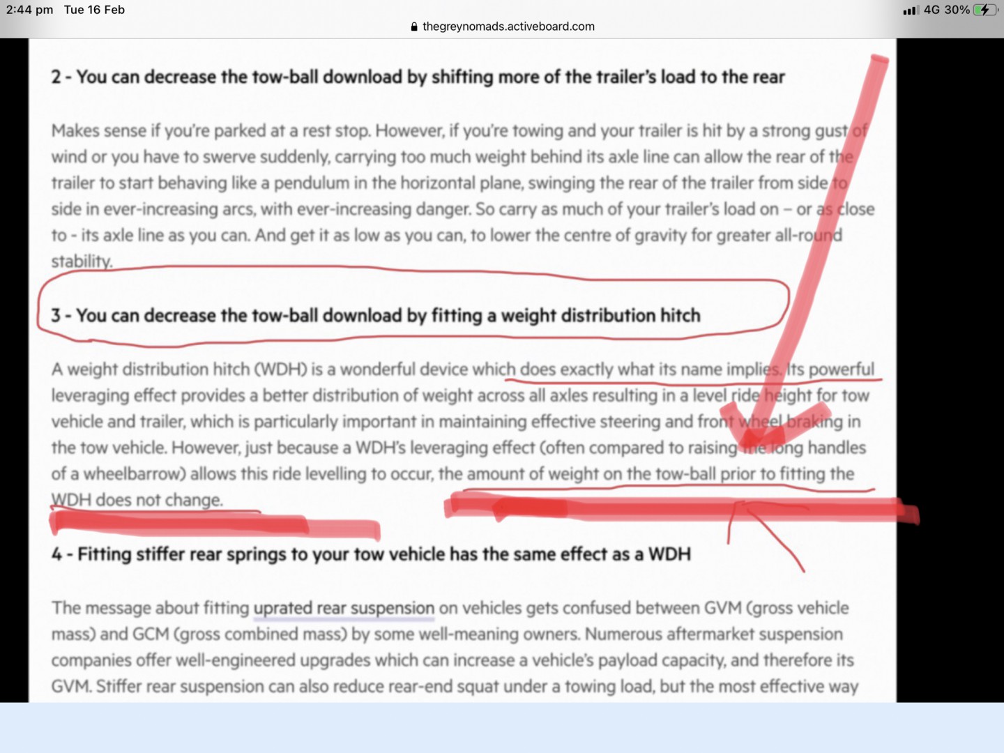

Put simply the ball weight is applied to the towbar which impacts the rear axle weight. Weight is then distributed from the rear axle to the front axle and van axles. Ball weight does not change.
yobarr said
03:03 PM Feb 16, 2021
Alan,just in case you missed the story,I have again highlighted the relevant facts for you.Please READ and ABSORB this information.Your mistaken beliefs,and stubborn refusal to accept the indesputable,does not bother me too much,but I am concerned that the rubbish you post may mislead newbys,or others simply looking for help with their setups,to their detriment.Montie and I,and a couple of others on here,have much experience with weights,and always we try to help others.Your contributions to this topic are of little use.Cheers
A WDH does NOT change towball weight....
-- Edited by yobarr on Tuesday 16th of February 2021 08:18:34 PM

There is far too much written about Towball weights, towball weight is a static weight measured at the trailer/caravan coupling.
To get an accurate towball weight requires a more than an eighty dollar set of towball scales, if you get you trailer/van level on a level surface then the weight is as good as you can expect, even using a weighbridge has a 20kg + or - variation. If you want an accurate you will need to find a specialist with proper calibrated devices.
Connecting the tow vehicle and van together, If the towball weight is within the tow vehicles manufactures reccomendations and the towbar compliance plate, then the towball weight becomes irrevelent as it is part of the Gross Combined Mass, therefore nothing changes even when using a weight distribution hitch as it is nolonger a measurable weight.
Alan,since you are completely lost here,in an attempt to offer you help in understanding how a WDH works,I have spent much time analysing your many,varied and incorrect posts on the topic.Finally I think I now have found where you are lost? You seem not to understand that,when applied to the car's rear axle,towball weight is multiplied by around 145%,dependent on TBO and car's wheelbase etc.Thus,a 350kg towball,for example,will put over 500kg onto that car's rear axle.When a WDH is used, not only is TBO immediately increased,but straight away even MORE weight (perhaps 40kg?) is applied to the car's rear axle, worsening an already bad situation.NOW,when the over rated universal cure-all WDH is tensioned,weight is removed from the car's REAR AXLE, and distributed to the front wheels of the car,and also to the van's axle group.Towball weight DOES NOT change ......ever....but the van's GTM has increased, as has the van's total weight.Not only has the weight on the car's wheels decreased,it also has been distributed differently.As a last resort,may I respectfully ask you to study and learn from the many responses you received to the post you made on May 6 2020. For your own sake,I hope this helps you.Cheers
-- Edited by yobarr on Friday 12th of February 2021 11:43:31 AM
Hello Yobar,
I would be interest to see your calculations supporting your statements made above.
Cheers Bob
Hi Bob.....happy to help,if you could tell me exactly what you would like to know.There are many calculations involved in providing my figures, and a detailed explanation would take me a long time to provide. Cheers
Did you not notice that there is no scale under the tow bar. Haymen Reece would have been better to put in a dash instead.
Please take careful note that the weight on the cars axles after WDH tensioned is 1850 KG an increase of only 160Kg over the initial weight of the car alone and vans axles are now 60 Kg heavier. Total weight 220 Kg. This is the total original tow ball weight. Since the increase in car weight is only 160Kg and it only come from the load on the towbar, then the load on the tow bar is reduced to 160 Kg when the WDH was tensioned. Also note that the vans laden mass has indeed not changed at all. Load on axles plus 160 Kg on tow bar is the same as when the van was weighed alone.
Alan

Montie this is precisely my point because as the figures show the weight transfered to the van axles equals the reduction in tow bar weight. Ball weight has indeed been reduced.
The original tow ball weight is a force acting downwards on the towbar but is opposed by the force of the tensioned spring of the WDH which acts upwards on the tow bar, why would it not reduce the tow bar load along with the other shifts in load that it brings about.
Alaan
Hi Alan....When first you started presenting your incorrect "theories" on the effects of a WDH,I quickly decided that you were,in fact,serious,so I went about trying to illustrate to you,your mistakes.This seemed to achieve little,and when you again made posts containing faulty reasoning,I concluded that you were simply having a bit of harmless fun,at our expense.However,your renewed round of rubbish has me again thinking that you are indeed serious. Because I am not flash on "links" and other computer stuff,I cannot download this video,but perhaps you could access it on your computer,or somebody could be kind enough to put it up here? The video is by a chap named John Cadogan,who holds an Engineering Degree,and it primarily is about an "uninformed Dick" (his words) who claims that a WDH changes towball weight.John explains why this is not true,and goes on to explain why using a WDH is like using a "...Band-Aid on a much bigger problem". Suffice to say that there is little hope for those who,after watching the video, STILL do not understand that a WDH does NOT change ball weight.All useful information is contained in the first 19 minutes of the video,with the last 8-9 minutes discussing a completely different topic.After all the help given to you by Montie and I,amongst others,confirmed by the information in this video,I sincerely hope that you now have learned that a WDH DOES NOT CHANGE TOWBALL WEIGHT . If not,there is little chance of any of us being able to assist you further.Good luck with your learning.Cheers
