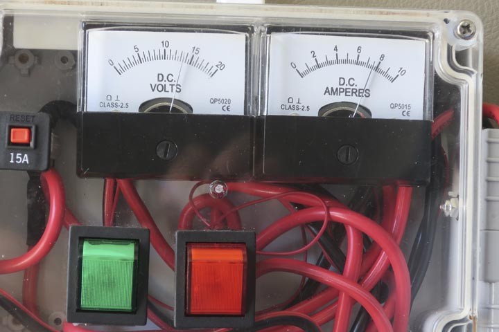

I recommend a couple of panel meters. The voltage is for the batteries & the amp meter is the raw voltage from the solar panels (this was temporary for a test with the 6 x 20w panels in parallel). My controller provides the output via Bluetooth to the phone. The analogue meters you can read as a glance. I have compared them with my DC clamp meter & they are spot on.
Thanks for all the help people. I am going to try the 20amp charger keeping in mind I may have to upgrade in the future as I have 300 Ah of AGM.
My panels are not ideal as 2 will be flat, 2 will be angled one side and the 5th angled the other side. Now depending on the van position catching morning sun, midday and afternoon, will be interesting if it can keep up with charging demands. I thinking I may end up with the Victron www.mygenerator.com.au/victron-smartsolar-mppt-100-50-charger-controller.html, The Bluetooth would be nice. Time will tell.
How do you know your clamp meter is accurate?

I have 2 cheap multimeters 10amp max, both work very well for the price. A couple of 10amp panel meters. 2 Victron MPPT Bluetooth controllers 10 & 20amp. DC clampmeter.
Over the years, double checking the readings & cross referencing, they are all plenty good enough for the task.

I have several meters multi and panel. As I no longer go to work I thought I would get a personal calibration unit a couple of years back. This is one currently sold on Ebay. https://www.ebay.com.au/itm/163897196659
It provides 4 voltages, 2.5, 5.0, 7.5, 10.0 V and has a rechargeable battery from a USB port. It has a designed 'calibration chip' in it and a circuit designed to provide stable repeatable voltages. Beats guessing and with a calibrated voltage meter, you can run currents through a 1% resister to check current accuracy.

I have done a lot of work around calibration over the years; it is a complex and much misunderstood subject even to most engineers.
Fortunately, for most domestic work, then providing your measurement equipment is within +/- 10% it doesn't generally matter.
