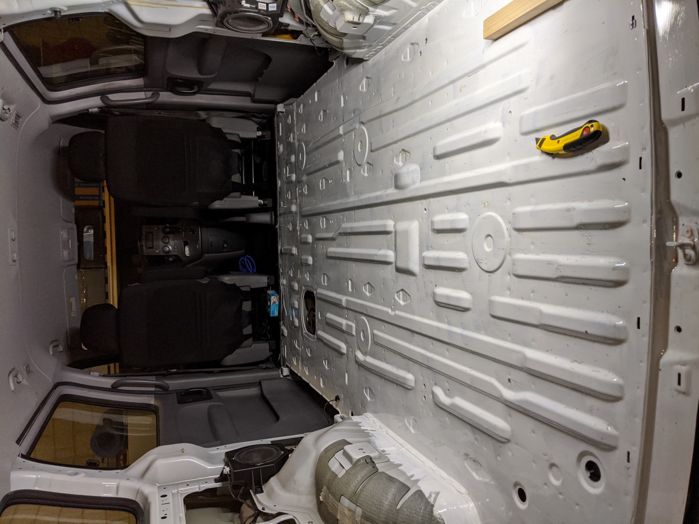

ok cleanup time stuff it, removed whole back carpet section
befor
after
going to paint white rust over back. dont really need to, but peace of mind & protection. havent decided if i'll do another cleanup (get the last bits) or just paint it. too nackerd :)
going to take off the moulding again (for the painting) then decide. dut dut darrrr...

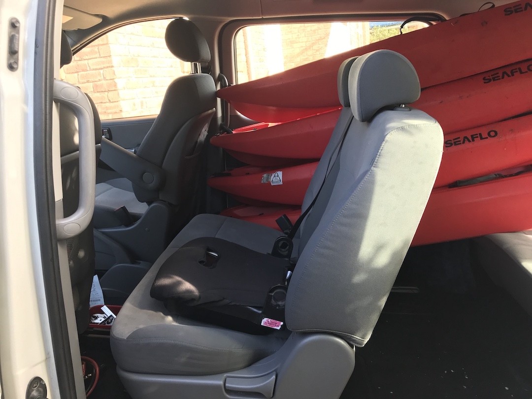

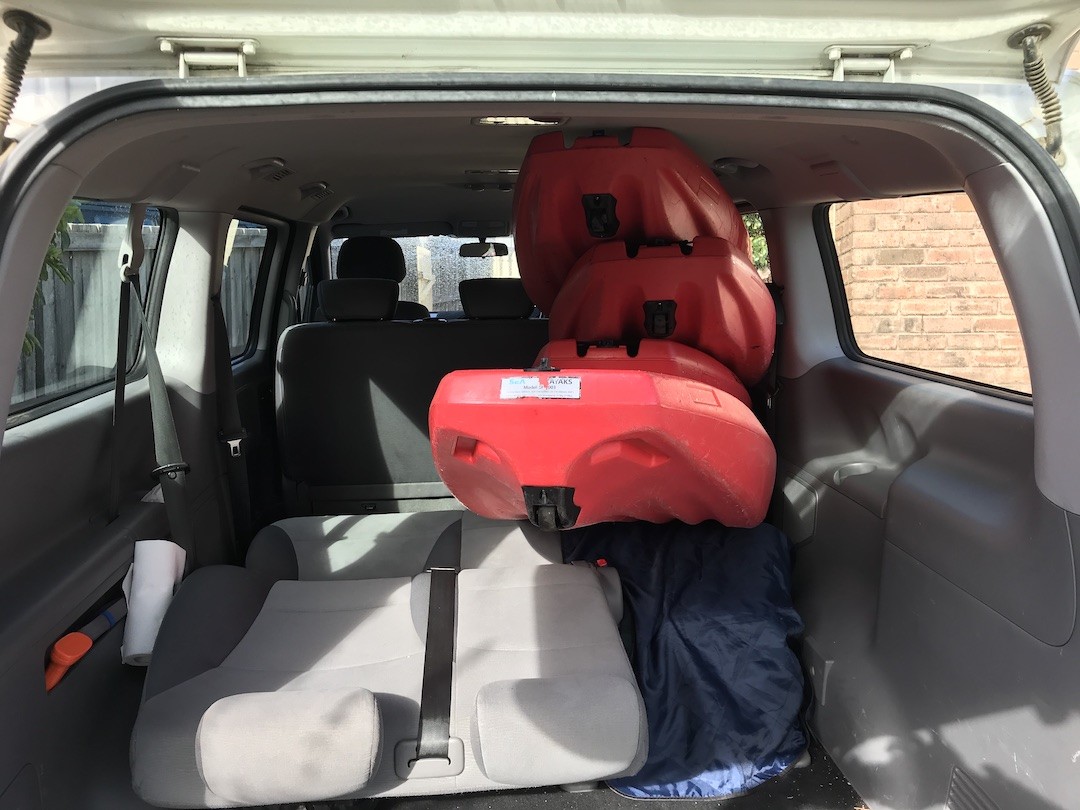

Thanks for your reply Mungo! Once my kids leave home, I'll stop being a bus driver, rip out all my seats out, and do something similar to what you've done :D However, in the meantime, I've removed the single sliding seat so I can now fit 4 kayaks!
Unfortunately, it means I can only just fit 4 people, which is problematic as we're a family of 5.
I could fit 5 people if the rear seat had separate backs... Alternatively, perhaps I could put a 2 person seat in the 3rd row, although that would require me to get it certified (prohibitively expensive?). Do you still have any of the seats you removed?
-- Edited by AlexS on Monday 20th of July 2020 06:58:43 PM
sorry, no. got rid of the seats. You havent looked into roof racks? one of the advantages of an Imax/iload (and reason I got one) is low roof height. unless you have a Lowwww garage, you should be able to roof rack and kayaks 2 high. (2x2 or even 3x1) family of 5 but 4 kayaks? (3x2) :)

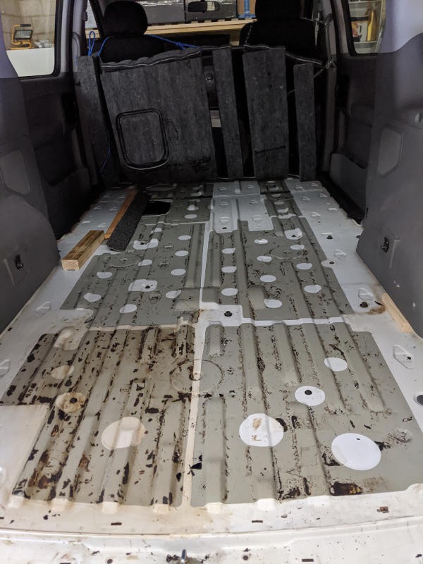

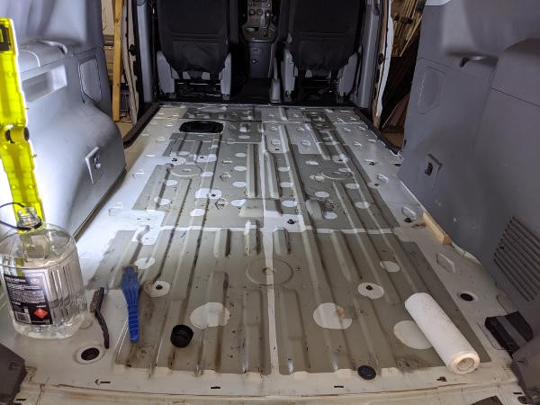

ok cleanup time
befor
after
nar 1 coat will do, going to cover it anyway :)

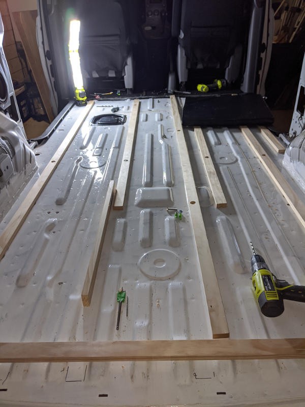

decided to rivnut the wood supports
Had some center points from a dowel kit, but didnt stand or fit, so I made my own (the green stuff) out of a 3d printer I just got to experiment with (worked great) :)

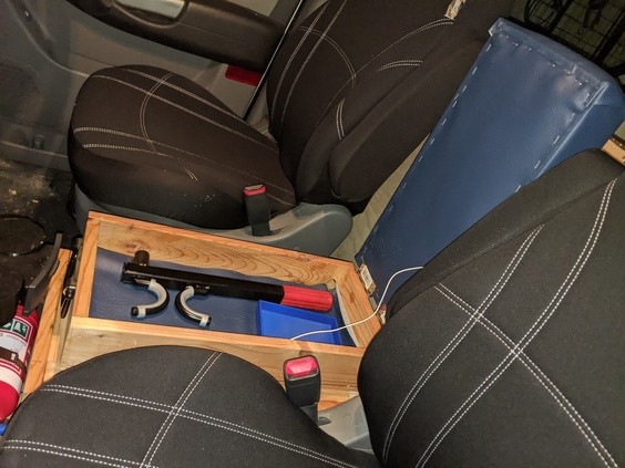

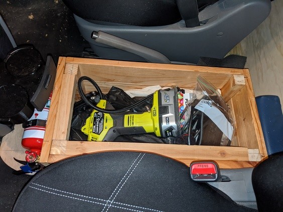

Latest is making a central console (org thought the gap was cool, but really just a waste of space)
-- Edited by MungoTheB on Tuesday 21st of July 2020 01:59:35 AM

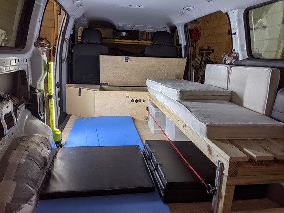

about time I added here (for my senility later :)
problem with grand ideas, but subjected to time, money, resources, lack of skills is you get to a point where you just want something in :)
I'm still mainly using it as a bike van, weekender, family mover vehicle :)

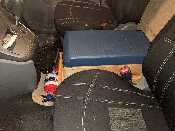

The console (base plate +2 levels) as I found the gap more useless than convenient
the rear, still not decided on the sides yet.

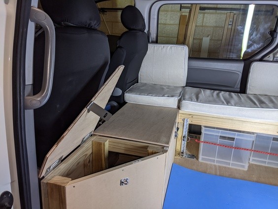

The Storage

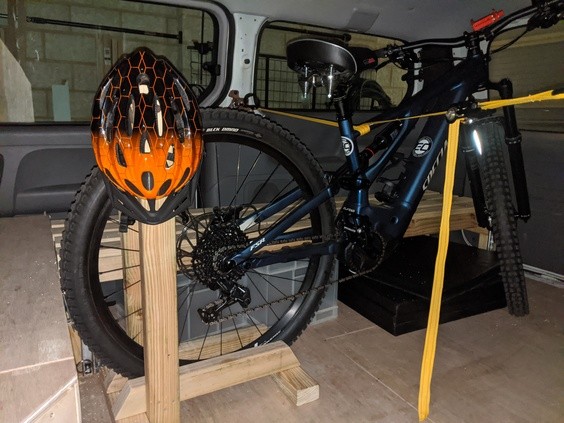

The bike rack :)
Me (hate photos, but I have to prove it was me that done it (you can see the bike in the background :)
My first build
LOTS of mistakes
DONT use 12mm ply USE 18mm (better selection of bolts, screws & work area)
most was put together with odds & sods (LOTS of room for improvements)
Still need to rethink & improve (but aleast I have some basics in)
dont know why I cant paste 1 pic in here, but attached anyway and may as well add them all to one :)
-- Edited by MungoTheB on Tuesday 6th of October 2020 01:18:32 PM

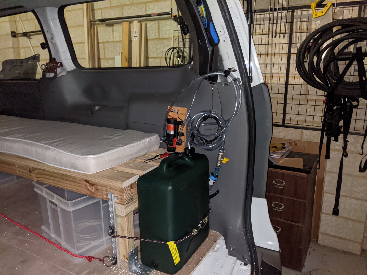

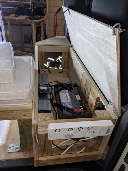

water system in :) will work out howto pretty up later
