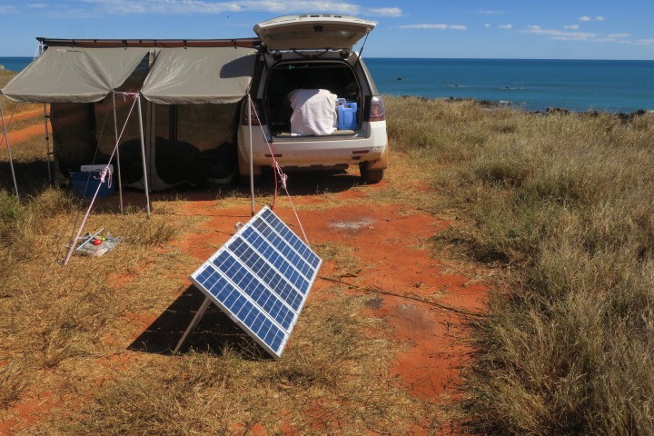

Nothing fancy just 300watts of portable solar with the regulator on the panels, 5m 10mmsq extension lead. Works perfectly.
