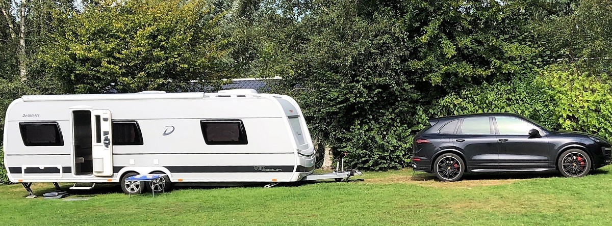

I have Dutch friends who have this 10m caravan (32feet?) and they tow it at speeds up to 130kph behind their Porsche. German built. Its total weight on the road is about 2.5T 10% ball weight? I don't think so!
There are some short videos clips on these & it would bring tears to your eyes to say the least! Land Rover have them as well.

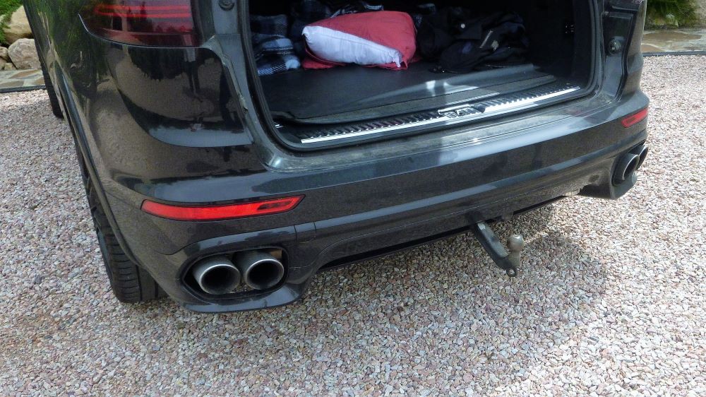

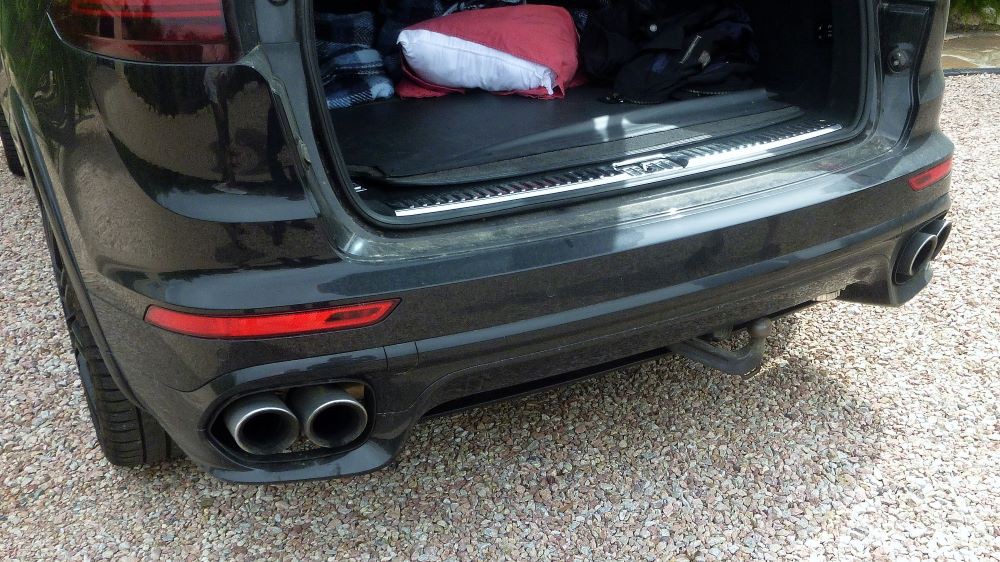

Where is his tow ball ?
Good question.
There is a button in the boot...
Discovery Sports motorised tow bar:
https://m.youtube.com/watch?v=KTbJjZvq5jE
