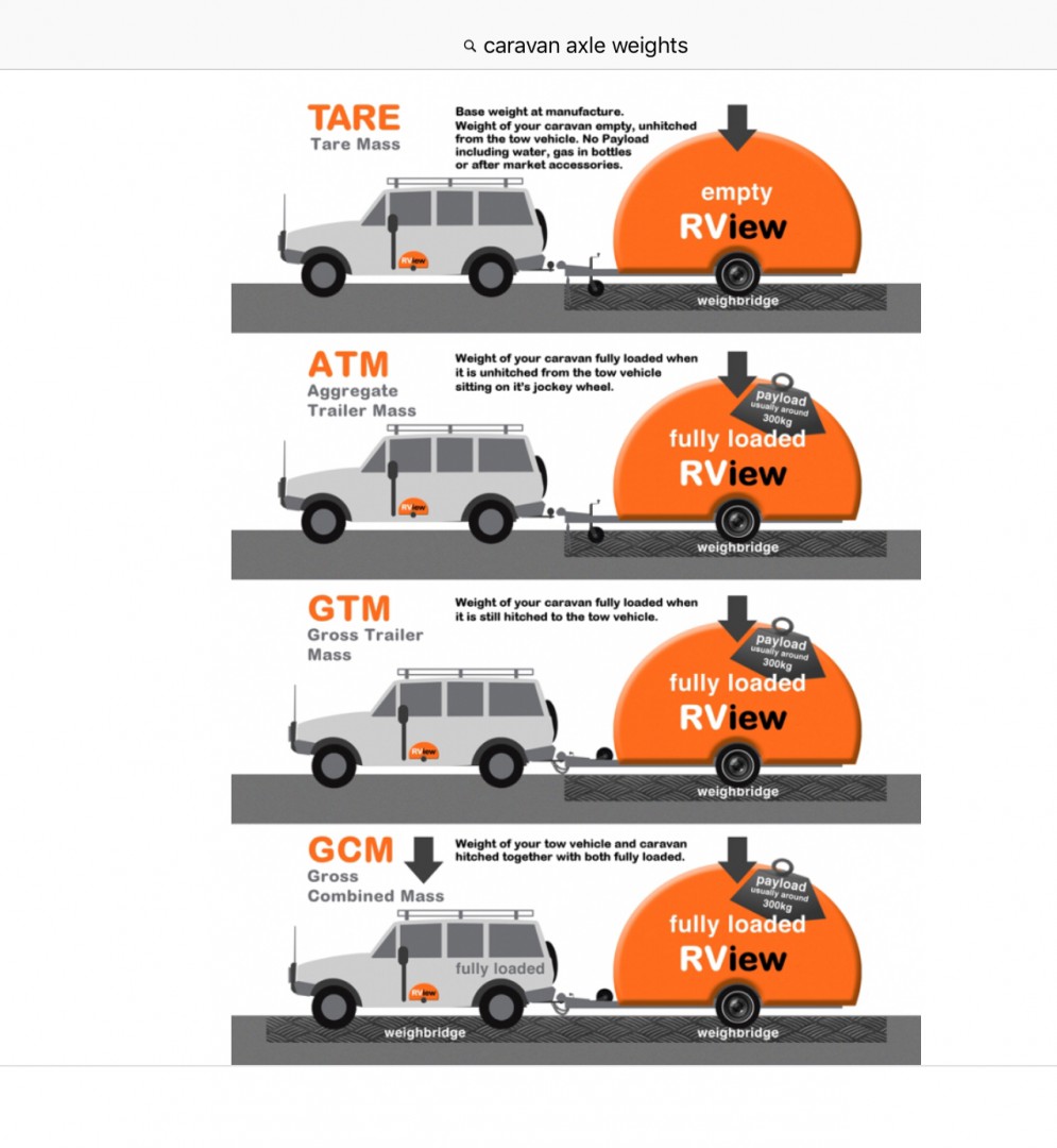

This is how it was explained to me
ATM is the total weight of the loaded trailer when it is NOT attached to the the vehicle.
GVM is the complete mass of the loaded vehicle.
GTM is the weight of the loaded axles on a trailer
GCM is the COMBINATION of all the weights that make up the entire total weights of all trailers and tow vehicle.
GVM plus GTM equals GCM.
The important word in all of this is COMBINATION.

Here is a very simple weight chart which says it as it is GCM is just that. When the complete unit is weighed in a loaded state then that is the GCM. If the GCM has been upgraded and approved legally then that is what the new figure is.
Please read all of my original post on this topic and probably then read my subsequent posts. If you do some enquires you will find that a GCM approved figure is just that...the vehicle has been modified and approved to have the stated GVM and GCM and be used legally on the road.
There is no smoke and mirrors with GCM it is just that Gross Combination Mass of a loaded vehicle ready for travel. See the chart.

It obviously makes no sense to you but can you please tell me this.
GCM is the weight of the vehicle and the and the trailer while connected, do you agree or disagree?
Travelyounger has had a legal upgrade for GVM and GCM by an approved manufacturer, do you agree or disagree?
Travelyoungers GCM is under his NEW allowable GCM and his vehicle GVM, do you agree or disagree?
Travelyounger is now travelling legally and with his upgraded vehicle specifications, do you agree or disagree?
The weight chart in my obove post is correct, do you agree or disagree?
By answering yes or no to those four simple questions it will then provide some understanding to rest of our interested forum members as to where your problems are with this mans vehicle combination.
You are now confusing measured weights with a Rating. You cannot weigh the GCM, you can only weigh the tug and van combination and compare it with the rating.
FYI and this is the current legal weight situation:
The measured weight of the attached van and tug combination cannot legally exceed the lesser of the following:
1) The tug or upgraded rating. (7100kg)
2) Tug GVM plus Van GTM. (3600kg+3150kg)= 6750kg.
In this instance thelesser is 6750kg which is legally the most his combination can weigh upgrade or not.
I may be stating the obvious here but GTM is the difference between ATM and measured ball weight which I have taken at 350kg or 10%.
To even simplify it further if you hook the fully loaded van 3500kg to a fully loaded tug 3600kg you will transfer 350kg to the already fully loaded tug pushing it overweight by 350kg and illegal.
