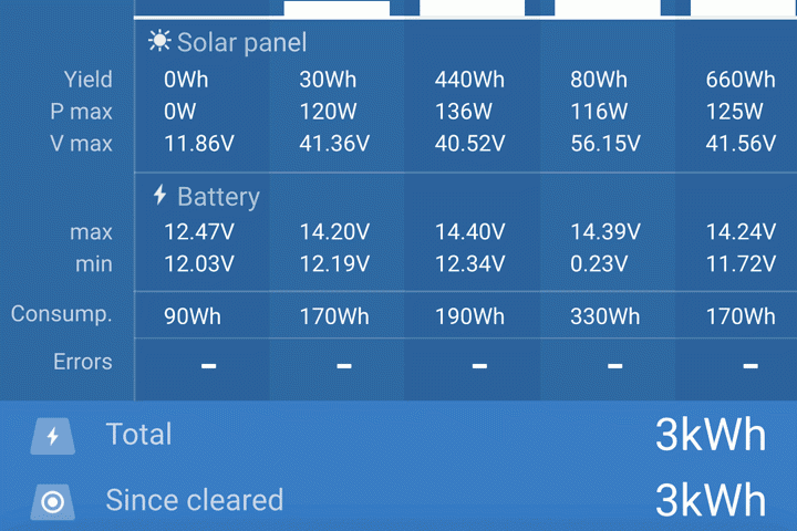

Back on to the very tiresome task of watts! A few watts on consumption for the last few days. Ambient temperature 27C, pretty steady as the car was closed & in an insulated garage.
170 Wh: The fridge set at -22C but not a full day.
330 Wh: The fridge set at -22C for 24 hours.
190 Wh: The fridge set at 2C for 24 hours, including equalizing from -22C (opening lid!)
170 Wh: The fridge set at 2C for 24 hours second day.

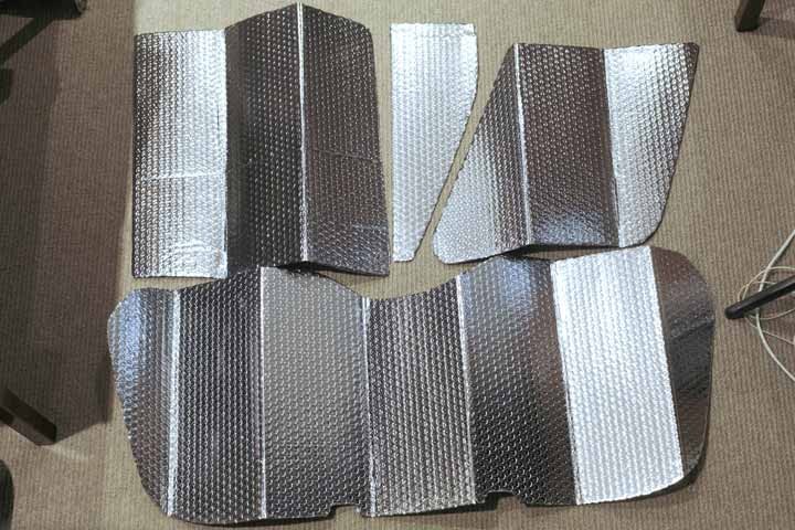

We have wind deflectors on the car & leave the windows open a touch in really hot weather, make a big difference with a bit of air flow.
Often we don't run the fridge when the car is closed up, & cover the fridge with doona & sleeping bag. Makes a big difference in slowing the fridge warming up.
Also have cut up some windscreen sun shades for every window so we can put them in which ever side needs the sun blocked or all windows if needed, they work really well. Also great at night in cold weather.
The waeco fan I pulled out of the fridge is temperature sensitive & will run faster when the temperature is hotter. But the sensor is up wind of the heat generated by the fridge, stupid!
Also some of the fans air was recirculating around the side of the fan so I put a baffle in to stop it.
The latest fan I installed is actually reasonably quiet once it is in place, & the 28 litre fridge's compressor is a fair bit quieter compared to all the lager models as they have a larger compressor which is louder. I listened to them all in a shop.
The Noctua fans are expensive but are well made, I replaced the 3 80mm fans in my UPS 10 years ago & they run 24/365 & they are as quiet as the day I put them in.
The reflective window shields are an excellent way of keeping the inside temperature down when the vehicle is not moving. They work best on the outside of the window because they stop the glass from heating up heating the air that passes the window. Keeping them attached to the outside of the window is a task all of its own, but the ingenuity of the average handyman has come up with some great methods and it would be good if members could share their ideas here, as long as Jonathan doesn't mind of course

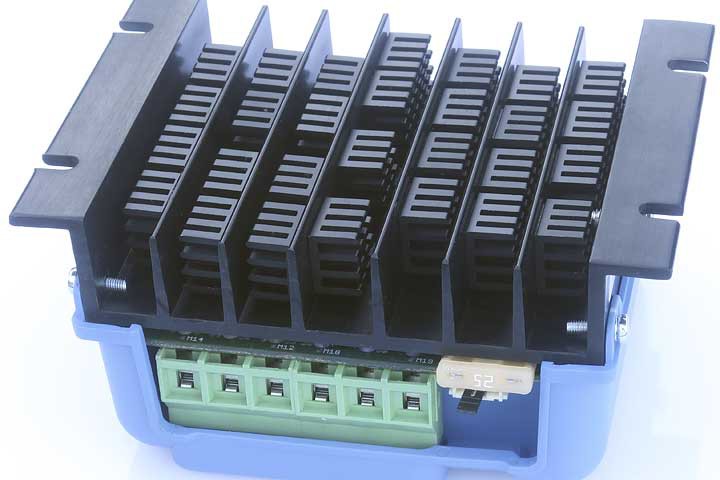

Latest addition to my 100/20 controller to remove the last bit of heat from the controller. Have been in Tassie for a month so didn't need to connect the solar panels. Preparation for hot climate. I should space the heatsinks but they don't stick to the plastic quite as well so stuck the heatsinks next to each other for support. Next task is to think of any others ways I can squeeze more than 11.3 amps out of the controller. Maybe another stint in the Pilbara or swap all the wiring to 4awg!
But seriously, very happy with the setup & I can simply get on an enjoy my travels & offer cold beers to friends after long walks which is what it is all about at the end of the day!
Under neither that plastic cover is a blue gel like substance. No idea if it is a heat transfer type material or a heat insulating material. Its major purpose is to stop inquisitive people having a look at what's inside. I think a fan added to increase the airflow across the heatsink on the back would be enough to stop it from shutting down due to overheat. All the heat generating items are attached to the heatsink. A water cooled heatsink would move 3 times as much heat energy as an air cooled heatsink, but only use distilled water, any other additive will reduce the cooling ability of the water.
T1 Terry
02:17 PM Apr 5, 2019
I have pretty much got the heatsink side down to the point that it is enough surface area. I could have used a spare heaksink tube radiator off one of my old xenon CPUs but it's not worth the effort milling down the fins on the controller & designing a new mounting system.
The was a bit of heat out the blue cover of the controller, none around the sides, so that's why I chucked on the 9 heatsinks.

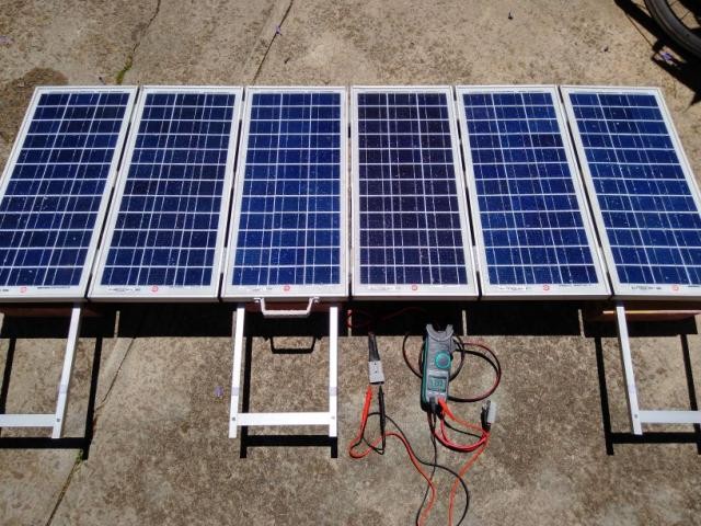

01:12 PM Nov 7, 2019

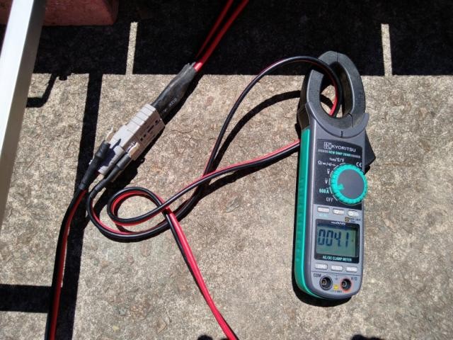

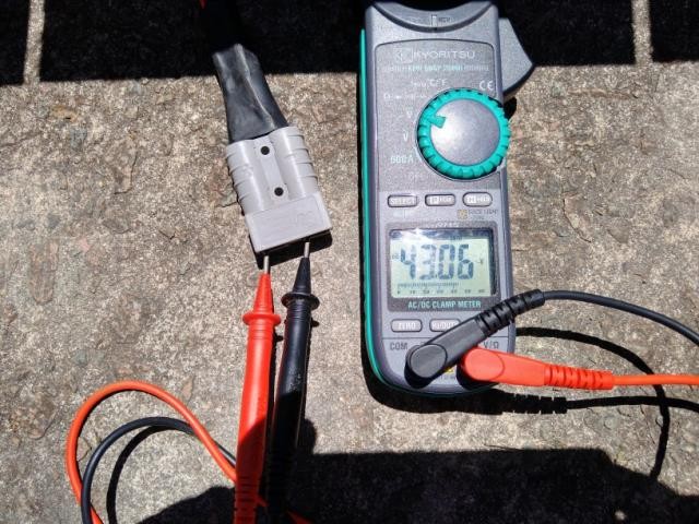

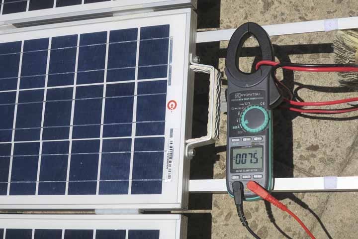

Just got around to short circuiting the six 20 watt solar panels. They are set up as 2 in series x 3 sets with no diodes.
Max voltage was 43.06 but typically around 41.6 volts.
Maximum amps was 4.175 (16.7amps four times through clamp meter / 4), 4.1 amps one time through clamp meter. Typical it was 4.0 amps.
Done at 12.30 & the sky was probably about 95% as good as it will get. Where was a touch of haze.
I also tried without watering the panels first, then with water for cooling the panels & didn't really see much difference.
21v open circuit per panel 2 panels in series is 42v, an average for a pair of 12v nominal panel connected in series. When panels are connected in series, the voltage adds up but the amps stay the same. I hate to burst your bubble, but 4 amps short circuit current shows it is not a 20w panel. This is the specs for a 20w panel from Low Energy development www.ebay.com.au/itm/MOST-POPULAR-New-20-Watt-12v-Polycrystalline-Solar-Panel-MC4-Plugs-NEW-SIZE/322339354506:~3YAAOSwcUBYN8Ub the open circuit voltage of 21.6v is roughly the same, but the 20w panel only has a short circuit current of 1.27 amps. This 60w panel www.ebay.com.au/itm/60W-12V-Solar-Panel-Kit-Mono-Generator-Caravan-Camping-Battery-Power-Charging/231133326316%3D1&hash=item35d09eabec:g:QsMAAOSw92Jdw6yx&enc=AQAEAAACUBPxNw%2BVj6nta7CKEs3N0qV42ZsndMD83ackMm39AByyDjrzkOal4jx9yiaGUFxtxnrZ8KaKo8A6W4Tq6Pa3DqW31OkEZIOFaXanmOsR0Kz88a0GuS5dv3pE%2BaNLBfjj9FxULXogz9e4LtMmYO88k6pdn%2FT14gCR2urpz4K0USkZoco64YKqCa6kn3oT25UFMrQsmaW6zq8nTNkhdS7yUlEqI3KPzhubzbz6%2BXky2uR3SouvtYhzfeM0OaNqidjblLZ%2Ba6vA8LZ8JLI3HW3GuF4MbWknEotse37iwSv7H%2Bu90yA1qHxb3KVWsiaq0CgAYrTpdKfIuJmyFKvNN8h%2FllOye%2F98X7BcrqRXJ3HhVy4aGO%2FylZVlmfYWs%2F4LMBqjgbjtiBIRl3hvcohnd7yT%2FPdUgzyef5%2FwoIdQl4I%2FJNNA%2BQ9sAcS%2B%2BbQp2zGdkMIu6c4miVXLqC59Tsm2vIWg8f9cYkfdW43n9Jc1DrwGbCEtM5tFNPuAFCanyHdpZtkHN9D9tn3qIh%2FtnzEYKF62zPFj%2FJYIvSmVReWrCscyW2UN0TACNkPZQwIneAy8hhKVvPhwXGJ7OgCuwoc4fk3%2FY5L7gZMba3TgRsRlzfLJI1AVN2xxqw38Y6bWHwpOjGDPIOe0B2S5rYnSGSL17cC9q%2FF3AtKQD%2FbhrnGa%2BBLd93q5NplhTQtfHt%2Frkhs3mmBBtRnlb8Rq8ocM%2B7wUvVvrLQ8TZxogyKPB3WycGvrncoMtaVMCSvDTNrA3TEG1pSRiEidbr%2FDZzwdt3TWBwgLhUw0%3D&checksum=23113332631651d2721ff2d14b88942339048a927540&enc=AQAEAAACUBPxNw%2BVj6nta7CKEs3N0qV42ZsndMD83ackMm39AByyDjrzkOal4jx9yiaGUFxtxnrZ8KaKo8A6W4Tq6Pa3DqW31OkEZIOFaXanmOsR0Kz88a0GuS5dv3pE%2BaNLBfjj9FxULXogz9e4LtMmYO88k6pdn%2FT14gCR2urpz4K0USkZoco64YKqCa6kn3oT25UFMrQsmaW6zq8nTNkhdS7yUlEqI3KPzhubzbz6%2BXky2uR3SouvtYhzfeM0OaNqidjblLZ%2Ba6vA8LZ8JLI3HW3GuF4MbWknEotse37iwSv7H%2Bu90yA1qHxb3KVWsiaq0CgAYrTpdKfIuJmyFKvNN8h%2FllOye%2F98X7BcrqRXJ3HhVy4aGO%2FylZVlmfYWs%2F4LMBqjgbjtiBIRl3hvcohnd7yT%2FPdUgzyef5%2FwoIdQl4I%2FJNNA%2BQ9sAcS%2B%2BbQp2zGdkMIu6c4miVXLqC59Tsm2vIWg8f9cYkfdW43n9Jc1DrwGbCEtM5tFNPuAFCanyHdpZtkHN9D9tn3qIh%2FtnzEYKF62zPFj%2FJYIvSmVReWrCscyW2UN0TACNkPZQwIneAy8hhKVvPhwXGJ7OgCuwoc4fk3%2FY5L7gZMba3TgRsRlzfLJI1AVN2xxqw38Y6bWHwpOjGDPIOe0B2S5rYnSGSL17cC9q%2FF3AtKQD%2FbhrnGa%2BBLd93q5NplhTQtfHt%2Frkhs3mmBBtRnlb8Rq8ocM%2B7wUvVvrLQ8TZxogyKPB3WycGvrncoMtaVMCSvDTNrA3TEG1pSRiEidbr%2FDZzwdt3TWBwgLhUw0%3D&checksum=23113332631651d2721ff2d14b88942339048a927540 shows the same open circuit voltage and only 3.63 amps short circuit or 3 times that of the 20w panel shown above. A rough back of the envelope calculation says these are around 65w panels. If we use the output for the 60w panels they say their maximum current output is 3.39 amps @ 17.7v 3.39 x 17.7 = 60w, so that adds up about right, but in real life if you get much more than 2.5 amps out of these panels you are doing well. With 6 panels that would mean you should still be able to get 15 amps out of them, so it is quite possible they have deliberately derated them to cover their otherwise poor performance. I see that quite often with panels a mob is clearing out, they advertise them as 175w panels but their physical size is the same as a 250w panel. No one complains if they get more than the 175w they bought so everyone is happy. I'm guessing this is the same in your case, you bought what you believed were 20w panels and they deliver a lot more than 20w each so you are happy and got more than what you paid for and the system does everything you are asking from it. You could try connecting 3 panels in series to increase the open circuit voltage to around 63vdc, well within the 100v the controller can handle but the higher voltage might reduce a few of the cable and connection losses resulting in a bit more output from the controller.
T1 Terry
Don't ya just hate it when the link adds all that other stuff you don't want
-- Edited by T1 Terry on Friday 8th of November 2019 04:59:36 PM
06:18 PM Nov 8, 2019

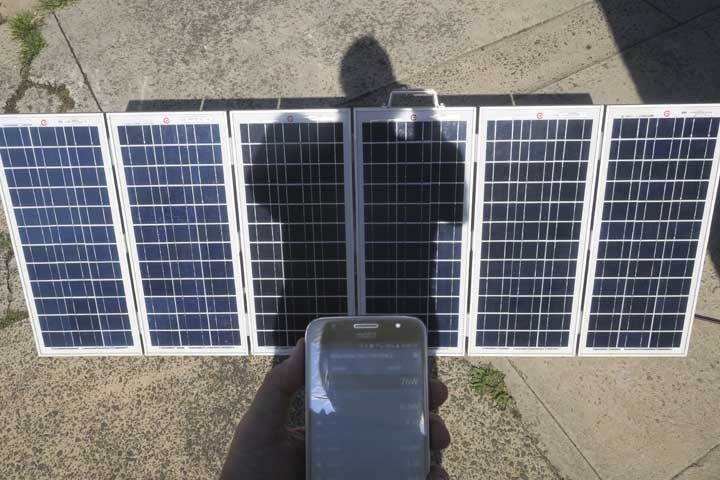

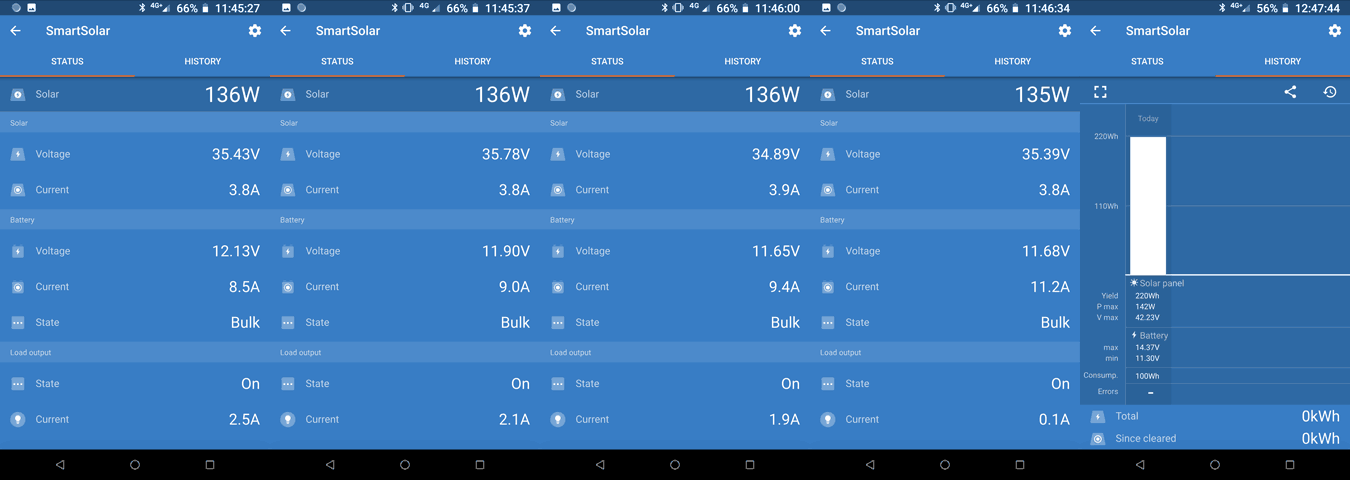

I've wired the panels back to parallel once & back to series again. I'm not doing it another time, besides the Kyoritsu 2046R clamp meter confirms the Victron output. I use the clamp meter on holidays to do random checks & I can't complain with what is going into the batteries.
This photo from the top of the thread when the panels were all in parallel showed 7.5amps going into the MPPT which corresponds to the panel meter.
Probably 2 controllers, clamp meter & panel meter are all faulty.

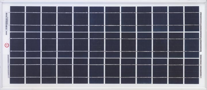

The Projecta was $42 a panel when I bought them, but for my requirements size, especially the 278mm width was far more important than price. Not having the panels stick up higher than the spare wheel prevents the forward facing panel being covered in bugs & dirt so I didn't need to have a cover.
My 6 panels cover an area of 1.064m2 (not including hinges)
AFAICT, the efficiency of these panels is about 10%.
20 watts / (638 mm x 278 mm x 1000 watts per square meter) x 100 = 11.3 %
20 watts / (656 mm x 296 mm x 1000 watts per square meter) x 100 = 10.3 %
Were they old stock, or is this what we can expect today? AIUI, this figure is at the very bottom end of the range.
09:17 AM Nov 10, 2019
The panel was all I could find at the time that would fit the space on my roof rack. If I find some new ones which are better I'll chuck these out.
They could pack the cells closer together & brought the frame in closer which would have increased the energy density & reduced weight. The wasted space adds up pretty quickly.
These panels are for domestic and commercial rooftop solar use, but ...
Most solar panels are between 15% and 20% efficient, with outliers on either side of the range. High-quality solar panels can exceed 22% efficiency in some cases (and almost reach 23%!), but the majority of photovoltaic panels available are not above 20% efficiency.
I checked a 20W panel at Jaycar, and their efficiency is about the same as the Projecta panels, but there is a substantial border due to the frame, as you say.
If I take 10mm off each side to allow for the frame, then ...
20 watts / (618 mm x 258 mm x 1000 watts per square meter) x 100 = 12.5%
A 20mm border gives ...
20 watts / (598 mm x 238 mm x 1000 watts per square meter) x 100 = 14.1%

I tried covering each 1/3 of the panels & the total power dropped only by exactly 1/3 according to the Victron app, & covered 2/3 or the panels & power was down by exactly 2/3. I also did 3 panels in series in 2 sets & power dropped by half.
Covering a very small portion of a panel knocked out power of the whole set in series, so I learnt that even a small shadow is detrimental & I would loose a 1/3 of the power.
90 Wh: At 2C for 12 hours.

I replaced the 75/10 controller with a 100/20 controller to see if I could squeeze a bit more out of my setup. I also added a pile of 14 x 14 x 10mm adhesive heatsinks to keep the controller as cool as possible. They have pretty much doubled the surface area, & I have a handful more I could stick on if needed. So when the battery voltage is a bit low now getting up to 11.3 amps under ideal conditions. The controller is also bolted onto a sheet of aluminium so gets a little more benefit here.
T1 Terry
T1 Terry
656 x 296mm the $25.99 20 watt panel.
638 x 278mm the Projecta 20 watt panel.
The Projecta's area is 8.6% less.
https://news.energysage.com/what-are-the-most-efficient-solar-panels-on-the-market/
If you shade one pair of panels, does the combined current fall to 2/3 under normal conditions? Can you detect any reverse current into the shaded panel?
I would have gone with 3 in series x 2 sets to keep power up in very low light conditions, but decided to go with 2 in series x 3 sets so if I get a shadow I'm more likely to only loose 1/3 of the power.
These test were to understand solar panels as I had no experience to date. I needed to know if 120 watts was enough as everyone says how much less you get than what the manufacturer says. I had intended to install bypass & blocking diodes as recommended in the Projeta manual that came with the panel but decided after these initial tests to see how I would go without diodes. Maybe on larger panels diodes are more of an issue but I don't know.
I have gone completely overboard with heavy wiring as I really did not want to do that again. Now even having a 4awg cable to connect the panels to the controller, a couple of 6awg cables & 8awg if I have to reach 15 metres for the sun. I could even wire in my jumper leads for another 3 metres!
