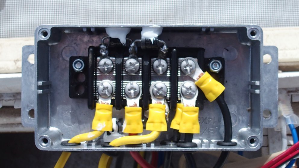

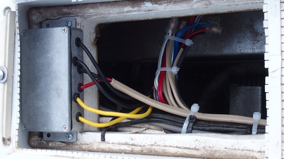

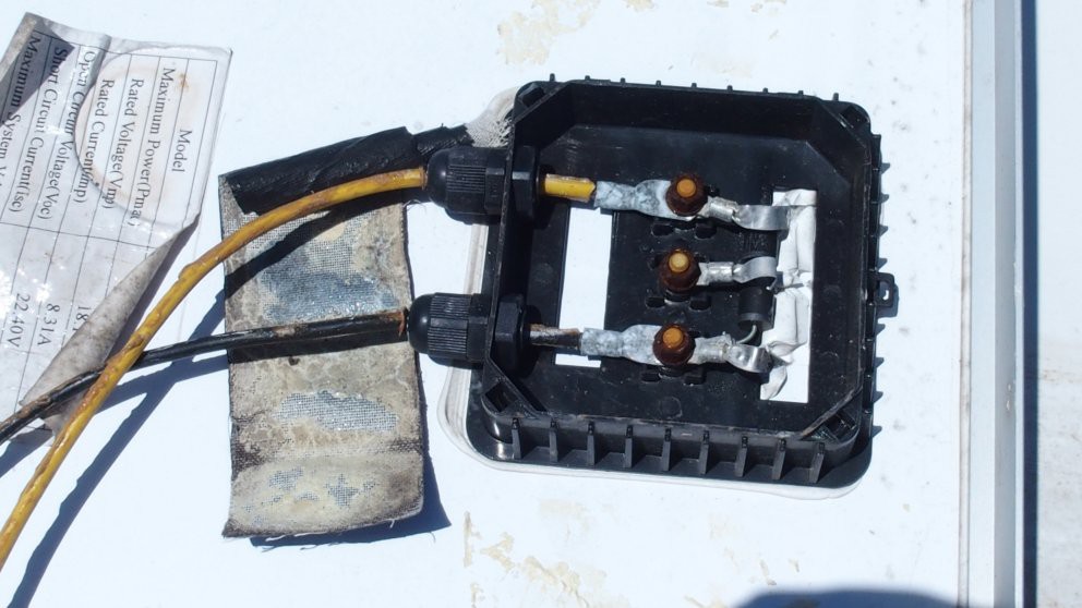

Three pictures, the first showing the junction box under the solar panel, lid having had the locating legs broken off it, and the lid gaffa tapped in position. This panel the lid was missing and the items inside are all corroded. The other panel I noticed the gaffa tape early and did some repairs to salvage the box, so still had a lid for that side. Both boxes had gaffa tape to secure the lid, thanks Jayco.
The second and third picture show the second junction box, 4x diodes installed, and the box mounted up in the fridge vent area. This job is done, only the third panel to go.
The last panel has had the diodes fitted, the new regulator is ticking away (figure of speech, it is quiet) all programed up for gel batteries. Last night was the first night of unpowered camping to try it out. The batteries were all charged by 1 pm. 18 amps was the max I saw going in. To night I am going to have everything on to bring the batteries down further to see what happens.
It was clear that one of the two solar regulators was u/s, and the other I think was leaking power back out at night. My assumption is, is that the system is working much better, although I still think we will need angle panels during winter to get us through then.

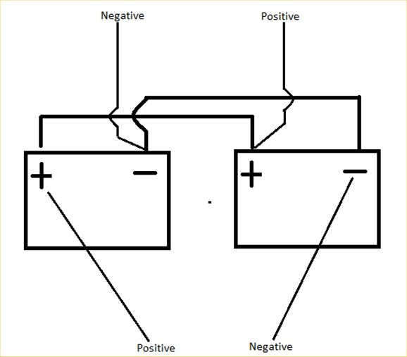

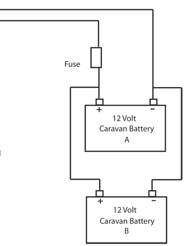

Been reading on the net, and according to what I have read, I have wired the dual batteries up wrong, could this be part of the problem I am having.
The first picture is how I have wired the two batteries, the second picture is how I should have done it, please explain why, I have an idea of why, I just need my reasoning confirmed, that I may have only been charging up one battery, with the other left in a less sate of charge.

09:01 AM Oct 28, 2018
pictures snipped. . .
If the connections between the two batteries are of substantial cable then the two circuits are essentially the same. The only time connecting the batteries according to your second circuit would be of any real benefit is if you are drawing really heavy currents. With the currents in most of our vans the low resistance in the interconnections does not affect the situation to any really noticeable amount.
Connecting your batteries by the first method is definitely not the cause of your charging problems. I don't think changing the interconnections will solve your problem.
Jaahn said
09:17 AM Oct 28, 2018
Hi Iana
I agree with Peter, the wiring is not the problem if it is all well sized. Having the second method is just getting it perfect but is not necessary. The explanation why it is perfect is because the voltage across the terminals of both batteries is exactly equal. But in your case the difference may be a minimal difference.
I also agree that float is not a charging process. The charger/regulator should get the batteries fully charged, if it has the power available, in the absorbtion phase and should keep going until that happens. Float is only for maintaining the batteries fully charged in good condition without overcharging them, that is why the voltage drops down for float.
I think it sounds like your batteries may be degraded in capacity. You should really charge them up individually with a quality charger and if you want to check them then get a car light globe and see how they perform over time down to a set voltage. Do not discharge them too low and damage them.

Apart from the high voltage overcharge problems with gel batteries, these batteries are equally as robust as other batteries.
Float charging is not really charging. When batteries are charged to 70% or more, all the float charging from multi stage chargers does is compensate for the natural discharge of the battery. Or in other words the float charge stage in a multi stage charger is there to maintain the battery and not charge it.
A multi stage charger commences its cycle with the bulk stage. This gives the battery the majority of its recharging. The second stage is the absorption charge. This will complete the recharging of your battery if things are working properly. In all the chargers I have had dealings with this stage terminates when the charging current drops to a few percent of its maximum rated bulk charge capacity. I know of chargers have a time limiter built in them but this is to limit the maximum time of the absorption charging. It only cuts in if the absorption charging has not gone through its natural current limiting cycle. Personally I would not use a charger that forces the absorption stage to go through a time period and not let the current drop provide the natural limiting of the absorption stage.
Hi Iana

An update on the situation.
Having put blocking diodes on the three solar panels 145w each, replaced the two regulators, one faulty, the other maybe, with one of higher capacity, and also replacing the wiring between the batteries and regulator with double size wire and halving the wire length, then replacing the two 100ah gel batteries with 120ah AGL batteries.
We are now up too our sixth night, no services camping, and have plenty of power, even with the TV and Vast on. So the exercise was a success.
Still think we will need angled and portable panels to see us through the winter though.
Thanks everybody for the help.
