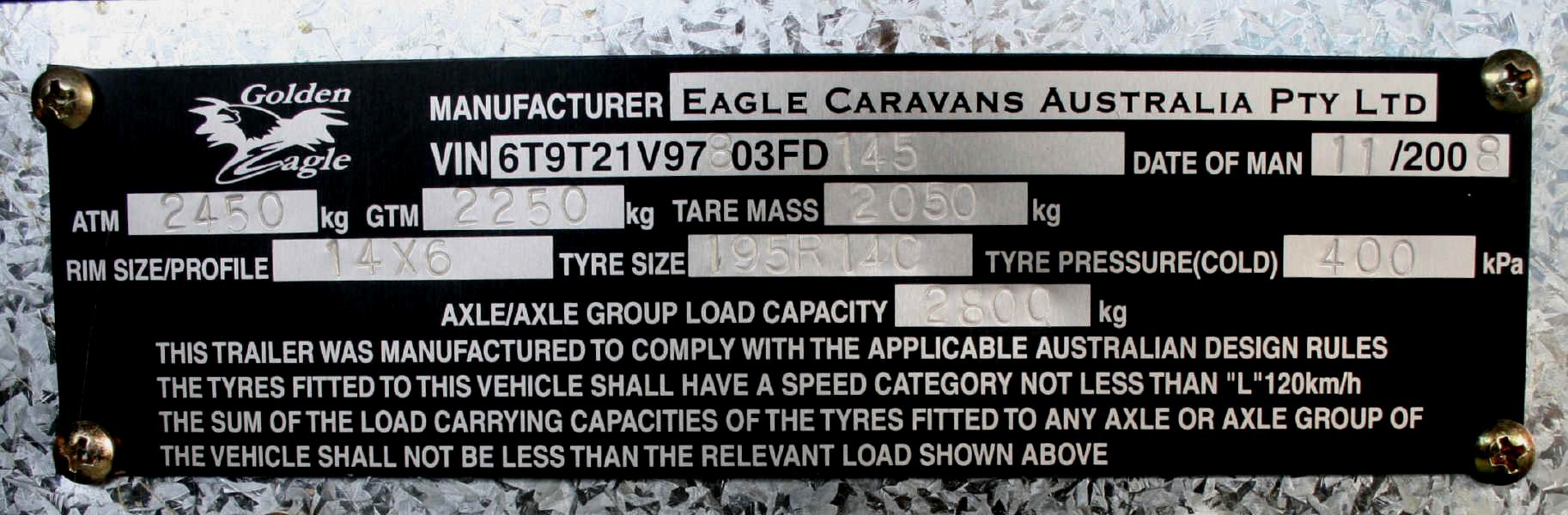

Very unusual not to have ball weight stamped on the comp plate.
However it is worth noting that a manufacturer is only legally required to stamp the ATM on the plate, all other weight information is optional.

I had my homemade van first registered in Victoria 2016 and it never needed the ball weight on the compliance plate at Vicroads

Thanks I will take another picture.

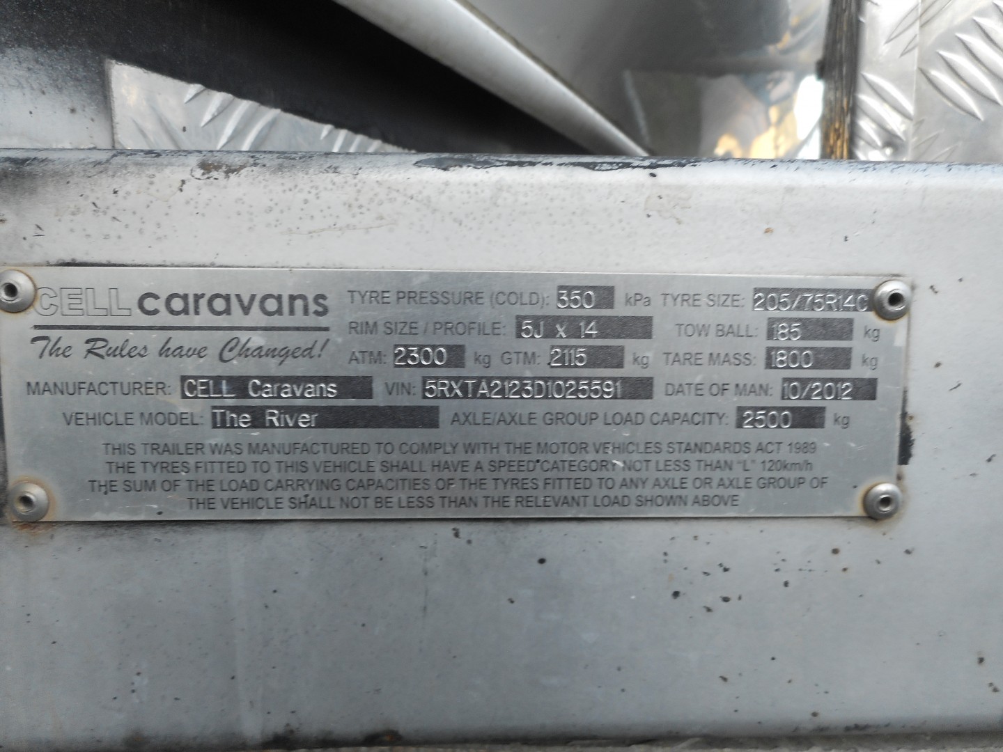

I do understand you are a dealer of some experience and obvious standing and I hesitate to question your knowledge/advice.
However, that statement is not valid. Many vans do NOT have a towball weight stated on their compliance plate ... whether a 'tare TBW' or a 'MAX TBW'.
See the compliance plate for my van -

2. The van's actual (vs. rated) ATM or GTM needs to be measured.
3. The actual ball weight as measured
IMO, there's no point in them reducing or shifting payload around until these things are determined.
(1) The tow rating of the motor vehicle.
(2) The tow rating of the towbar fitted to the motor vehicle
(3) The tow rating of coupling fitted to the caravan.
The maximum towball download is the lessor of (1), (2) or (3)
So far, vickiparker has not disclosed (1) or (2) above but from reading the photo of the vehicle plate on the caravan, we know that the caravan does not have a maximum ball mass (3) so only (1) and (2) apply.
Vicki
Just tell us what values of (1) and (2) are?
Further, what is the actual ball mass of your caravan (4)?
I suspect that the actual ball mass is less than either (1) or (2) above, so nothing to be concerned about.
If you know the numbers (1), (2), (3) and (4) then you know where you stand !
Plenty of people here to help you work it out, we just need the weights and numbers we've asked for. As a rock bottom start, even just the car's max. tow rating and max. ball weight rating will do for now (they're printed in your manual), we still don't know the exact specifications of your vehicle. Then the rest can be tackled step by step. Unless you're serious about giving up on the van, it is important you learn and understand this stuff, it's basic due diligence for caravaners. It will gel - it isn't hard really.
I suggest a little time to allow her to get around all this and supply the measurements
