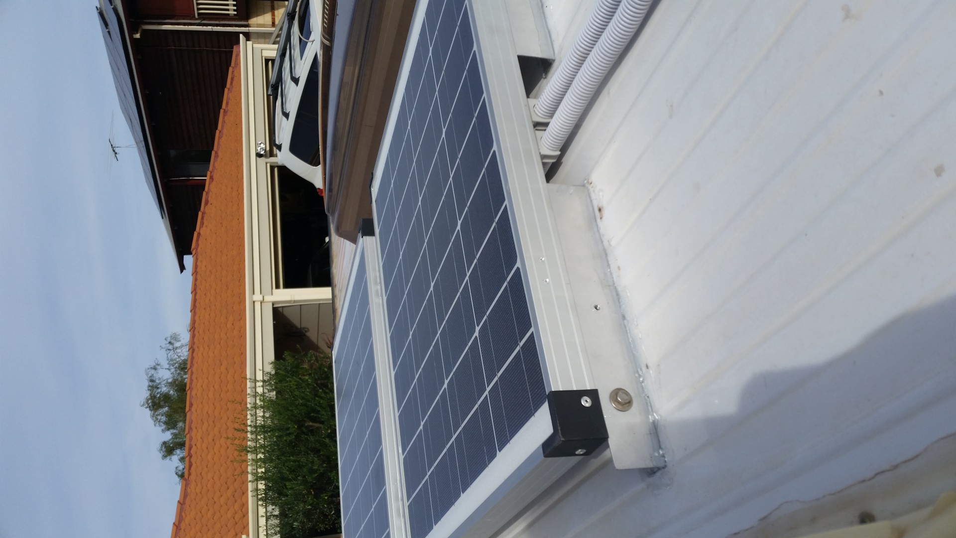

Heres some pictures of them finally up there!!
Thank you to all for your advise, really has been great reading your thoughts.

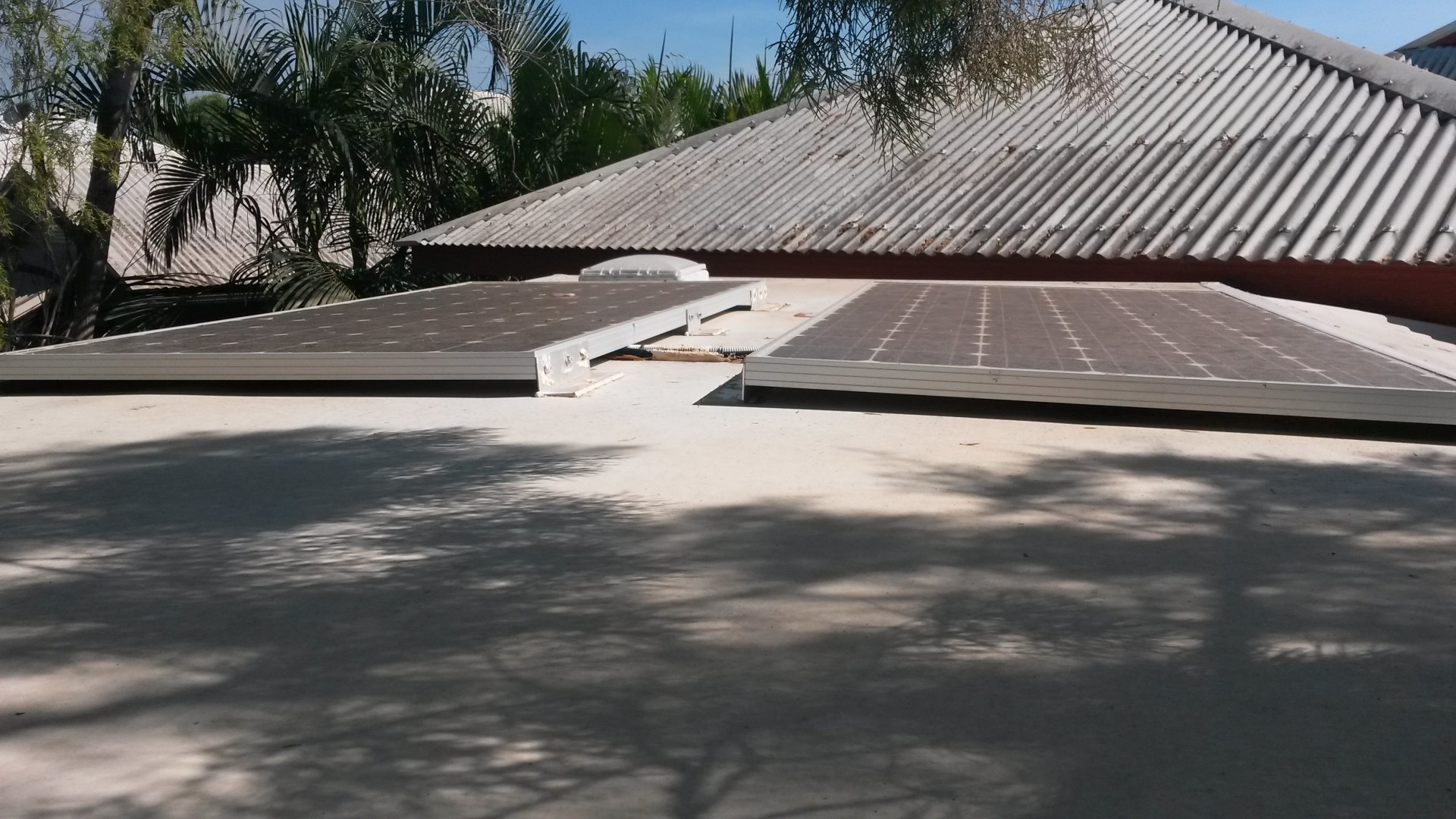

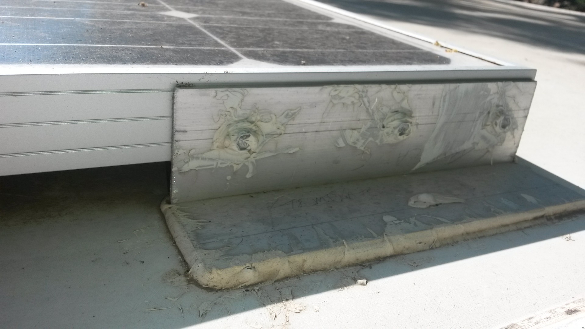

I have a pop top Jayco and fitted 2 x 200watt panels.
I used 40mm angle aluminium from Bunnings cut to 200mm lengths for supports, 3 on each side of the panels (12 total) tek screwed to panel frames allowing plenty for ventilation under.
Each support has 2 x 10mm holes drilled to allow adhesive through when mounted for additional strength.
Advice from Sikaflex rep (over year ago) was to use Sikaflex 221 with no need to fix brackets to roof with screws or bolts.
I cleaned the roof lightly where the supports are with soapy steel wool removing all dirt.
Used generous amount of Sikaflex 221 and one tube was more than enough.
Done 10,000km mostly in very hot conditions and some very rough tracks with no sign of movement of panel supports.
Sikaflex is primarily an adhesive and I believe the major mistake of some fittings is to use a sealant only.
Sika update their products so check if there is an improvement to this particular product. They also have detailed spec sheets on their product range.

Hi Dicko, as you can see from the pictures i also used ally angle.
Firstly i secured 200mill lengths to the underside of the panel frame with the short side, then the long side onto that to give me more choise on height from roof.
O also fitted inserts and volts so as to hinge up when cleaning them.

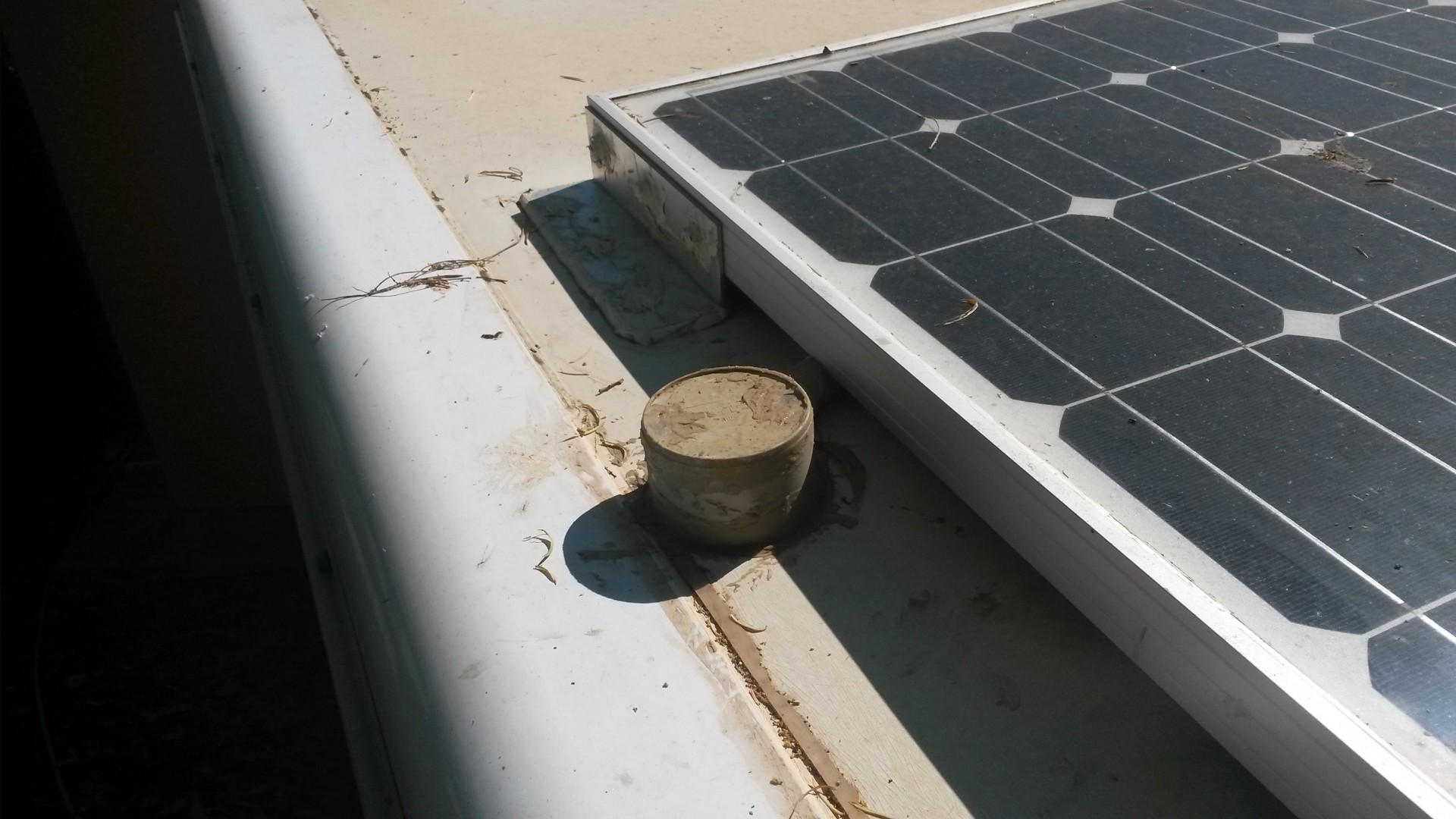

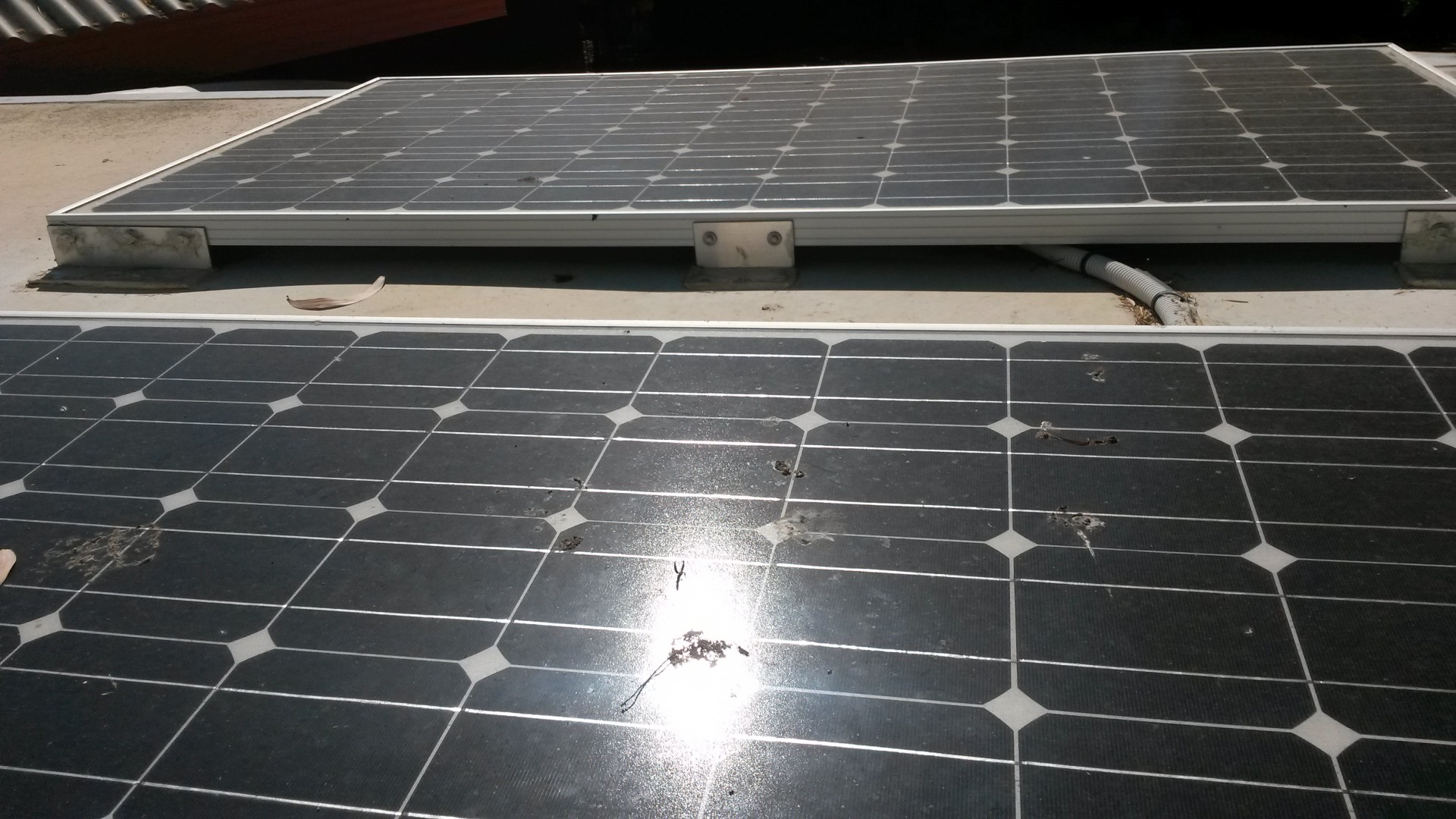

Took the opportunity whilst in Darwin today to clean roof so took before pics also.

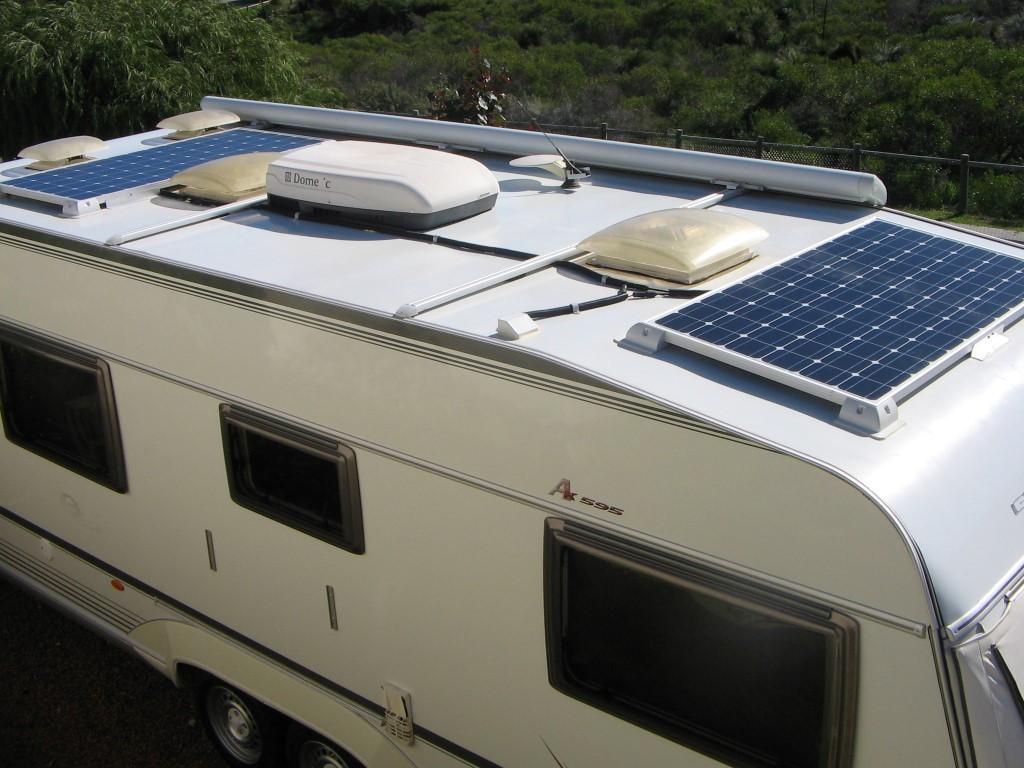

Just a note of caution regarding the set up in the photo, cover the MC4 connectors to protect them from the direct sunlight as the harsh Aust UV affects the plastic and the clips break off resulting in the plugs not remaining firmly connected, a failed connection is the end result.
