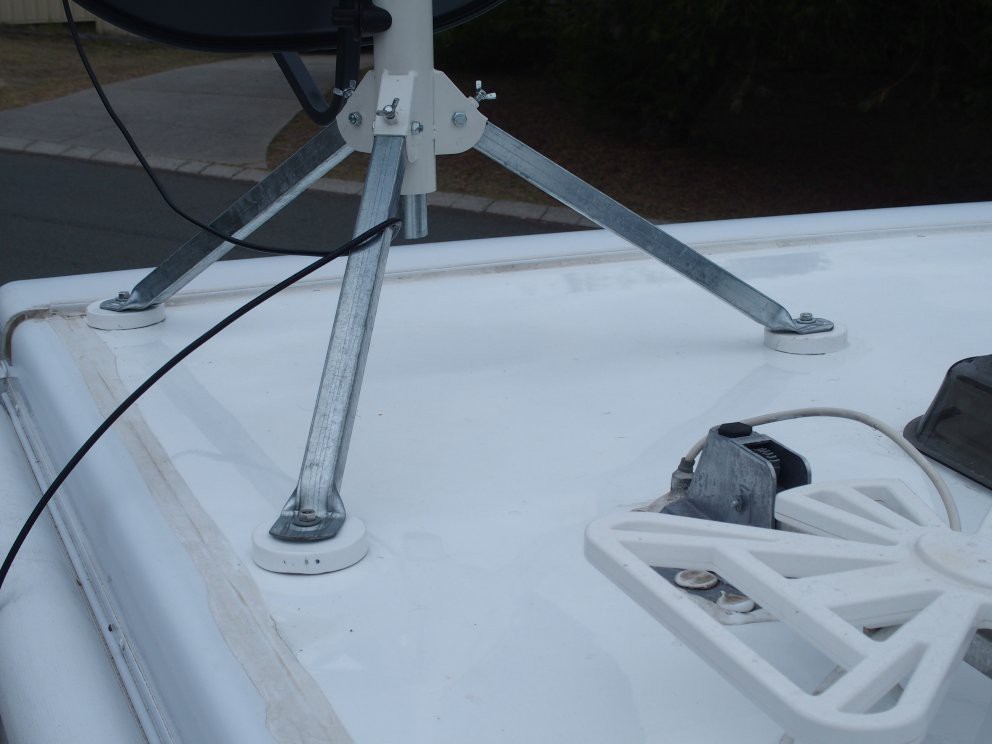

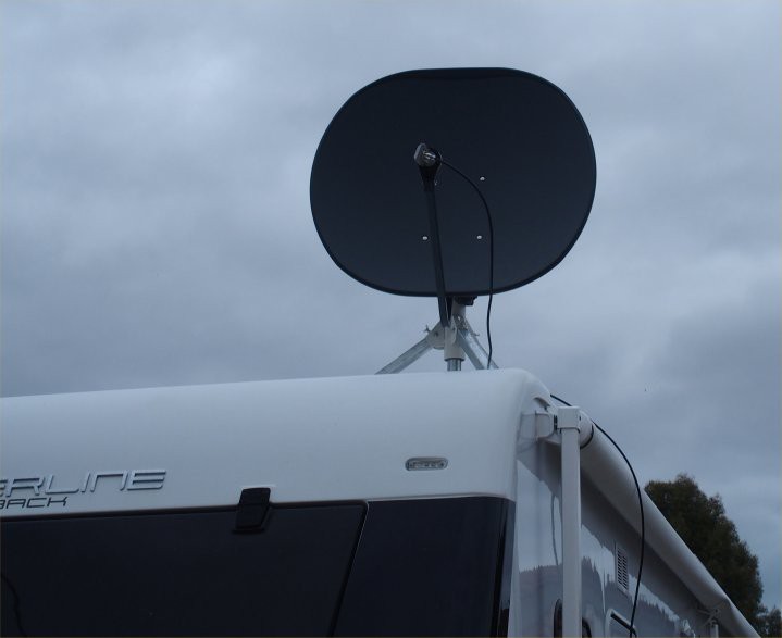

Mounted these feet on the roof of the van this weekend, PVC end caps tapped with an 8mm bolt and filled with fiberglass. Its not very hard to get the tripod and then the dish up there, cures the theft problem. Unit is from Access Antennas.
Not hard to get up there? MIne is an off road van and is over 3 metres on roof height. I dont know how I would get up there unless I carry a ladder! I agree yours would stop theft but it looks like the legs of tripod are bolted down. How quickly is it to remove when on the move each day? Also not so easy to get dish pointed the right way I would think. Then the other thing is if you park under trees, you might not get a clear line of sight to the sky and hence a poor picture. Thats why I went for a ground mount dish. Yes it might get stolen, but I do have it chain bolted to the van when parked.
I doubt that I would putting it up there for a one nighter, but yes you need a ladder, which I will be taking and our van is lower at 2.8 m. The pads have an 8mm stud and a s/s nut finger tight. Taking it down presented no problems.

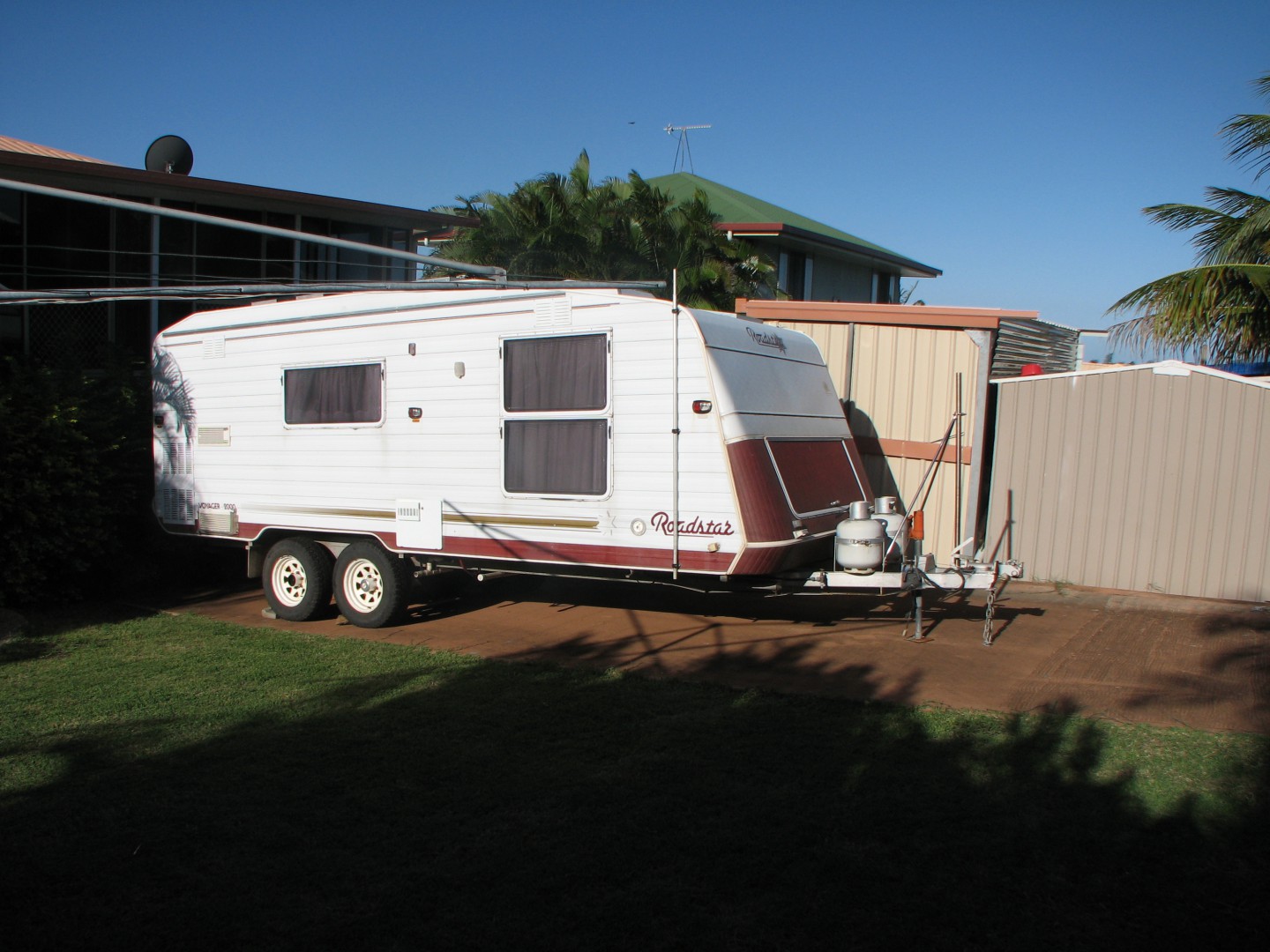

Original dish.
I had a length of stainless tubing offcut from 1 1\4in Hand railing on last yacht.
Clamped to drawbar.
Dish mounted on that.
Lowered or removed for travelling.
Otherwise raise up to clear front of van,
and rotate to suit those bearings req'd there.
