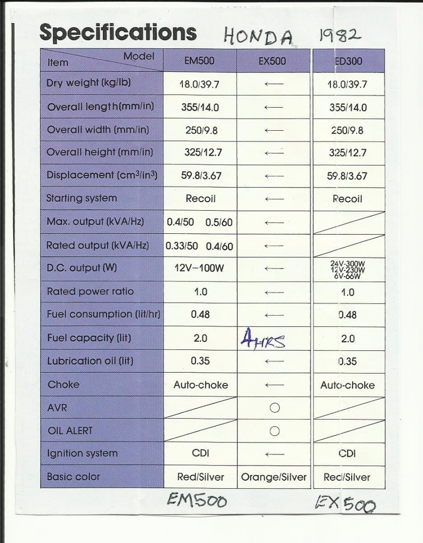

There was a Honda DC 12V generator back in 1982 mod ED300, it was a small 4 stroke genny. I bought the EM500 which was 240V AC 300W continuous. It is still used by me.
