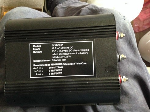

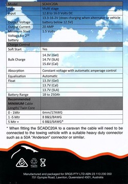

Picked up my Supercheap $149 DC to DC charger this morning. Attached specs.

1. Ran 6B&S cable from batteries to Setec.
2. Shifted solar controller to where I can monitor it, and upgraded wiring to batteries.
3. Parallelled the original Setec input wire and fridge wire to fridge, fed from the original 8 B&S cable from Tug alternator through Isolation relay.
4. New 6 B&S cable from tug alternator to Anderson plug.
5. DC to DC charger fitted and run from the Anderson plug.
6. 8 B&S cable routed to solar controller ready for new 200 watt panel to be fitted when sons can assist.
Finally the time for testing my DCDC charger installation. Worked perfectly. Now need to tidy up with cable ties etc, and make quite a few labels, AND draw a diagram to help with future memory lapses!!!!!!!!!

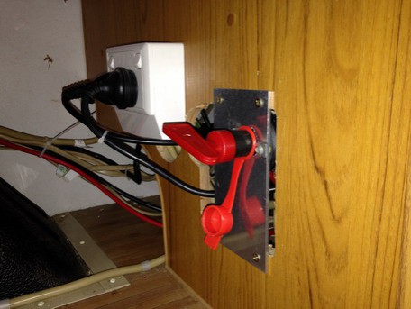

My master 12 volt DC switch now.
-- Edited by aussie_paul on Wednesday 19th of August 2015 08:58:32 PM
We use one of these on 1000w inverter in van I can turn on/off from my bed very convenient. Used before on boats very reliable IMHO.

The last couple of weeks progress.
Would plugging my 120 watt portable solar without regulator into the DC to DC charger be worthwhile??
I will be very interested in that answer myself as I have just one 8mm cable going from an Anderson plug on the drawbar to the battery and wanted to use that one cable for both plugging in my relocatable solar panel as well as the current coming from the tug while driving.
I have not yet fitted a DC to DC charger in that 8mm cable as yet as I'm unsure if I did that would I still be able to plug the solar panel into it with the existing controller on the panel still functional.
Basically as I understand it the controller on the panel will vary its output depending on the state of charge of the battery it's plugged into, and by plugging it into a DC to DC charger instead of directly into the battery should by rights cause problems to the solar controller.
Like you I think I would be better off disabling the controller on the panel and plugging the raw output from the panel into the DC to DC charger directly, and just let it sort out what charge to deliver to the battery.
Cheers, Tom
