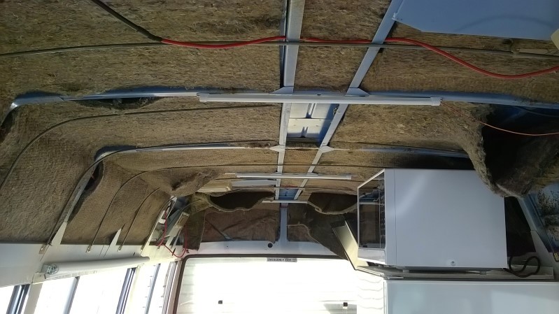

I just used a snap knife with a new blade to cut the foam... like a hot knife through butter :)

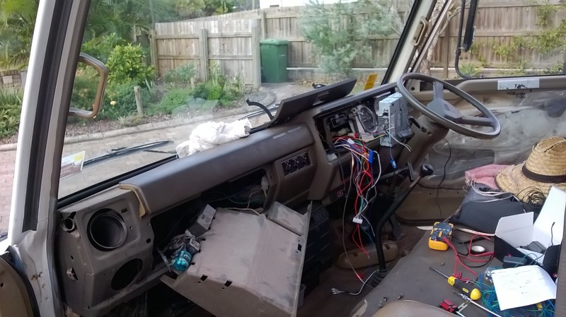

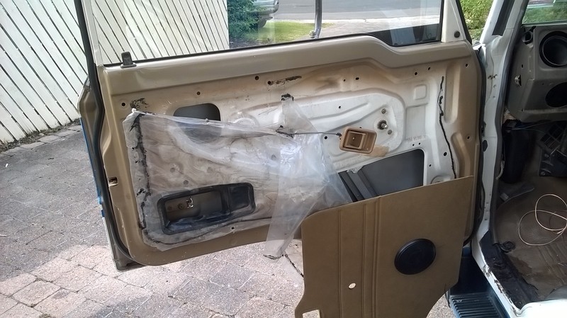

Ok, got to spend a couple of hours on the bus today, putting the new stereo, door speakers and remote central locking in.
Here are some pics of the broken eggs... hopefully tomorrow I'll be able to show you the omelette

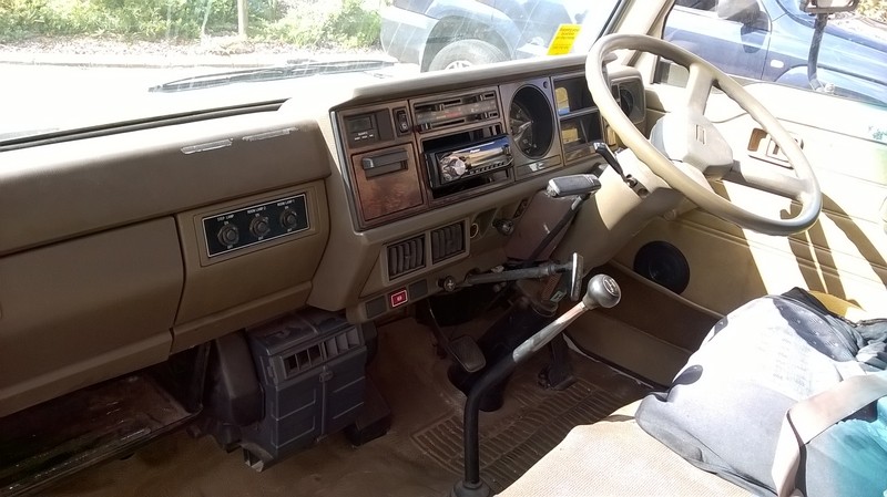

09:45 AM May 28, 2015
Here ya Go Doug, all tidied up
Note the hands free microphone for the new Bluetooth stereo. It's set into the top right corner of the speedo surround.
The original unit was an old double height job, so I just need to cut a piece of black ABS sheet to fill in the gap above and below the new one.
The remote central locking works a treat... I'm really stoked with that. The kit I installed has a boot release function as well, I've decided to use that to open and close the powered centre door... now that's gonna be sweet
Here's a link to a vid of the central locking in action.

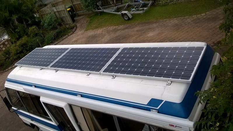

07:20 AM Sep 24, 2015
Thanks Woody, it's been a while since I updated, but as you can see... I've been a busy boy
Rear camera with 3D printed shroud.
3 x 200 watt Solar Panels.

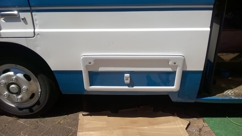

Access door for batteries.

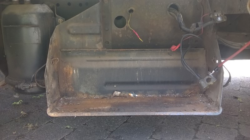

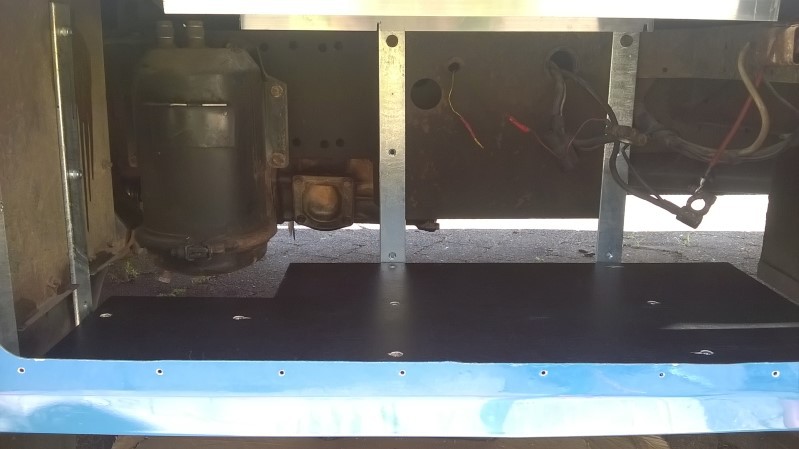

Battery shelf... out with the old...
and in with the new.
220Ah crank batt on right, 2 x 130Ah AGM house batts with a spot ready for a third if needed.

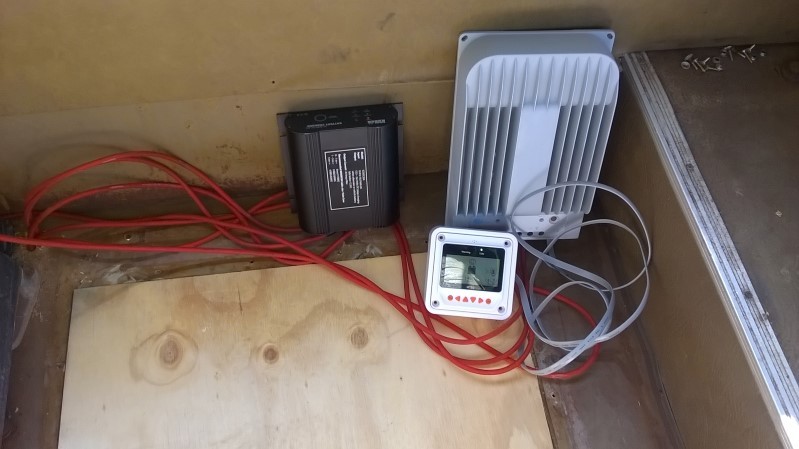

40amp MPPT solar controller with remote control panel.
20amp DC to DC charger.

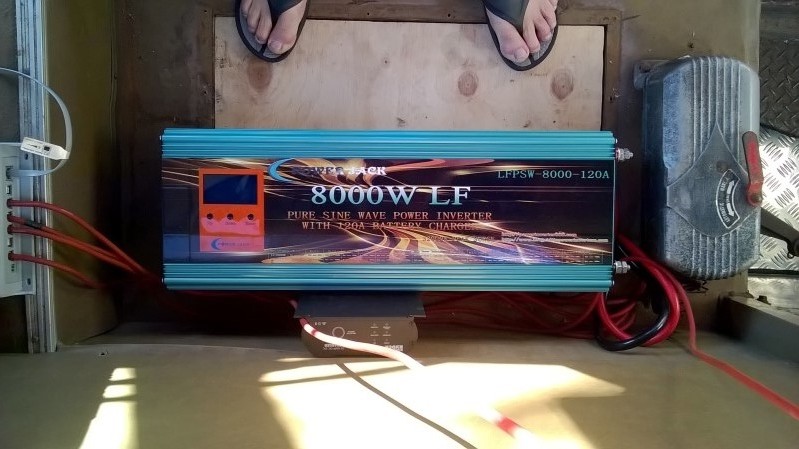

8kW pure sine wave LF inverter, it's also a 120amp charger(probably good for 40). They're WAY overated, it's really only good for 3kW which is why I bought this one. I've tested it on a big quick boil kettle and it dished up 2400W without making a sound. It's early days, but for $399 delivered it's looking damn fine so far. I'll be using a 12v kettle but the Aldi coffee machine is 240 as is the microwave, induction cooktop, TV etc... all the comforts of home
The solar controller, DC to DC charger and inverter will be mounted on the side wall of a kitchen cabinet to be installed over the old battery panel.

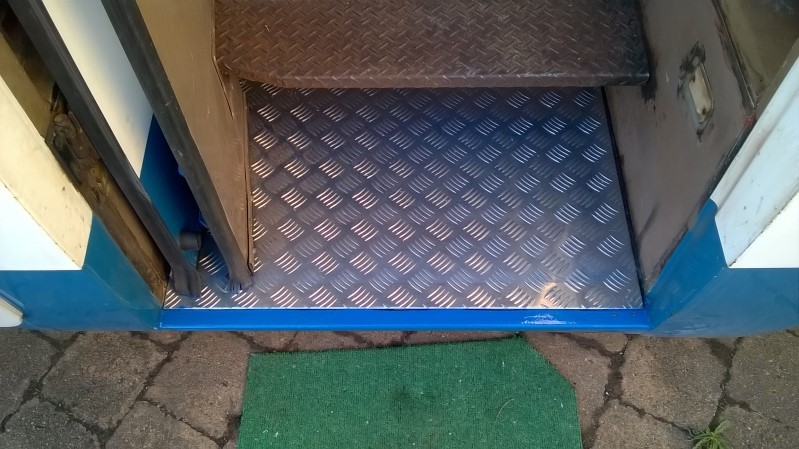

Bottom step replaced with aluminium treadplate.

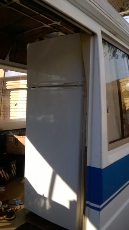

220L Waeco/Dometic 12v fridge freezer.
Perfectly positioned for beer access while slavin' over the BBQ

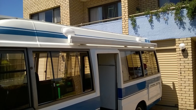

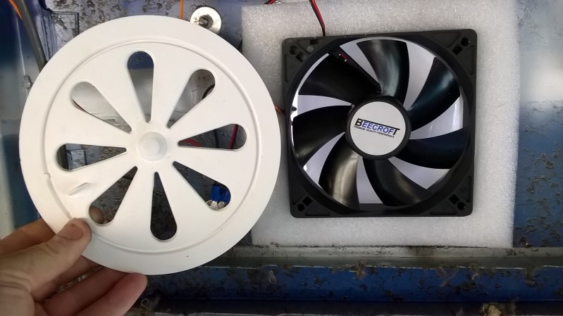

Above the awing are Camec tear drop venturi vents fitted, there are 2 on each side of the bus. On the inside of each vent I installed PC cooling fans which are hooked up to a light activated switch so they come on at sunrise at switch off at night, now I don't have to keep opening and closing the widows when parked up. There's a manual 3 position switch for each as well, so they can be on, off or automatic. The vent covers will be installed once I put the ABS rood lining in.
Below the awning are 4 x 50cm LED light strips.

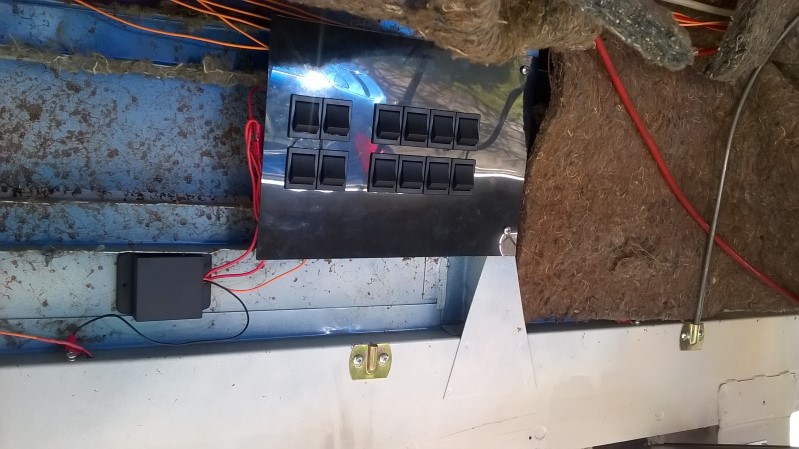

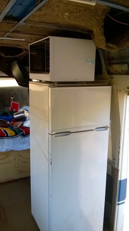

The beginnings of the control center, just above the side entry door. All the lights and fans are individually switched. The black box below the panel is the box containing the light activated switch circuit I built for the vent fans.
