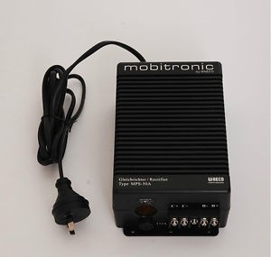

Baz421 said
07:28 PM Apr 5, 2015
Well I may have missed this in reading the previous posts, BUT
Our van 12V fridge has a MOBITRONICS (Waeco) 240V to 12V transformer fitted that run the fridge off 240V when plugged into 240V by means of transforming the 240V to 12V. This is an automatic process when 240 power is on to the transformer.
Input is obviously a 240V 3 pin plug, and out put can be hard wired direct to fridge or by cigarette lighter plug (depending on the model).
We also have an 18litre Waeco fridge that operates the same,principle ie 240V to 12V transformer via cig lighter plug.
Hope this helps, and as son one said look in cupboards etc to see where wires are.
Cheers Baz
-- Edited by Baz421 on Sunday 5th of April 2015 07:28:57 PM
-- Edited by Baz421 on Sunday 5th of April 2015 07:31:41 PM
Baz421 said
07:32 PM Apr 5, 2015
Here's a pic of the common transformer - refer to my previous post. Cheers Baz.
