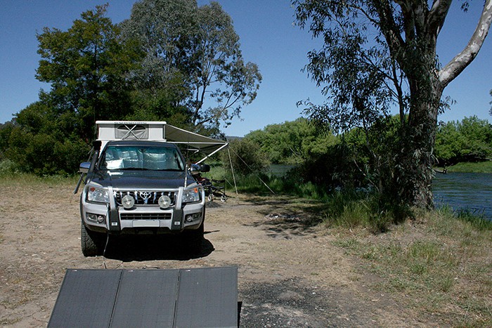

Bought a 160w panel the folds up ( store it in the Suzuki we tow)
It is a Kings model so it came with a PWM Controller that was fitted on the inside of the panels.
All good so far except
The cable they used to connect to the battery via the Anderson plug was way to small I changed it out for 6mm
Change to a MTTP Controller , mounted it in the same spot as the Kings PWM unit.
Made up a extention lead of 4 mts so i can keep the panels in full sun , dont need to use it all the time.
the connection on the motorhome is a Anderson Connector the connects straight to the battery and the lead from the panel connects straight in to that.
Nice and simple
I have more than doubled the amperage output by swapping to a MTTP controller.
I dont concern myself to much with voltage drop, using good 6mm cable and Anderson Connectors.
Nice and simple
