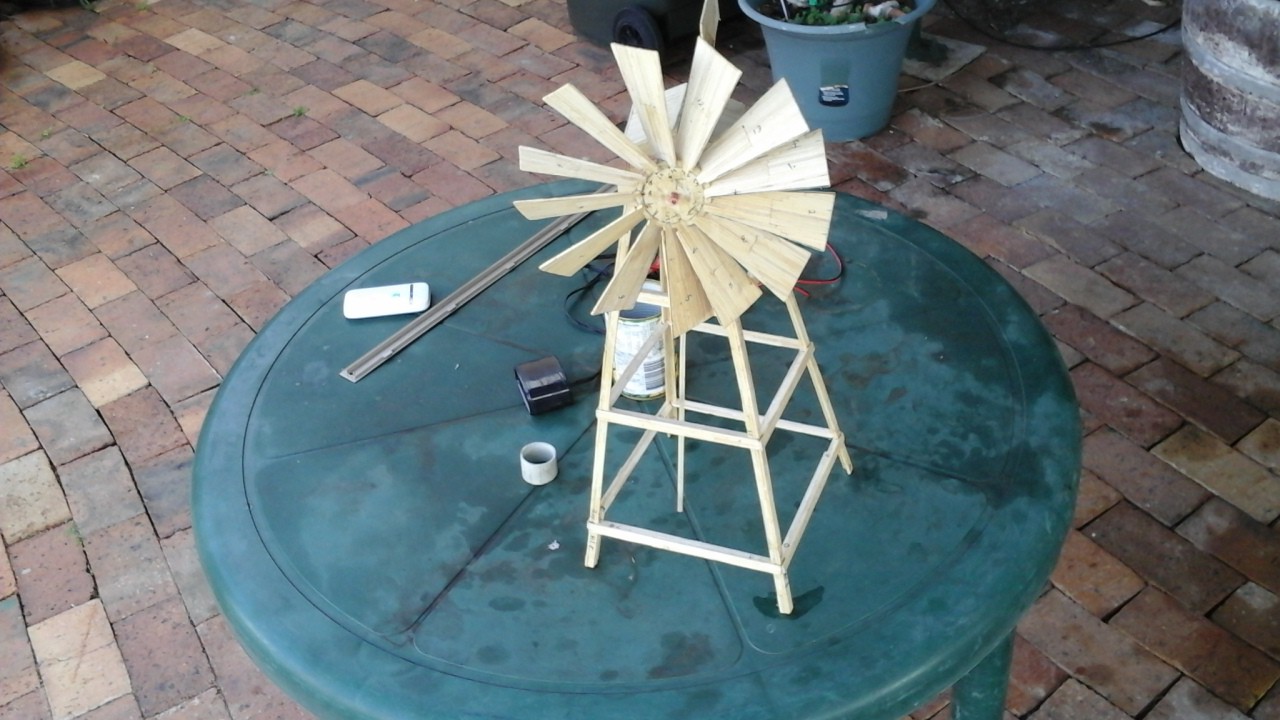

my van said

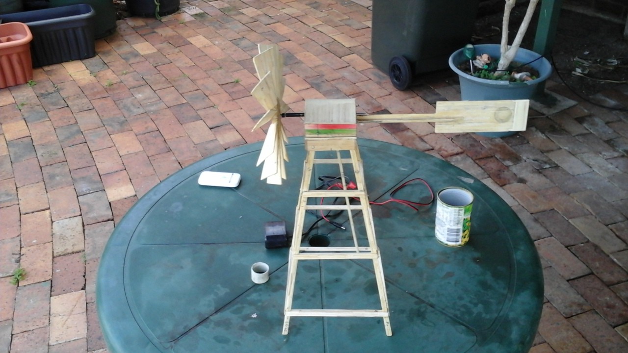

11:10 AM May 26, 2015
Hi Mr D
I am still working on the confounded windmill
A lot of trial and many errors
The head and tail turns on a turntable , while the drive shaft is moving up and down .
The drive shaft has a 25 mm action up and down .
There is still more work to do on it such as the stand platform etc,
Can I use a spray can to paint the mill ?
Some people say yes some say no
Match stick models are a bit different to ordinary pine wood
Spraying the model with spray paint seams to be an easier option if it will be ok
I can not add a water pump because the shaft action ic too fast for the pump valves to handle ,
Well what do you think?
Cheers from Paul

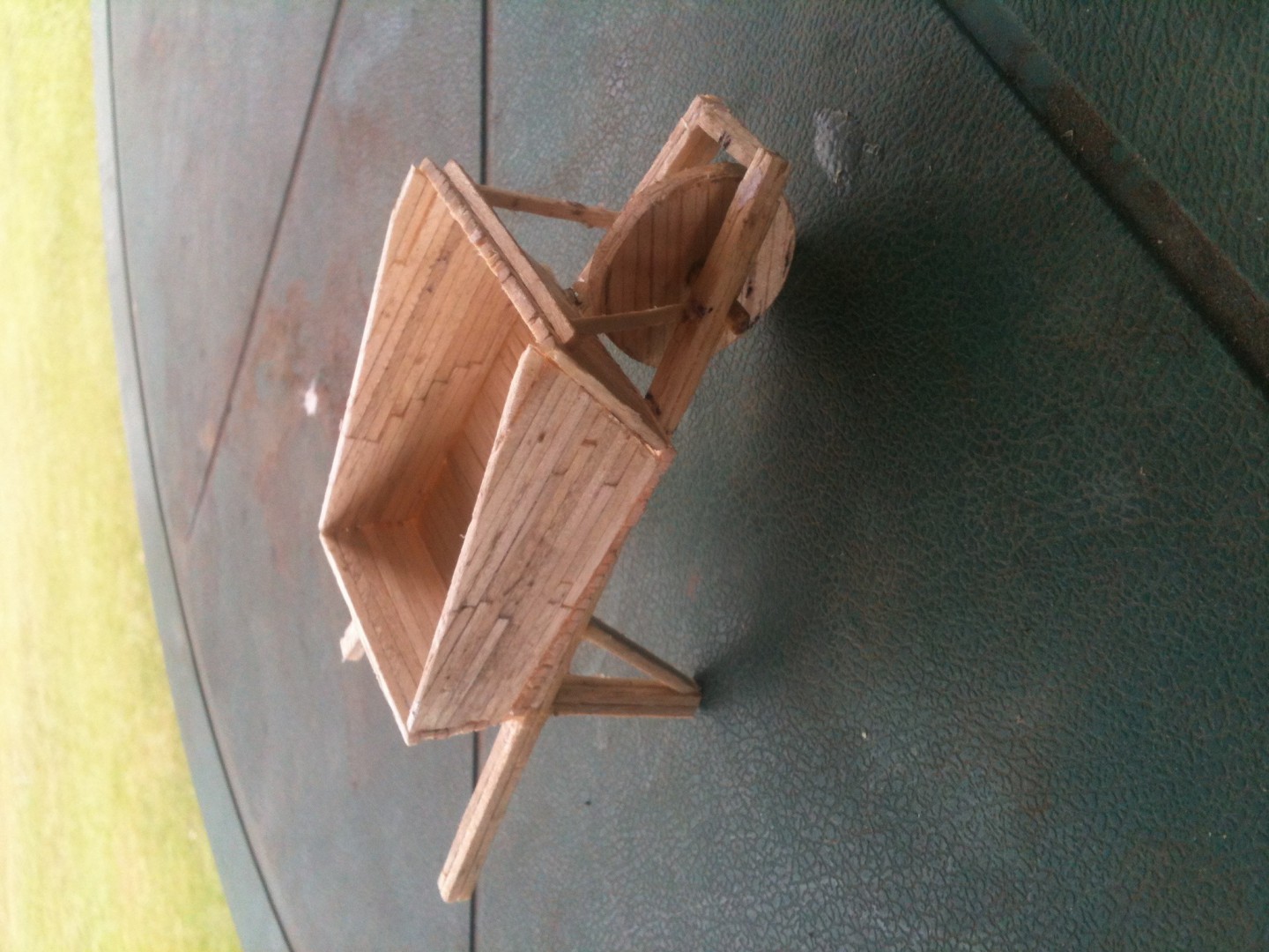

the wheel barrow
Mr D
I am learning , I will apply wood filler one day
The cottage I am doing is a bit more difficult ,
I need to get some tint film for the windows .
The wheelbarrow is 12 to 1 scale
taken from a conventional steel wheelbarrow .
thanking you for your help.

Paul, the wheelbarrow is well done. And I love your statue!~looks like one of the statues on Lake Ballard.

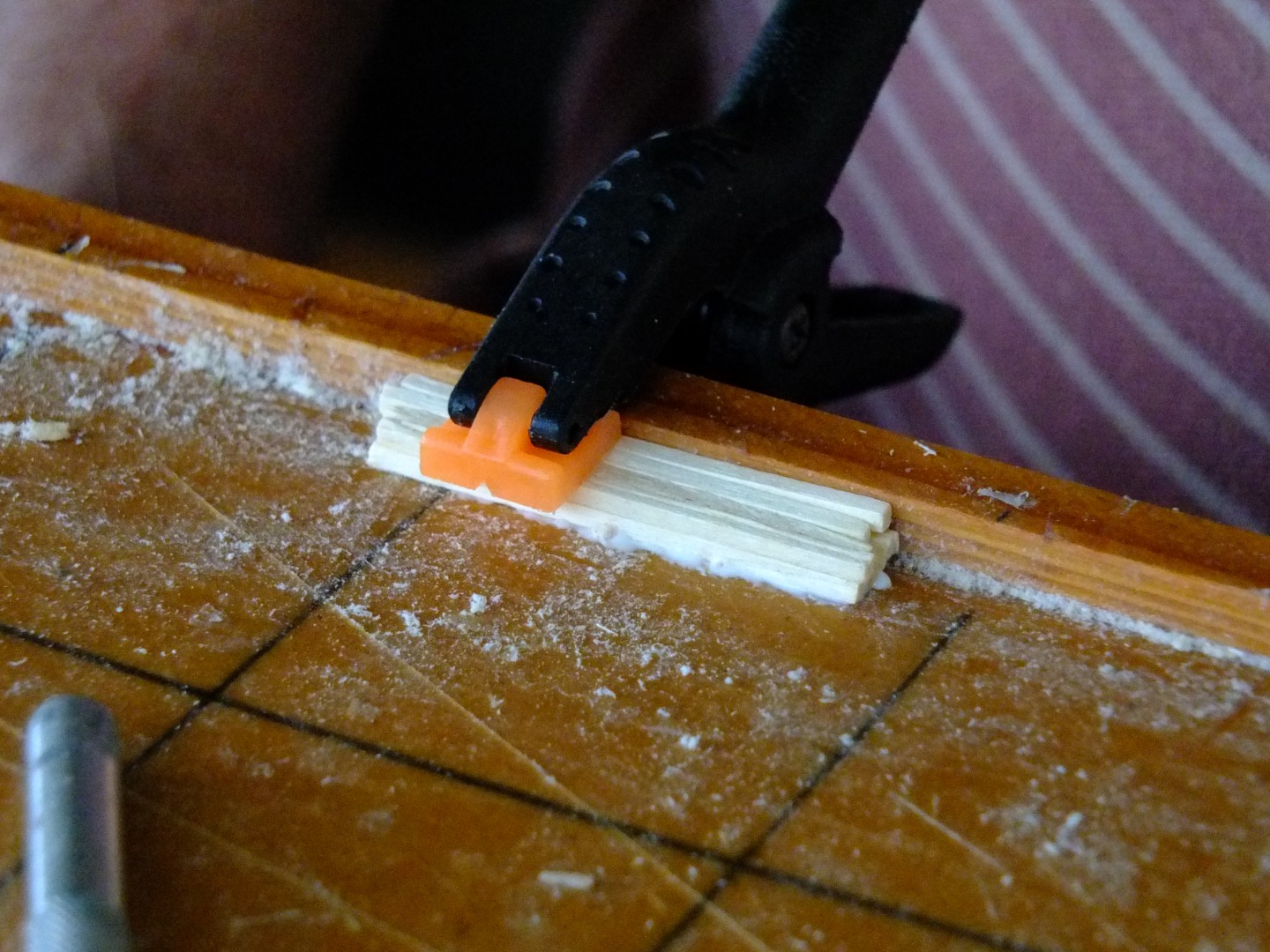

Another hint: The more you clamp your matches together when you are gluing them, the less wood filler you will need.

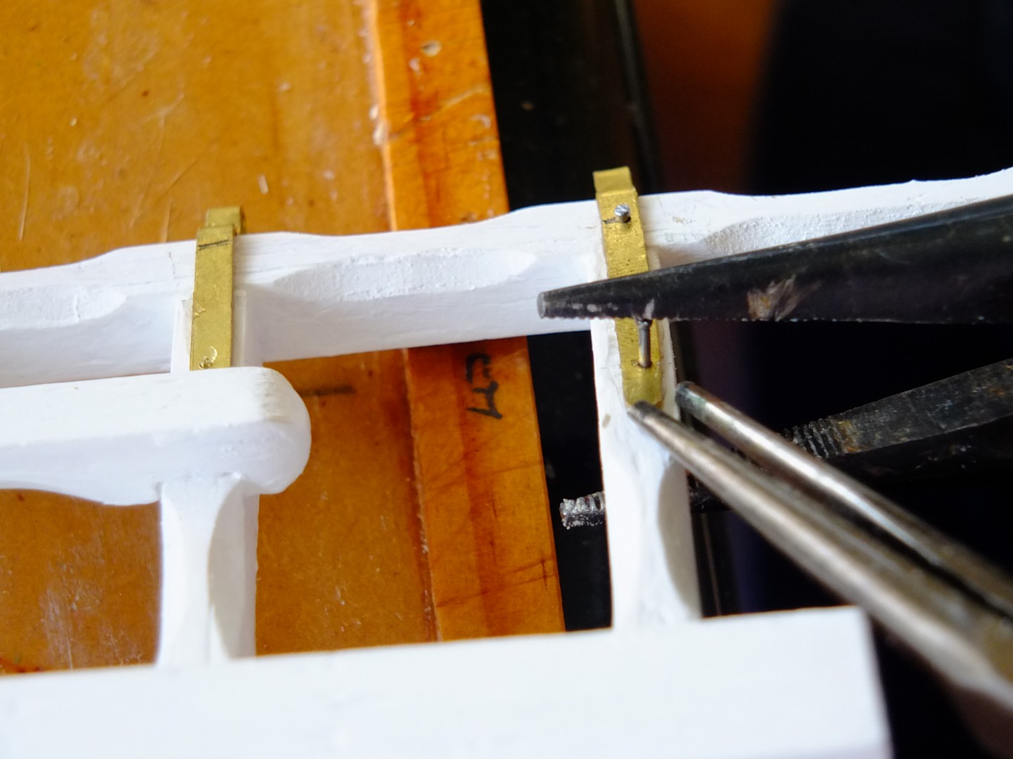

Mr D predrills a hole through the brass and timber to put a nail into to look like a bolt, then gently pushed the nail into place

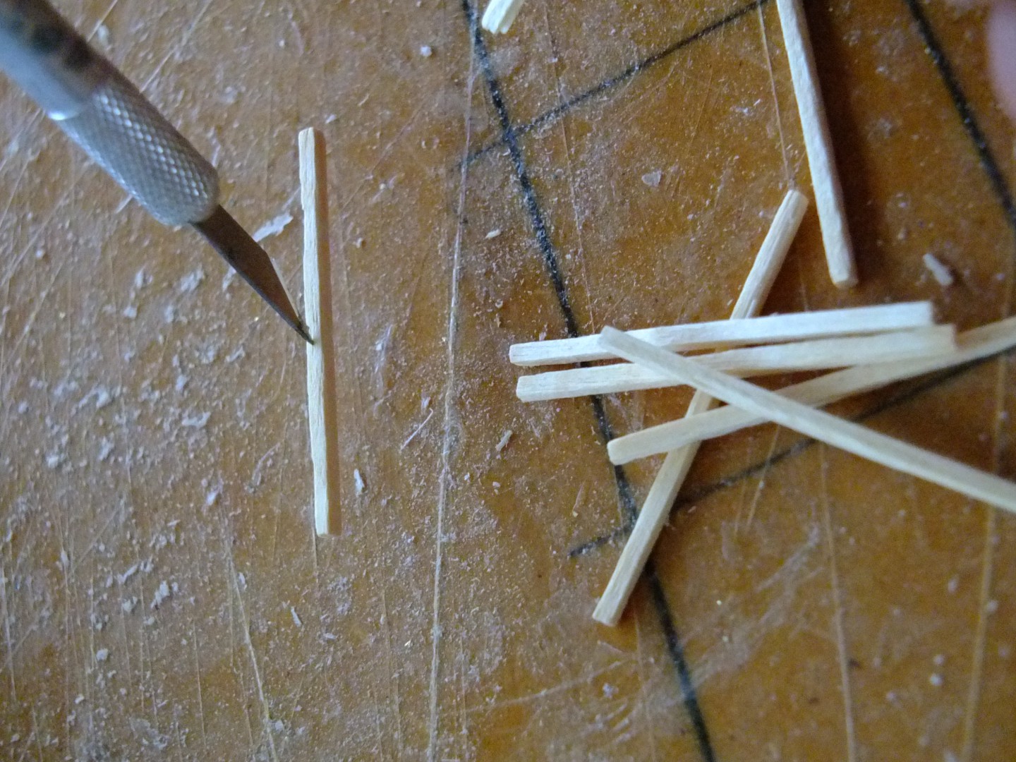

glueing sticks -together without getting fingers stuck together
and sticks stuck on my elbow ha. Ha. Ha
cheers from Paul
Here you go, another lesson...
this way you wont get glue on your fingers or elbow.
EDIT: the first picture should be the third one.

Things are regressing when it comes to painting the wheelbarrow ,
I am using acrylic four seasons timber paint, ( new can )
The result is not good , I can't get a smooth finish .
Wood filler and paint on project then sanded with 120 sandpaper , still a shocking finish
The only option might be to use enamel paint , ??? Or something else.
Will this enamel paint do any better to get a smooth finish ?
Painting every piece before glueing the job together may help ....that will take a much longer time to complete the project.
Painting has taken me more time then construction
Well that is my progress ....!

Hi Paul, hope I can help.
Don't use enamel, because it is difficult to sand between coats, its messy, and needs more prep.
I use water based paint, usually from Bunnings they have a great range of sample pots that are cheap.
After the main coats of water based first and second coats, I then highlight with different colours, this time I do use enamel, Little tins model paint from the toy shop, $3 each, I prefer Matt....
I don't use wood filler at all, because it will fall out as the timber dries in a few years.
If you are not happy with the finish, sand it back and give another coat of primer. Should not need to use undercoat when using water based paints. For finishing use 280 or 320...as 120 is way to rough for finishing.
I don't recommend painting sections then glue together. as timber glue wont hold on the paint
When painting, carry plenty of paint on your brush, but no dribbles or runs.
don't over work the paint, as you will put brush lines in it as it dries.
the paint should be wet as it goes on, and stop brushing before it loses its wetness.
Don't paint in a sunny window, as the paint will dry to quick in the sun light.

Hi Mr D
Cheers from Paul
Ps. the coloured sections of the crank cover are paddle pop sticks ( I wont use them again )
