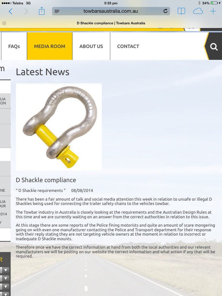

Incorrect rumour towing shackles
August 8, 2014 at 1:55 pm by Sue Rewald
Bundaberg Road Policing Unit would like to advise that no rules have changed in relation to towing shackles. Additionally no related infringements have been issued.
This is an incorrect rumour currently being circulated via social media.
For more information on towing visit the Transport and Main Roads website.

just in case you haven't seen this
http://mypolice.qld.gov.au/townsville/2014/08/08/myth-changes-requirements-shackles-used-towing-trailer/
Another source of info I came across a week ago. Not sure if it has been posted yet:
A message from Bundaberg Road Policing Unit
mypolice.qld.gov.au/bundaberg/2014/08/08/incorrect-rumour-towing-shackles/
Thanks snapper49 .... it is good to get that information posted again in this thread. Reinforces it to those who don't (or haven't) read all the posts throughout the thread.
