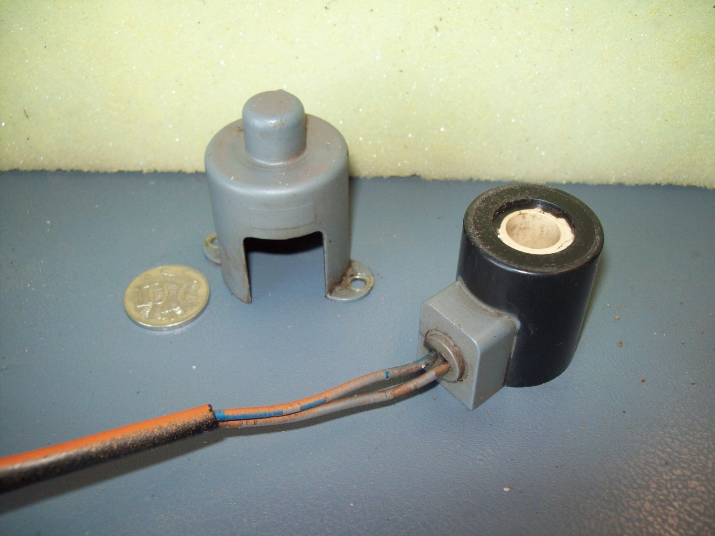

It turned out to be simple after all.
But I am still intrigued about that protusion on the other coil.
PeterQ
DeBe said
01:12 PM Jun 5, 2014
If you look at the picture of the valve block the other solenoid does the same, has to push the spool against a return spring.
oldbobsbus said
01:18 PM Jun 5, 2014
oldtrack123 wrote:
HI Bob Great news It turned out to be simple after all. But I am still intrigued about that protusion on the other coil.
PeterQ
Hi Pete, the protrusion is just where the wires come out here is a pic of the old housing that goes over it and you can see it has a cut out for the protrusion and wires..
Each coil has it's own part number but I think the only reason for that is one has a male plug on it (0685606) and the other one has a female plug on it (0685605) so they cant be connected to the wrong sender wires..
As you can all see one controls the walking speed and the other the digging and slewing functions of the machine..
Would be interesting connecting them up wrong..lol..lol..

HI Bob
Great news
PeterQ
