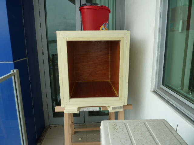

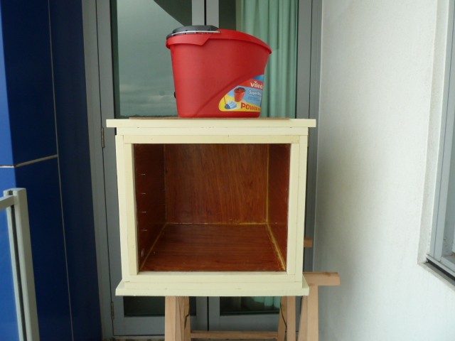

Another long day is done. The goal was to get the basic box finished with all sheets in place. Started at 6.30 and just finished. All square and all good for +/- 1 mm . Cleaning of workshop is nearly finished and all traces will be gone in the next hour.
Now the box only need a final coat of Epoxy to keep the moisture out and the inside to be done properly. The 45 degrees angles will be done later too. And the small gaps will be closed too to keep the crawly crunchers out of the box.
It's impressive how much Epoxy I was using with all the thin seperate sheets. Had 3 Litres and about 0.5 Litres are left. Hope, this will be enough to finish this job but to be honest..... I don't think so.

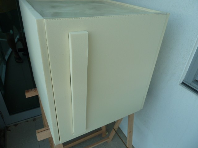

Time to go further a bit. Every day one side of the insulation will be coated with epoxy. Hope, that the epoxy I have left will last for this part of the job. Doesn't look like. Not exiting enough to make pics.
Regards, Berni
BTSV_Berni said
08:20 PM Nov 24, 2013

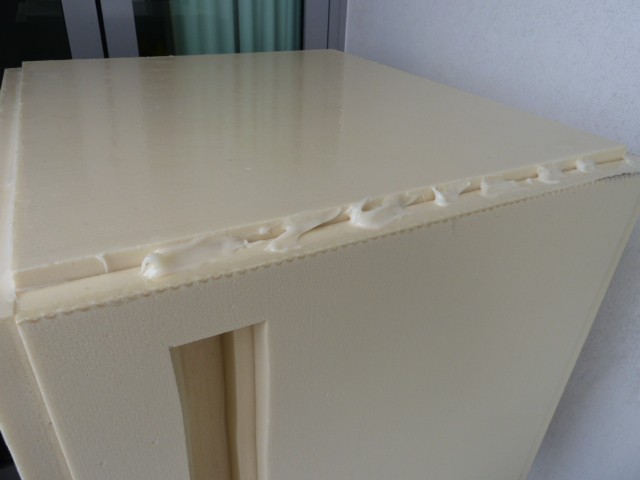

You are right. . A post without pics is next to useless. . So I coated this side (bottom) and closed the gaps with epoxy glue. A plastic spoon was very helpful to make a smooth finish. Not that I'll ever see that again in the finished fridge but it helps me to improve my skills so that later on the visible work will look good.
Just finished the third side. Today it's bonding very quick. With a bit of luck I'll get the fourth side done. The side with the hole for the pipework needed a bit rework. Don't want to bend the pipework to harsch so I was sanding a bit to make sure that it will bend smooth and soft. Easy quick done. Then coated and ready to go.

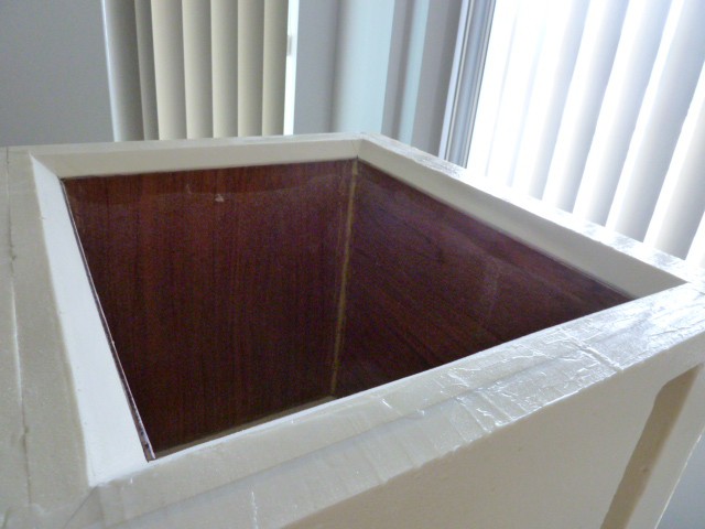

Overtime night shift cancelled due to funny circumstances. Yeeeehaaa.
So I took the chance and went to boatcraft directy after I clocked off, had a 2 hr nap in front of the gate, and then re-stocked my gear.

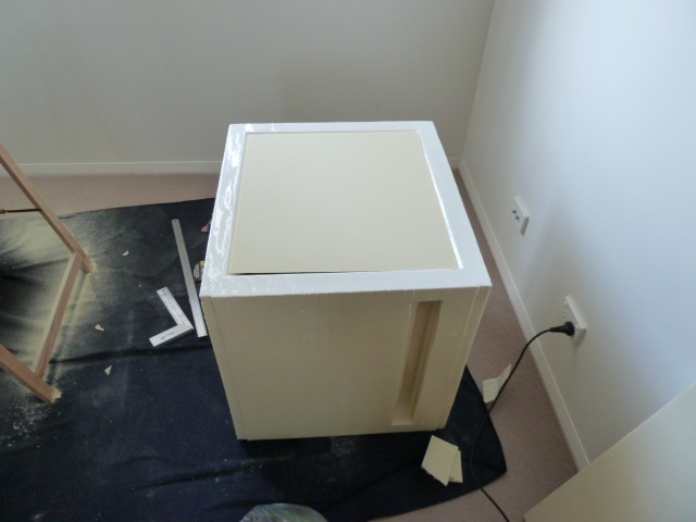

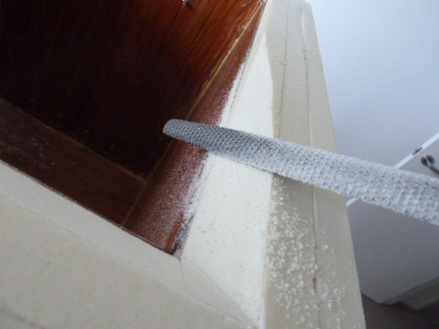

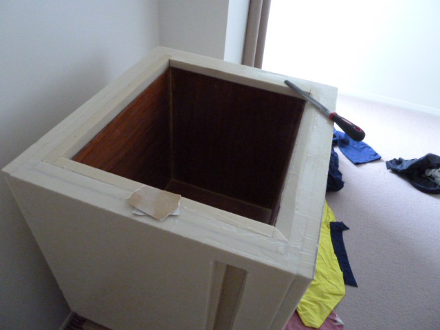

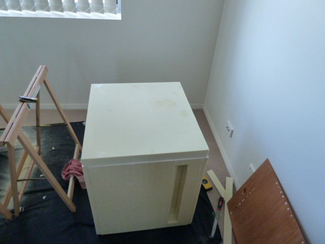

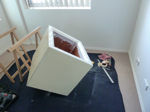

Back home it was time to make up the 45 degrees angle and the pictures will show you what I was talking about and give you an idea how it will work later on. So sanding and rasping was the main topic. I'm pretty happy with the outcome. Would have been perfect if I would have been able to cut the angle before but my limited equipment didn't allow me to do it.
Used the brush to wipe off the dust regularly to make sure that I stay with my rasp / 240 sanding paper where I want to be. After all the vacuum cleaner did the final job.
At the end I gave it a coat with Epoxy mixed with TPRDA and as you can see, a lot of uneven is gone. Will be very good with the following coats.
For tomorrow the plan is to sand the internal part, make everything smooth and paint the whole thing over the next week. Afternoon shift is perfect for that. It prevents me from rushing through this job.
The whole session of making it white is very time consuming and rushing only makes it bad. So I have to take the time to do it right.The first bits with white pigmented epoxy are done and I made a few new experiences. At the beginning it was a disaster and I thought that this will never come up good but after changing a few techniques it is looking better.
The white epoxy is unforgiving. You see every little stuffup. Thin layers are the solution. Started with thick ones at the beginning and it was impossible to keep the runners under control. And for now I think that it is the best idea to start with the top section and not somewhere as I did. Level the 45 degrees angle is essential. No way to get an even coat if it stands upright.
And further it goes. I'm happy so far with the top section and the angles. Final sanding and thin layer shoud do. Before I go for that I decided to do the side corners first to give it a smooth look and then do the inner top section.

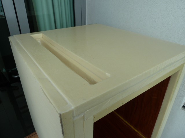

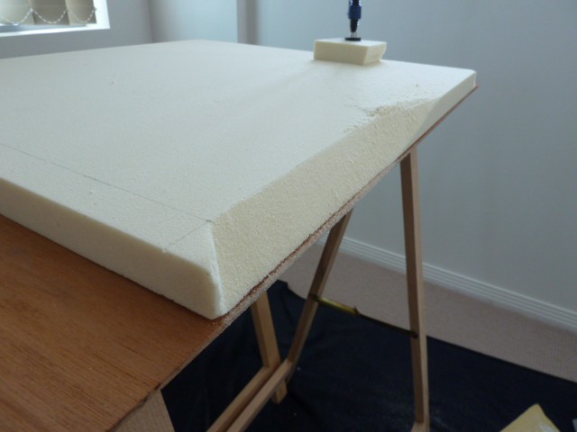

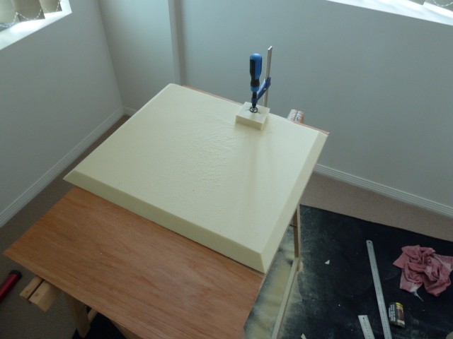

Top lid started. Due to storage reasons the sheets were bent like bananas. Had to work with dirty tricks again to keep them straight while the epoxy glue in between is curing.
Today it was time to get started with the middle part of the top lid. Pictures show you what I've done. This thing turned up as a pan cake too as you can see (the gap) so I had to go and use dirty tricks again. The idea is, to keep it flat and even with the water bottles and making up an epoxy matrix to keep it that way after the bottles are removed. Hope I can apply the second "matrix" layer today but the humidity is on 250thousandmillion percent and it takes ages for the epoxy to cure. I'll see......
As you can see on the pictures the gap is gone. Waterbottle technology was doing the job again. Just prepeared it for marriage, which should happen in the afternoon.

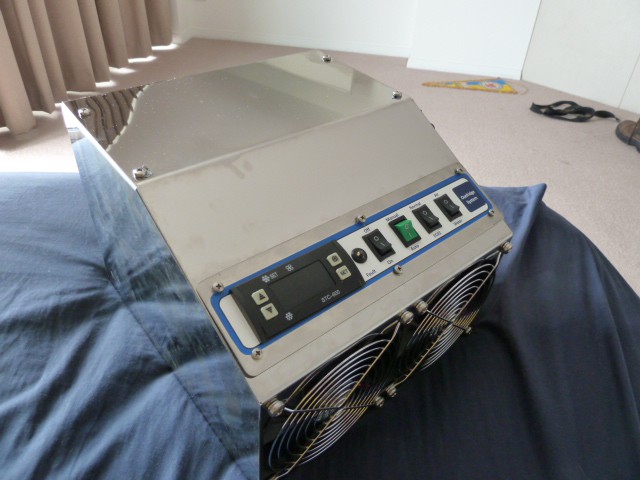

To make sure that I don't become bored I had a quick look at the compressor unit to find out if the cables are long enough to put the controller where I want it to be. They are not...... , which was not really surprising me because it might be a challenge to put an extra metre cable into to this little thing. Not much space inside. And why should they do it anyway ?
So the next 1-2 weeks I'll make up a maintenance friendly solution with plugs and sockets from Hirschmann http://search.jaycar.com.au/search?w=Hir...&view=list . This is very reliable stuff and used in the industry without any dramas. A job without the "joys of epoxy" yeeehaaaa .

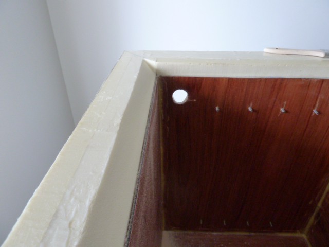

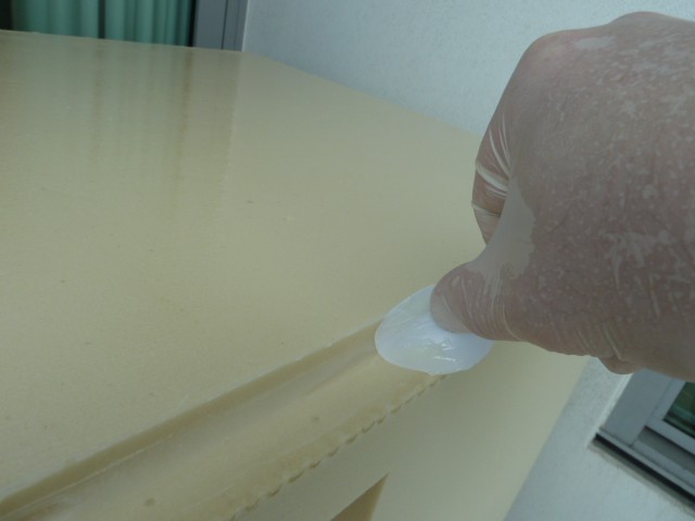

Regards, Berni
You are right.

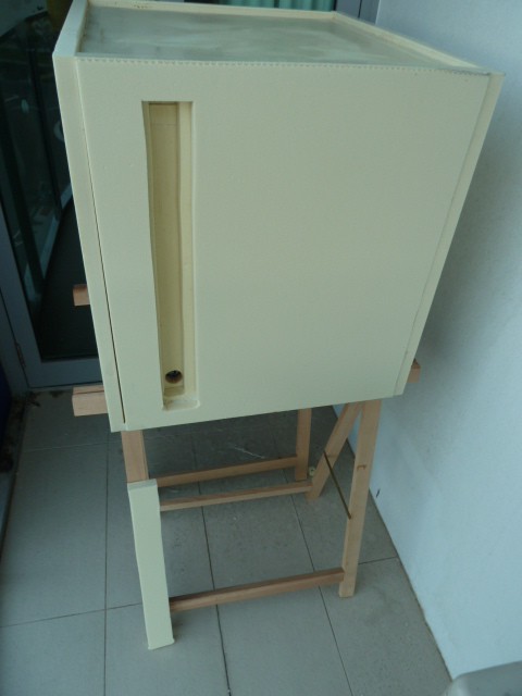

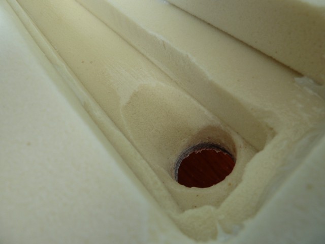

Regards, Berni

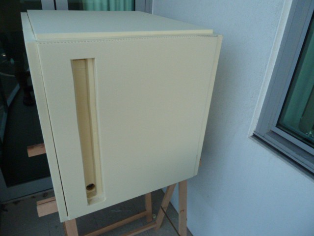

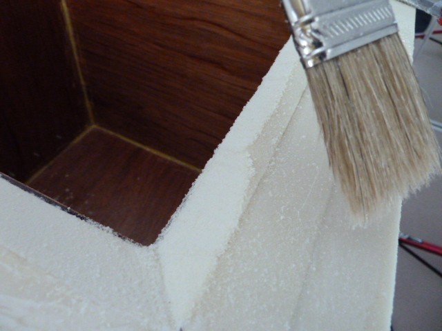

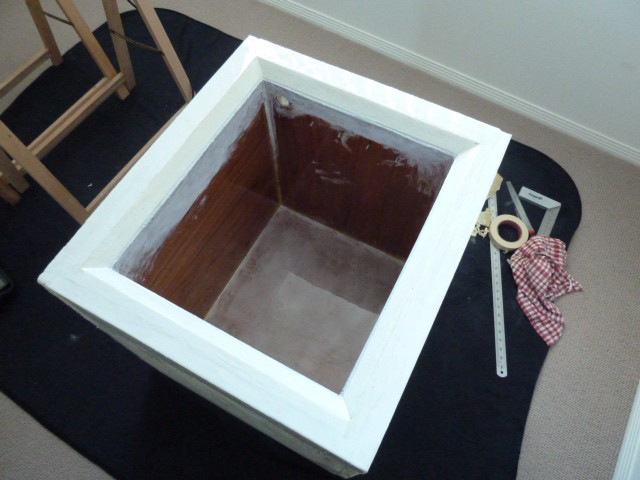

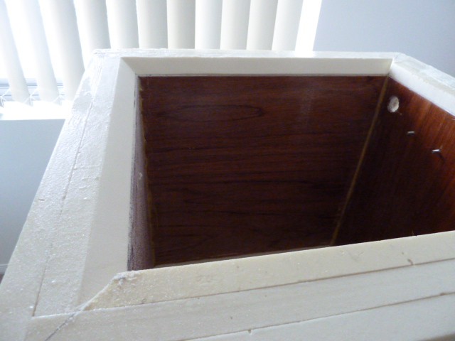

Kind regards, Bernie

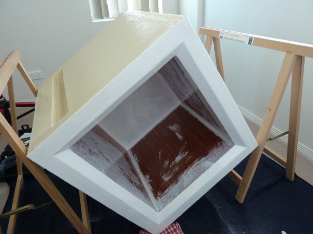

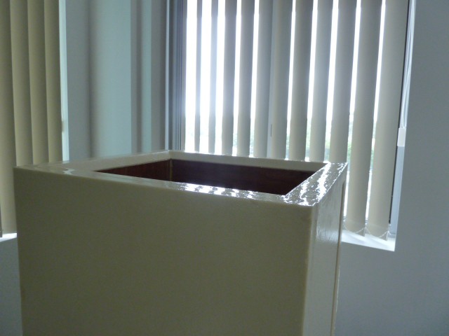

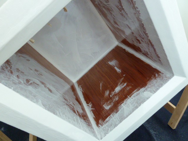

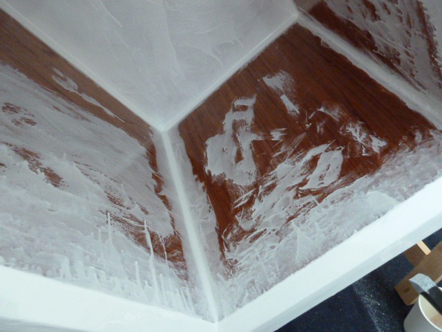

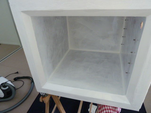

as I did.
Regards, Berni

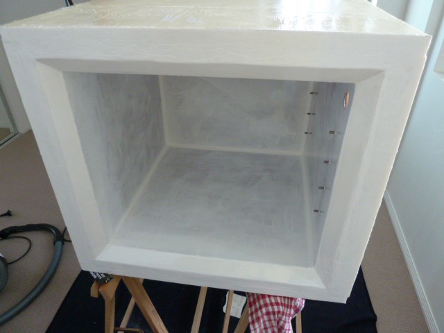

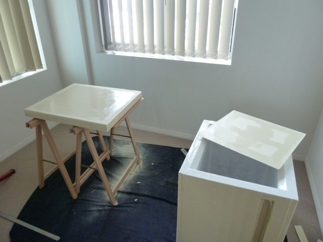

Looks a bit like graffity done by someone completely outminded.
Regards, Bernie

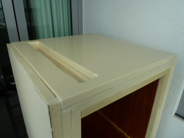

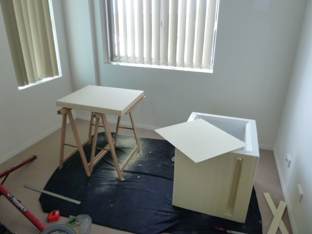

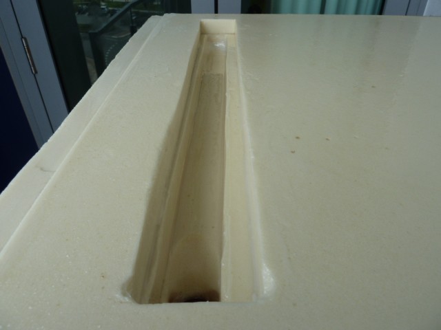

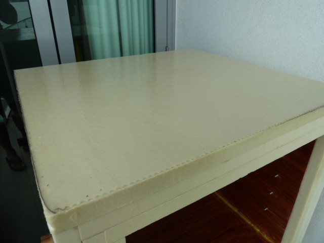

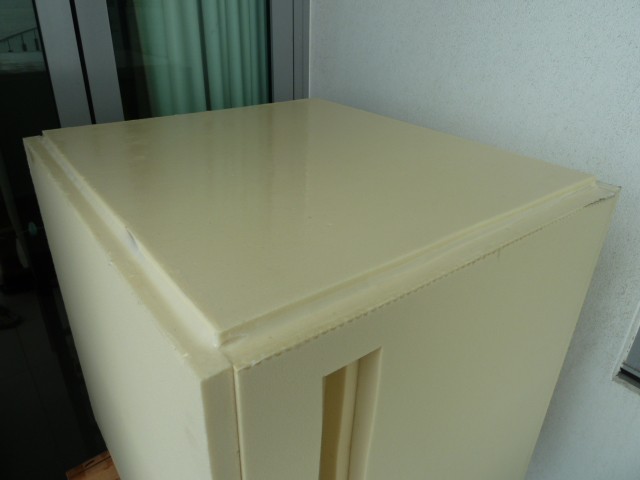

Regards, Berni

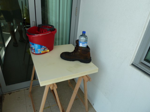

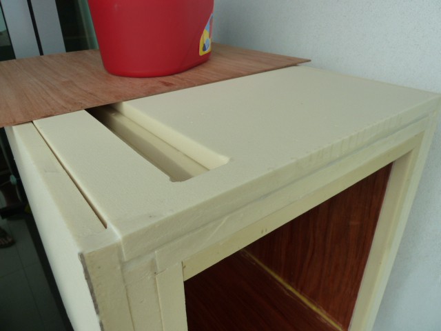

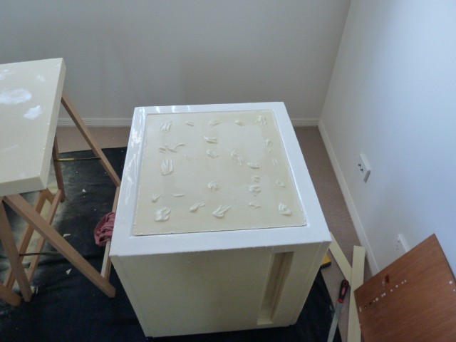

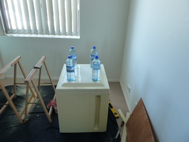

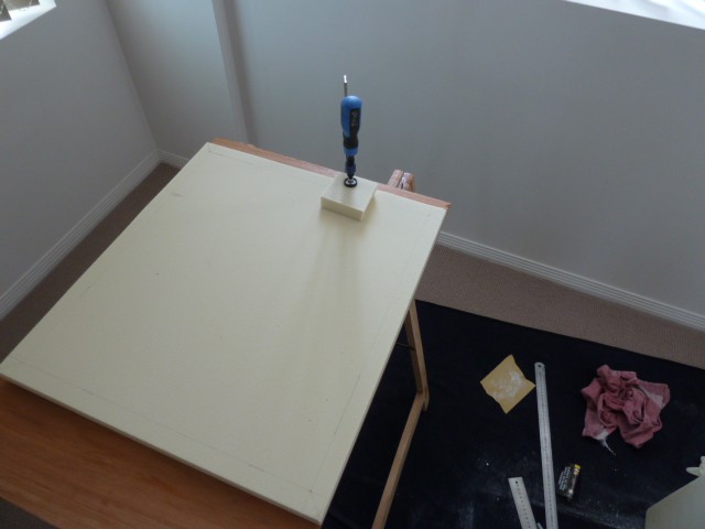

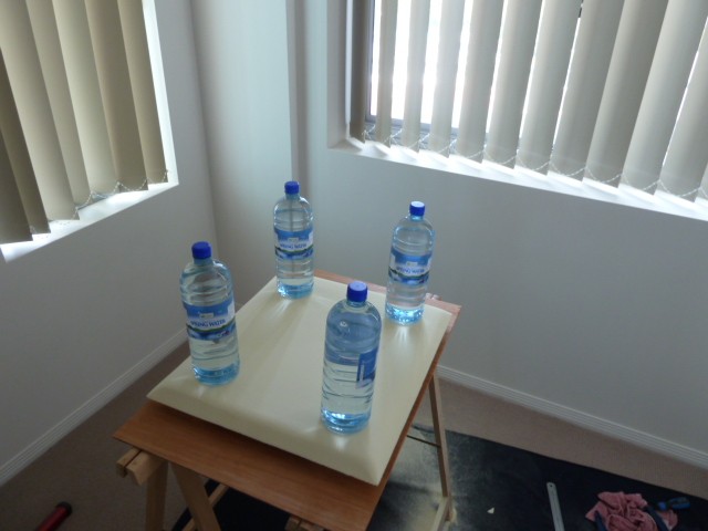

I'll see......
Regards, Berni

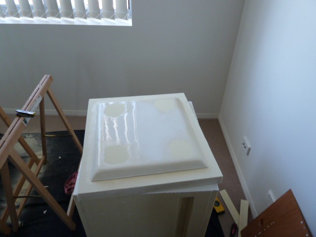

Regards, Berni

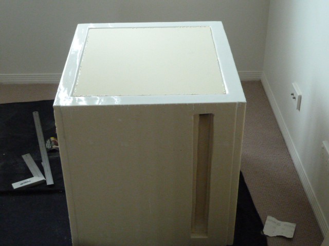

Forgot the last update picture.
Top lid needs a final coat on top and the sides need to be done.
But it is looking pretty good.
Ran out of epoxy. Time for a longer break. Will spend the time to think about the outer housing to make it look like fridge/furniture.
Keep you updated.
Regards, Berni

Naaa, I will not rewire the control panel. All I'll do is add some plugs/sockets and extend the cable.
Have done stuff like that 25thousandmillion times and it always came up very good.
Will not touch the control panel. You will see it on the pictures later.
Regards, Berni
