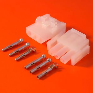

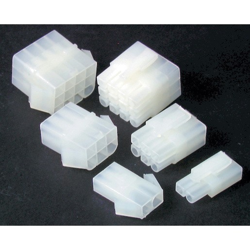

Tonight I tried to remove the female connectors inside the plug but was unable to do so because they have little flared "fingers" inside the plug to prevent them from coming out.
Dumb question but how are these terminals removed from the plug? Doing some research suggests I need a "weatherpack" terminal removal tool. Am I on the right track here?

Hi, Lawrance! Here's scenario 1. They swapped pins 5 & 6, and IF the EBL109does work if they are both +12vdc simultaneously, the full charge current of around 12 amps would attempt to flow through the purple wire (if connected to a +12v source) and blow the 2 amp fuse (if fitted). Scenario 2. The purple 'trigger' wire is left unconnected around the drawbar somewhere, waiting for the appropriate connection to an 'ignition' wire in the car socket - this scenario more likely if there is no fuse fitted. Either way, if you elect to do what I did and use a time delay relay - here is the identical one that I bought, but I got mine (the last one he had) from a seller in Maryborough (not Hong Kong):
but this one is half what I paid! I know that Jaycar have a sophisticated and suitable one but costs (I think) around $30 - $40. Any will do as long as it will run on 12v, switch 5 amps and give a delay of 10 seconds or more it should be fine.
Now for your AMP plug issues. To remove those contacts you do need a special removal tool. I used to have one but heaven knows where it went! I was lucky that the great people in the U.K. were happy to ship me some new contacts and a new male plug for the solar connection so I didn't need the removal tool. There is a plethora of different types of those nylon plugs. Jaycar sell one that is close to the solar plug, but didn't fit. In your situation I would consider cutting both wires, leaving about 30mm sticking out of the plug and re-soldering them. A little bit bodgey, but if you really know your way around a soldering iron (so you know how not to melt the plug in the process) and cover the joints with heatshrink tube, it should be OK electrically. Alternatively, you either go to an auto electrician and pay him to swap the wires (best option - he should have a tool and be able to easily swap the contacts) or source the bits & tools you need to do the job properly.
Over to you - I hope this helps. Yell if you need more!

I'm guessing that when the end of the tool is pushed into the plug's terminals, it will squeeze the little tangs sufficiently back so that it can be pulled out of the plug. I've never done this before but am guessing this is how professionals do it, after researching Mate N Lock connectors.
When it arrives, I hope it would be a simple matter of swapping the position of the thick red cable with the thin purple cable, and then finding out where the other end of the purple cable goes. If the tool doesn't work, then its probably time to contact a sparkie.

After a three week hiatus, the eBay purchased tool has finally arrived. I was very happy with it because I was able to very easily pull out the heavy gauge red wire and put it in the right place.
However the now released purple wire (which kind of looks blue in the picture) is not a positive switched wire. It turns out to be a negative wire which is somehow wired to the trailer tow plug.
So I can't use this purple wire as the "trigger" wire to turn on the DC-to-DC charging function of the Elektroblock.

Just a quick update - for the plastic connectors, I was able to purchase them from A'Van directly, through their spare parts department. The solar plug was about $4 and the connectors for Block 3 & 4 are also available, at a slightly higher price. For PINs, I just go to Jaycar and purchase the pins that are part of a kit for computer power supply plugs, but A'van does also sell them.
Stratman77 said
02:55 PM Mar 17, 2015
Hi, Lawrance!
Thanks for the update! I knew about the pins from Jaycar, but I would never have thought to ask Avan about the nylon plug! Great work.
03_Troopy said
08:21 AM Mar 18, 2015
Just a note on the connector contacts, the contacts in the Electroblok plugs are slightly different to the Molex connector contacts, which are slightly shorter. There are other connectors at Jaycar that have very similar pins to the Mate-n-Lok contacts in the Electroblok and seem to be a better match if you can't get the original AMP Mate-n-Lok contacts. The 12 way connector in the style I'm referring to is part numbered PP2026 in Jayco's catalogue and cost about $7. The connector body isn't any use to you, just use the contacts.
Mate-N-Lok Connector
Jaycar Connector
