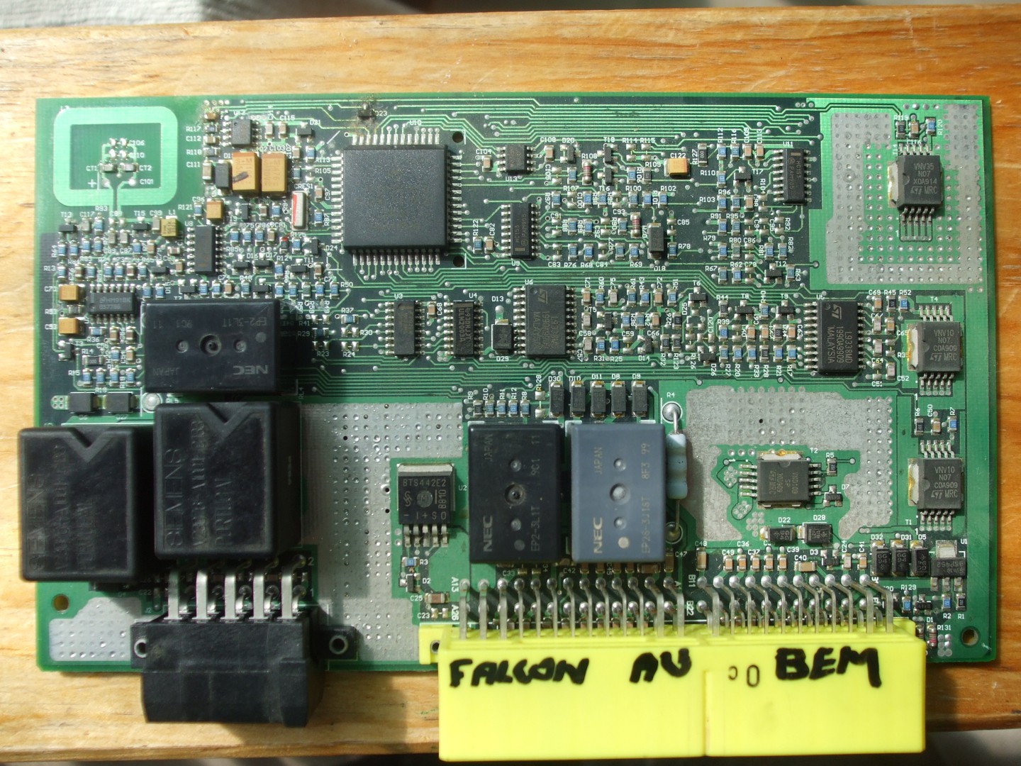

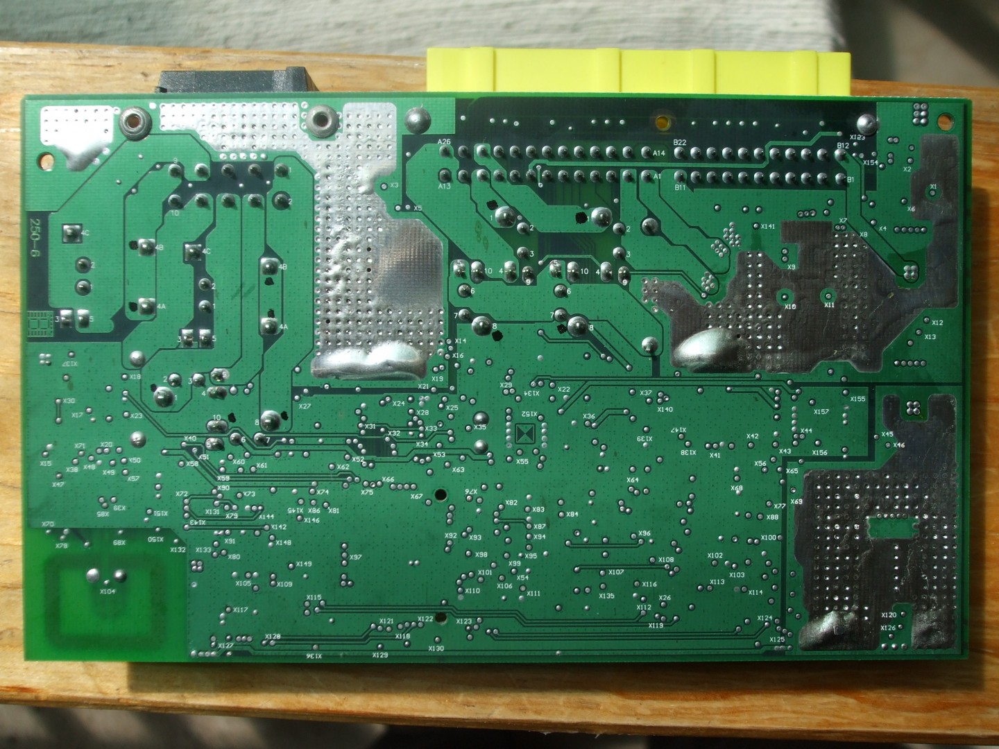

Well yes Mark, taping a unit can temporarily fix a item if a dry joint is involved. Pictures of an AU ford falcon BEM module. Fault is usualy wont crank, hit dashboard near left knee in drivers position. Car now cranks, fault is dry solder joints on relay on the circuit board. Just resolder & its fixed. Have repaired many ED/EL/EF/AU Falcon Body Electronics Modules. In the picture the dry joints on the relay pins are there to see, marked with a black texta dot. Dry solder joints are quite common in electronics.
