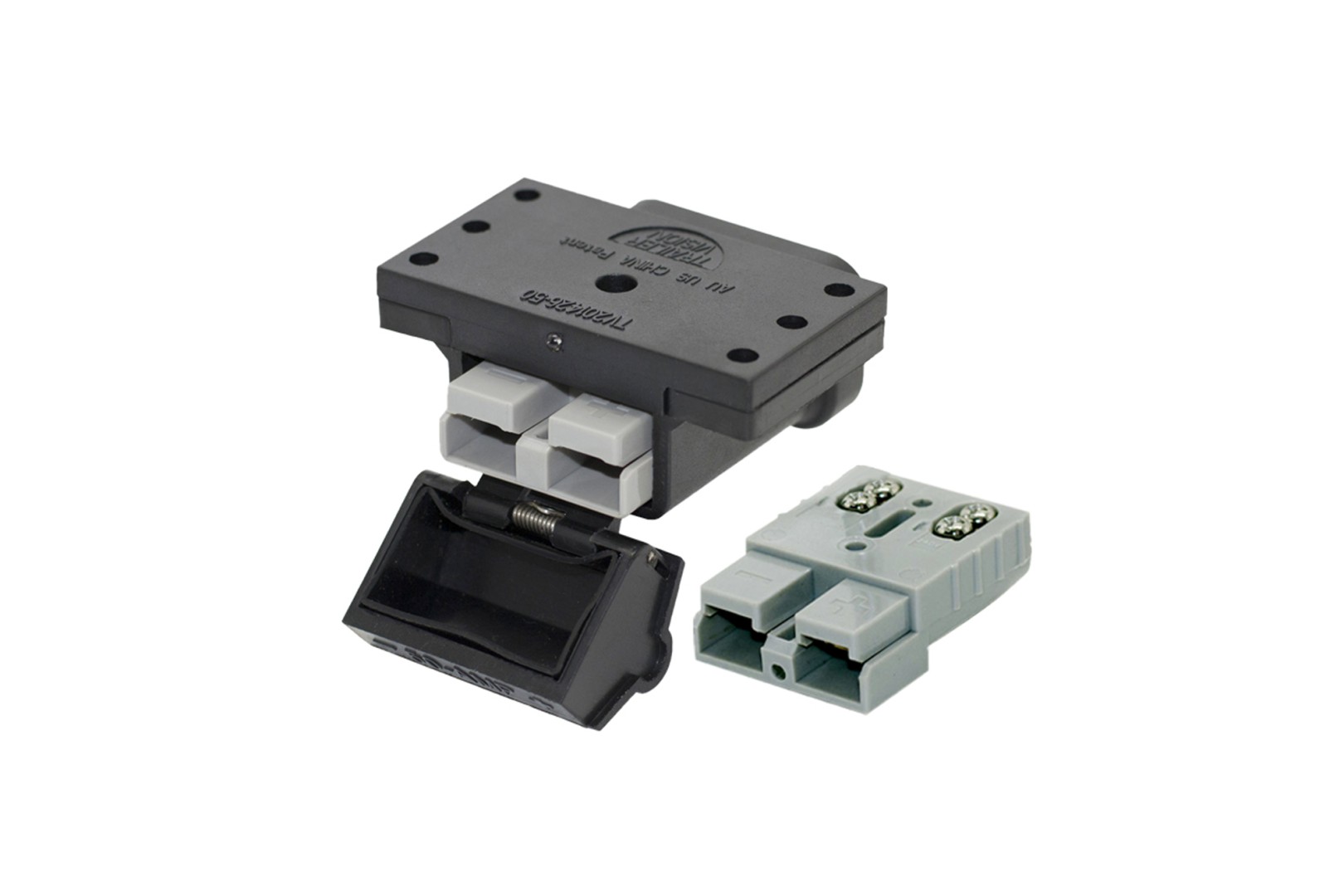

Agree with you on both counts Mike, and would add a third drawback being the lack of even basic weather protection.
However, a good solution to those issues is to mount the Anderson in a purpose built housing, like the excellent range of housings that Trailer Vision make Trailer Vision Anderson Housings

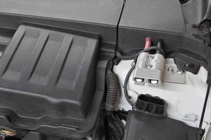

I have 175amp Anderson plugs on starter & auxiliary batteries, & jumper leads. Gives me lots of options.
Next to starter battery:
