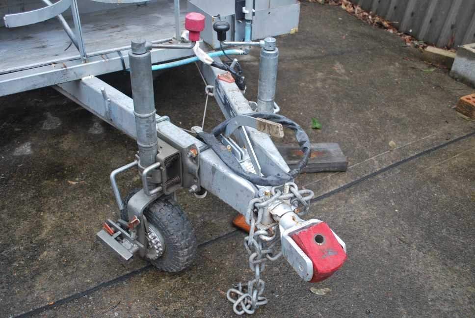

It appears from your original post the major problem was not being able to fit the jockey wheel. A simple solution to this problem, is to get an old jockey wheel & cut the wheel assembly off the the bottom & weld a plate about 100mm dia in its place. This will give you 150mm extra clearance under the tube assembly. I camp off road a lot with a 4b' & van. I carry a modified jockey wheel for the situation where a can't fit a jockey wheel.

One can buy these already made up from a caravan/trailer/towbar place. I have one in addition to my normal jockey wheel and find it very handy. I have two attachment brackets on the drawbar so changing over from one to the other is simple.

Can you give me a link or a picture please Jim. I can't picture what that is.
Jim, I wasn't aware one could buy them already made up. They are handy when camped on slooping ground. Sometimes you can't get the drawbar low enough, with a jockey wheel, to level the van. I think it would also solve Beths problem.
It also comes with a couple of brackets to weld on the van chassis behind the wheels and a clamp to attach to the leg to engauge with the brackets. You use these for wheel changing, a bit like the Trail-A-Mate, only cheaper and lighter, It's made for the smaller vans. The picture shows it lifting the side of a van.

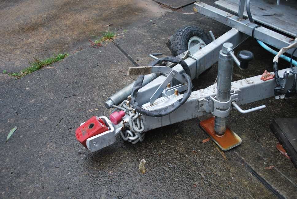

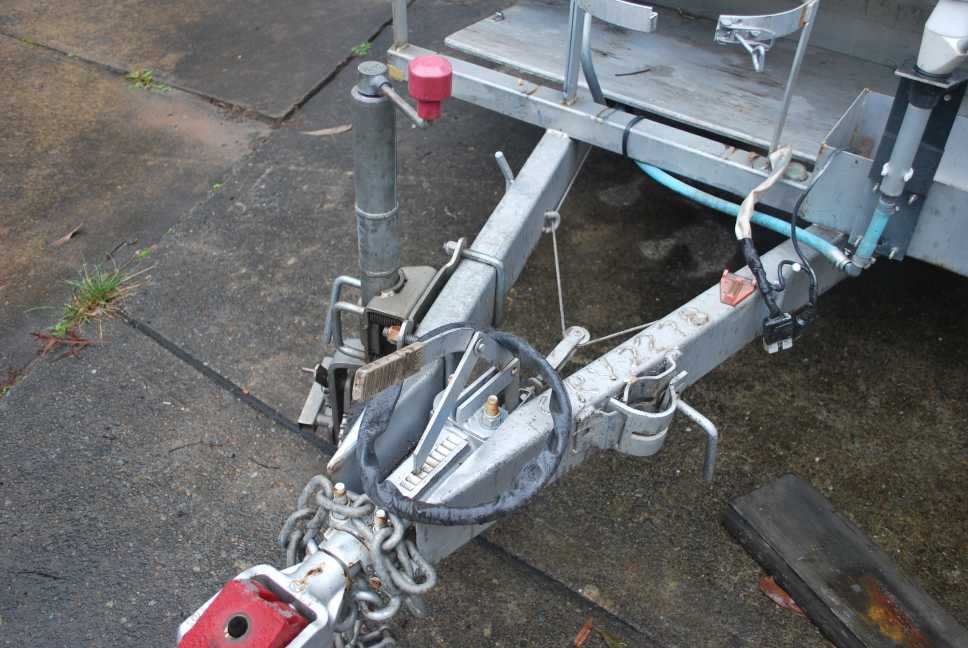

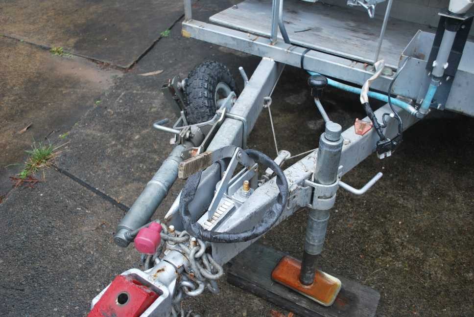

http://www.mycaravanparts.com.au/products/chassis-components/jockey-wheels/14-adjustable-stand-with-flat-base.aspx
Thanks for the quick reply wasn_me. I'm sure that'll help with that part of the problem anyway.
Or there is this one http://caravansplus.com.au/catalog/product_info.php?products_id=6968 - It gives you the choice of a plate or wheel at the bottom.
Here is another one too Beth ... available on this website -
http://www.caravanshop.com.au/?Nav=Pdt&category_id=33&sub_category_id=89
Okay, I see how it works. I'm assuming I'll need to measure the height of the current one before deciding.

Here they are
