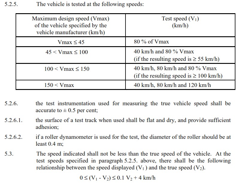

I think you will find that the tendency for speedos to read slightly high is a carry over from European traditions in an attempt to reduce speeding fines. This is borne out by the fact that it is only the speedo that is incorrect, the odometer and other information that is gathered from the same sensor is generally very accurate. Also be aware that a gps speed reading is only accurate when consecutive readings are taken with the vehicle travelling in a straight line. Any gps speed readings shown on a winding road or on a curve will be lower than your actual speed, the degree of difference will depend on the update rate of the gps processor and the frequency of the changes of direction of the vehicle.
10:27 PM Jan 2, 2014
There was a change in the accuracy requirements for speedometers early this century. I'm not sure of the exact date. The accuracy was expressed in +/- figures and the speedo had to be fairly accurate.
The new conditions were introduced as speeding fines were being successfully being challenged on the basis that their speedo reading was low and they were not aware of the fact. The current situation is that vehicle manufacturers are not allowed to produce vehicles with low reading instruments. To ensure that they don't speedos now read higher than they did under the old regulations. The JPG below is a copy from Vehicle Standard (Australian Design Rule 18/03 Instrumentation) 2006.
