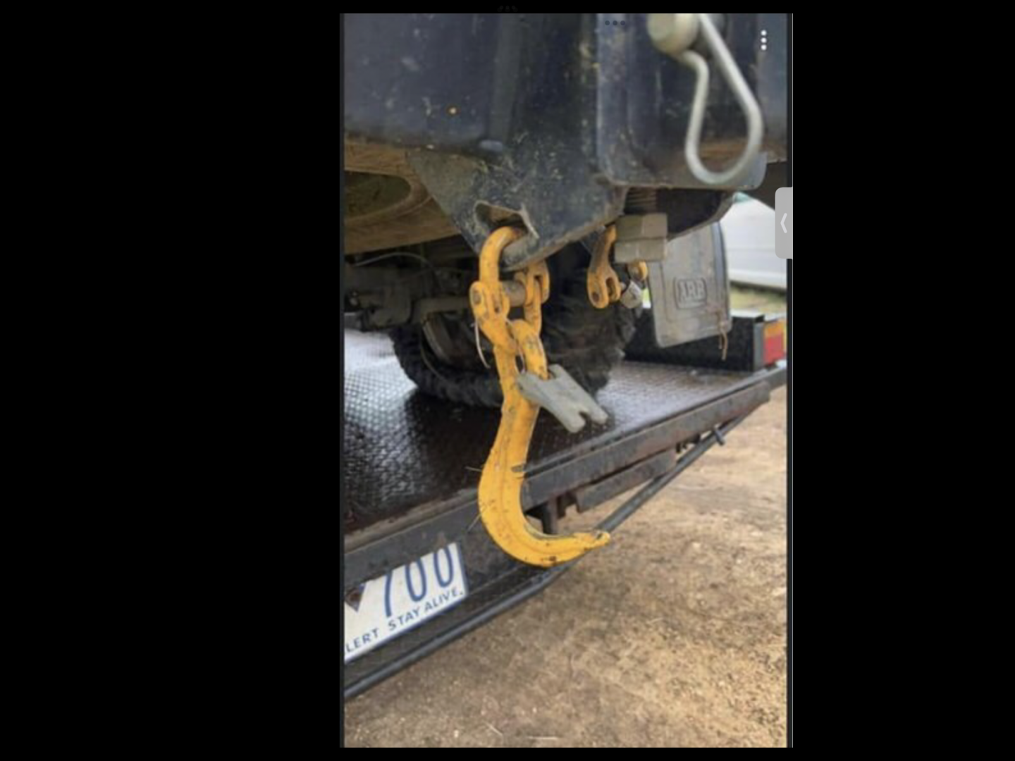

A typical 10mm "Clevis Hook" has approximately a 5 tonne safety rating which would mean somewhere between 15 tonne and 20 tonne breaking strain.
The pictured hook would not have been distorted by a caravan breakaway - more likely pulling stumps or similar abuse.
It of course could be an Aluminium Clevis Hook (unrated) painted to deceive.
The "Hammerlock" fittings shown are totally legal chain attachments (in Australia).

One of the suppliers of the Clevis hooks said to me they would not use them on a towing situation as the spring retainer clip could not be guaranteed to stay shut when in motion, thus allowing chain to bounce off.

I wonder if the fact that the tug is on the back of a trailer has any bearing on what happened to the hooks?
Murray
EJP said
11:23 AM Apr 9, 2023
A few things come to note here.
1. The vehicle is on a trailer
2. The hook on the other side is missing
3. The bottom section of the hammerlock is missing and the pin appears to be broken.
There is a lot more to this than meets the eye.

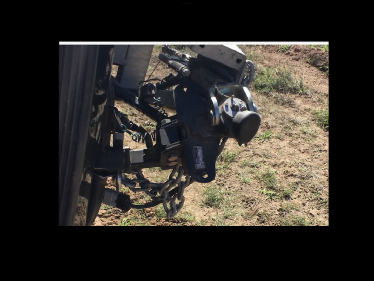

yobarr said
04:04 PM Apr 11, 2023
Edit: An observation of how securely the modern coupling locks down during accidents the coupling stays on the tow ball through jack knifing and rolling, generally taking the tow vehicle with it!
Perhaps the next step would be to have pintle hooks that lock securely, meaning that safety chains would no longer be required.
We tow a 12 ton PIG trailer with pintle-hook equipped 10 ton tipper, and safety chains MUST be used. Cheers

Not sure what I'm looking at in the photo you posted. It looks like it is on it's side, thought it was the tow vehicle but safety chains would be on the trailer. Anyway, whatever it looks mangled!
Murray
yobarr said
04:56 PM Apr 11, 2023
Long Weekend wrote:
Thanks Yobar. I'm in error.
Murray
Hi Murray. It is indeed a caravan on its side, but you'll note that the DO35 has pivoted, allowing the car to stay on its wheels. Cheers

In my travels I have noticed an increase in the numbers of caravan with hooks being used in safety chains.
This fella seems to have bent one and lost the other.
Assuming the car was towing a van I wonder what happened to it? Cheers

DO35 sorts that!
Murray
Murray
